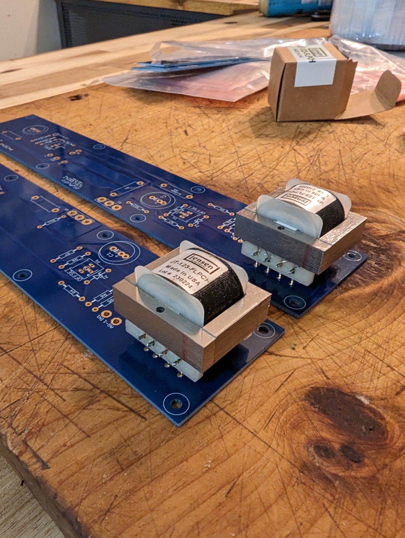

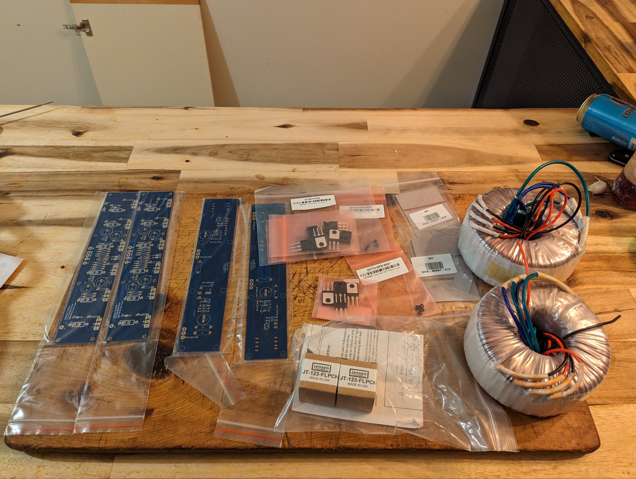

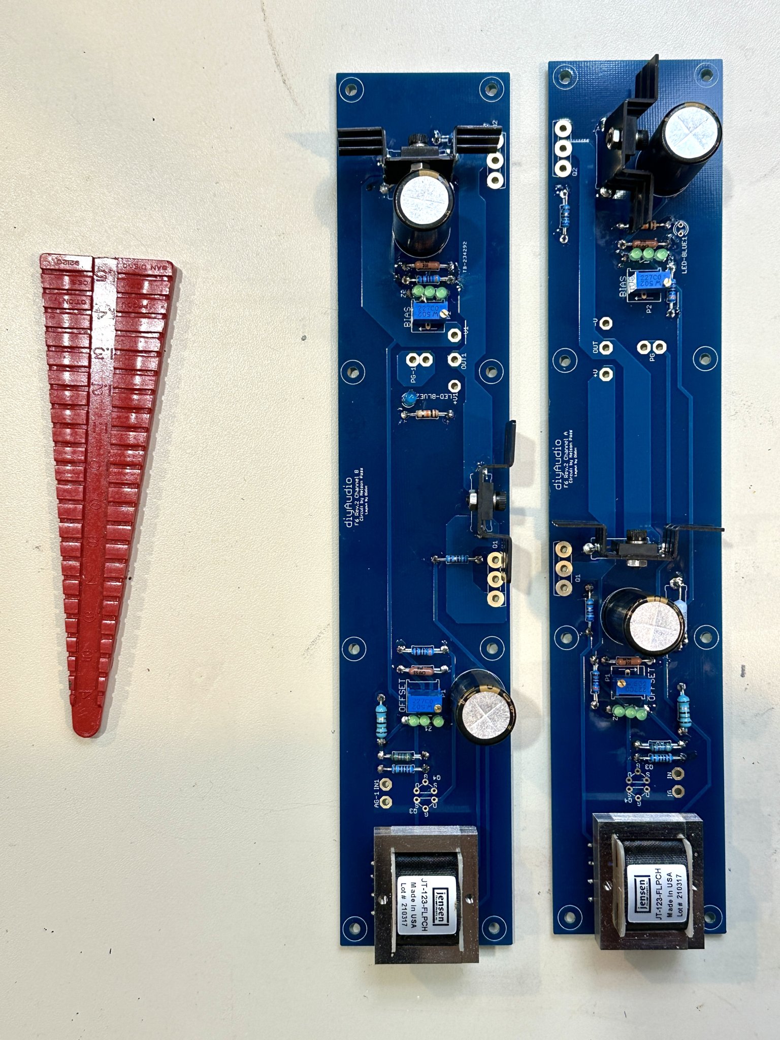

Yes, I have a tube of 24 sitting on my bench. Those and a pair of bare F6 PCBs plus other parts are waiting to be assembled. The Jensen transformers are going to be re-purposed from a pair of Bulwark input stages, a fun experiment that has run its course.
I recently readjusted the bias current in the F6 (FQH44N10 version) to 1.95 Amps per device. It’s running a bit hotter than before, on the edge of wanting to remove my hands from the heatsinks after 10 seconds. Sounds great with the big Vandersteens. Gives a little more of everything vs the M2x. Which is also how the 3As compare to the 2Cs. The F6 really has a tighter grip on the bass.
The new IXTQ75N10P version will take a couple days to build. I plan to make a couple small changes to accommodate the different Mosfets.

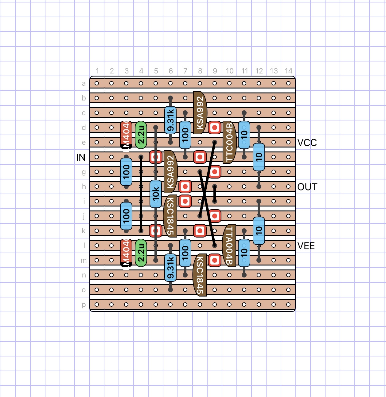

I know you have posted a schematic of your diamond buffer setup in the past. I tried digging it up to no avail. Do you still have it handy?Work in progress..
I need to build a new pair of Diamond Buffer boards for the input. I like that one for driving the big Mosfets through the signal transformer.
I will probably stay with unity gain buffers. The other one that I might try is the high voltage, high current OPA551 opamp. And the OPA445. Both of those worked well in my DIY VFET lottery amp via the Marauder front end.
These could probably be applied to the F6 with a simple scheme like the M2x Tucson input stage.
The Diamond buffer that I am using could be adjusted to run on even higher voltage rails. The 10k resistor in the middle of the vero board will be increased to 15k when I finish the build. The TTA004B / TTC004B parts are better suited to higher voltage operation than the M2x Austin.
