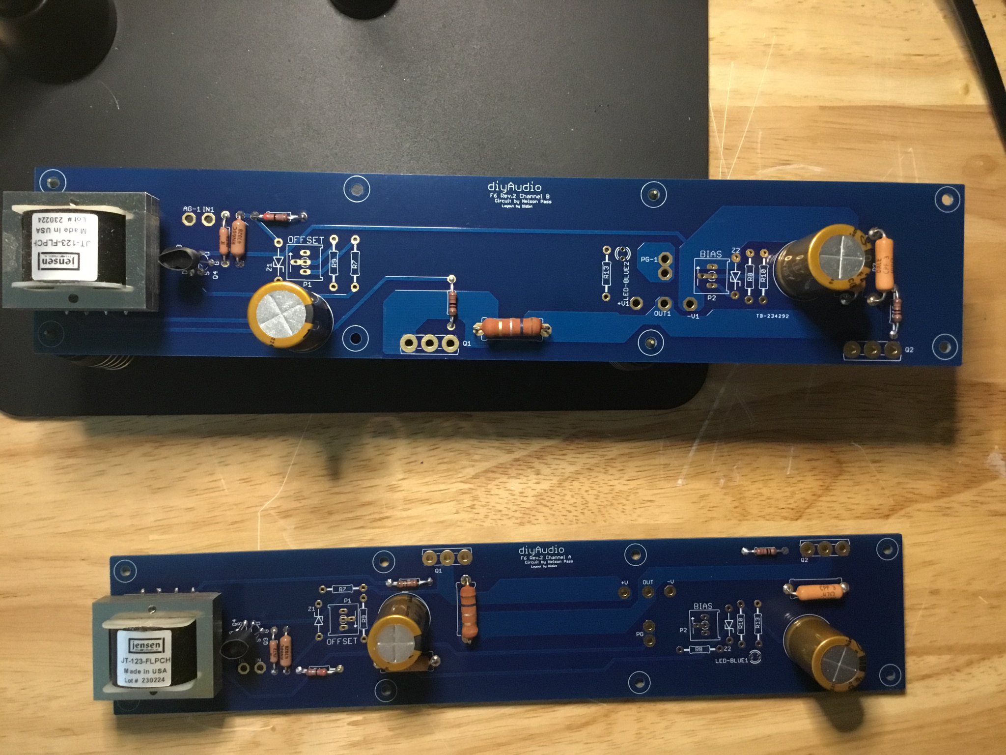

Why? I don't know. Likely just an error.Why is R1 marked on the A board and not on the B board, and R2 is marked on the B board but not the A board?
Where do you see something labeled "-IN" either on the schematic or on the PCB?New to F6 and enjoying the amp and I have a question. Does -IN need to be connected to ground like Aleph?

AG- negative on board. Obviously there isn't -IN on the schematic. So not the same as Aleph then?Where do you see something labeled "-IN" either on the schematic or on the PCB?
Correct. Not the same.AG- negative on board. Obviously there isn't -IN on the schematic. So not the same as Aleph then?
"IN-" on the Aleph J (and most anything else noting a differential signal) indicates the input for the inverted signal or negative signal vs. the "IN+" for the normal / positive signal.
For single-ended operation with the Aleph J, you short the connection for the inverted phase signal to ground in order for the circuit to operate properly. For people that know they'll never use a differential input, sometimes they do it permanently on the amp PCB. For those that equip their AJ with both XLR inputs for a differential signal and RCAs for SE, they may short pin 1 to Pin 3 of their XLR using a temporary jumper wire / shorting plug when they use the RCA inputs.
Since the F6 is single-ended only; that's why you don't see any notes for an IN- on the schematic or on the boards.
