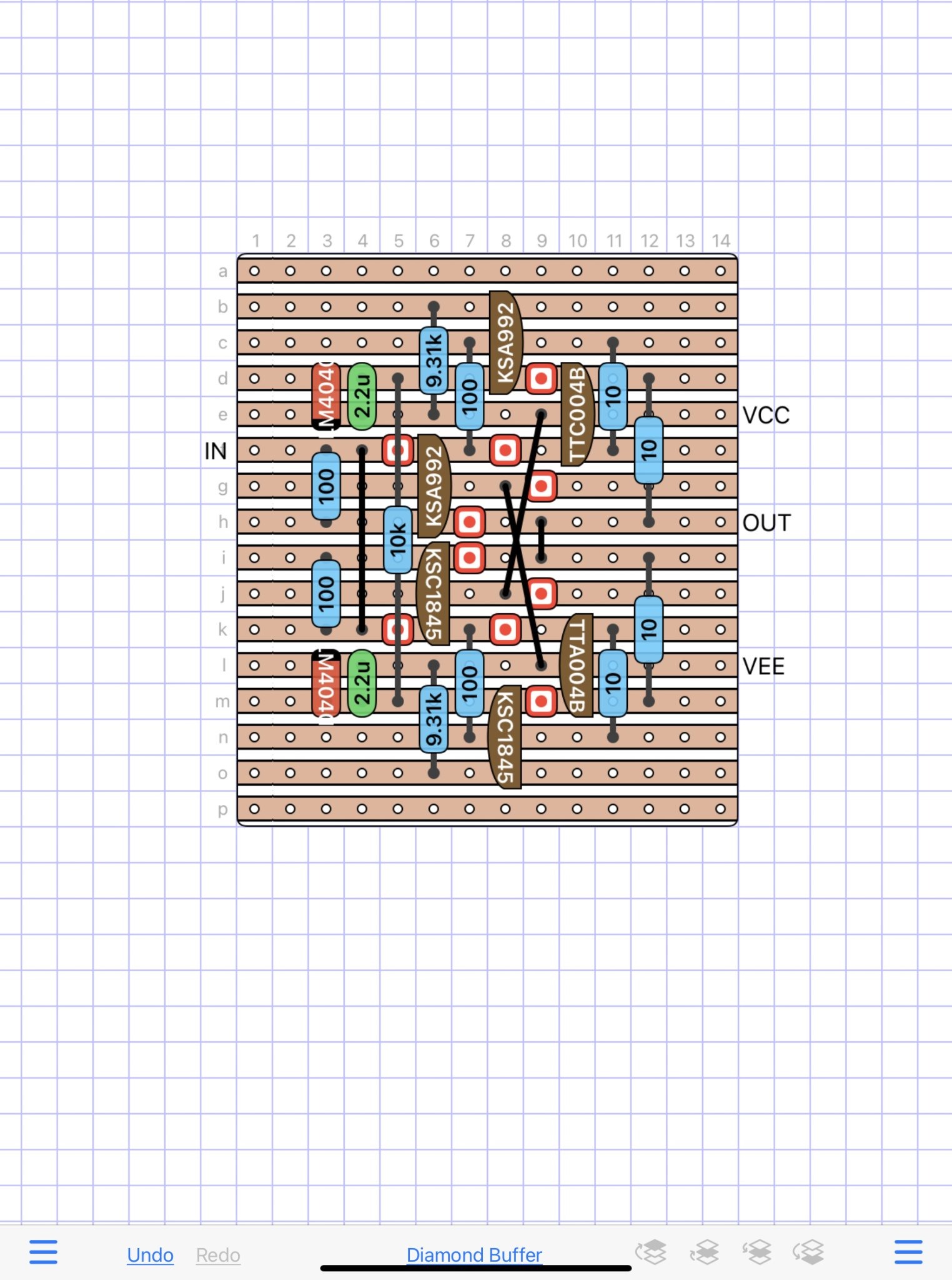

Starting up the new channel boards (w/ IXTQ75N10P) resulted in un-scheduled release of magic smoke from one of my diamond buffer input stages.
I am carefully re-evaluating the circuit construction and layout of both diamond buffer boards until I know I will not repeat the problem.
I found two issues with the board that smoked.
One was a design problem that crept into the layout. One of the voltage references was reversed. The corrected layout is below.
The second problem was a small solder bridge on the underside of the vero board. I’m still cleaning up & replacing fried parts.

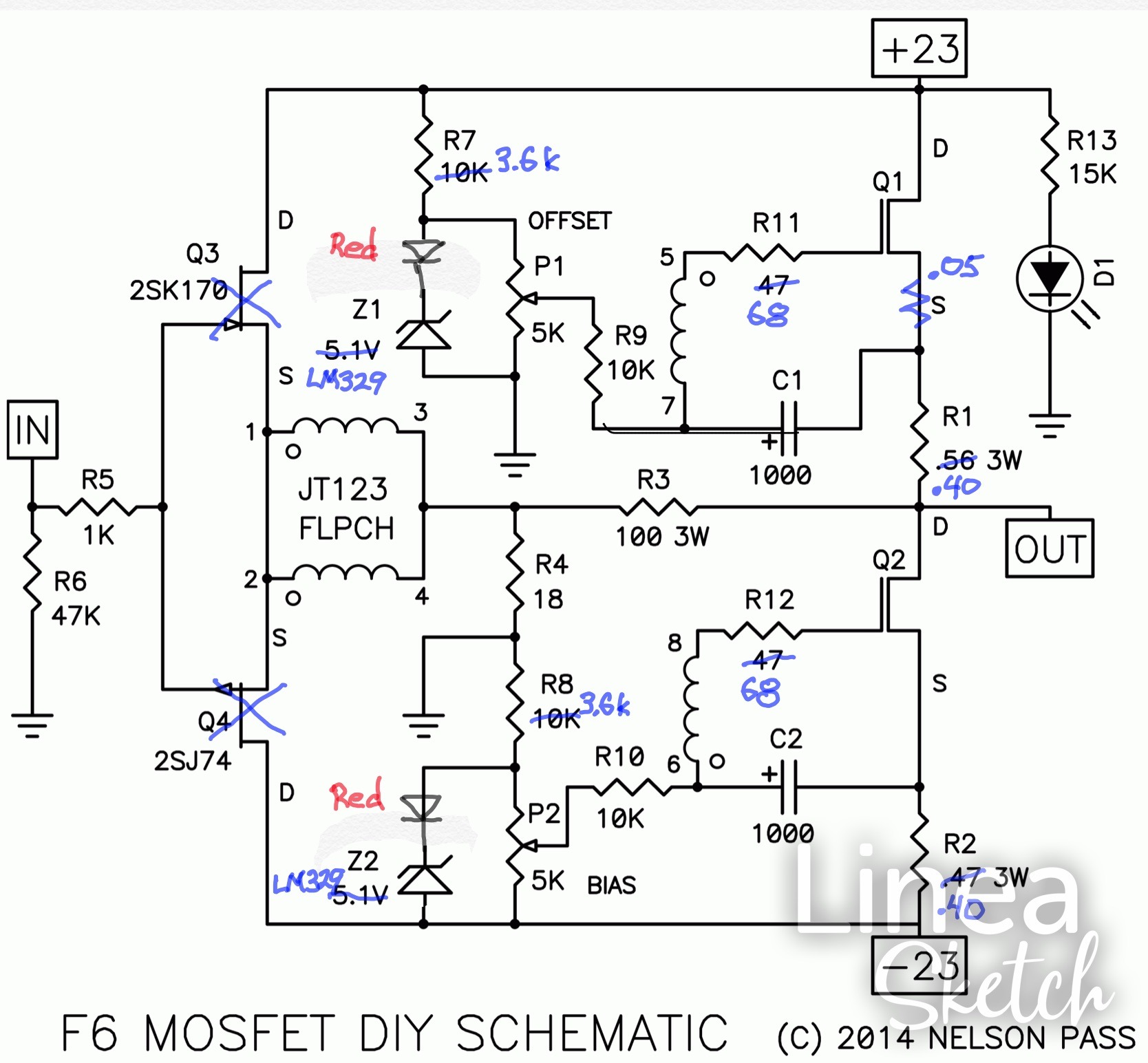

Power on testing one channel at a time revealed that the input threshold voltage of the IXTQ75N10P Mosfets exceeds what can be achieving with three green LEDs as the voltage reference. I was only able to see 1.4A of bias current, which I don’t consider sufficient for what I want to do with the amp.
Next up is trying a different configuration for the voltage references that will let the Mosfets run nice and hot.
The higher threshold voltage requirement of the IXTQ75N10P may rule them out for some. I still like the other parameters, and hope that they may be useful replacements for the discontinued FQH44N10.

I have some extra LEDs available to increase the number in the string. I am inclined to increase the reference voltage first, then experiment with different bias currents. My LED strings are giving me 5.86V, which suggests they could use more current.
For those playing the game at home, three LTL4231 LEDs can get close to 6.0 V with sufficient current through the string. Try a dropping resistor of 3.01k above the string.

I tried leaving the three green LEDs in place and reduced the dropping resistors to 3.01k. The LED strings produced a reference voltage of 5.95V. This indicates that the LED strings have effective voltage regulation.
One channel was able to achieve a bias current of 1.5A. The other channel could only reach 1.37A.
It will be necessary to boost the voltage higher to have sufficient margin to achieve the desired bias current.
I have not drawn the diamond buffer schematic yet. Ideally this would be captured in a PCB layout tool.
For now, the VeroBoard layout defines the circuit. This is actually a common technique for builders of DIY guitar effects pedals. I built a few different bass effects pedals for personal use before branching into alternate input stages.

I had to take a different approach to the voltage sources that are part of the bias current circuitry. I had a few difficulties constructing strings of four LEDs for each of the output devices. In the end I used a simpler combination of an LM329 plus an old style 5mm red LED. The voltage sources with this combination provide a more steady bias current for the big Mosfets, and are much easier to build. Final bias current has been set to 1.85 A.
I had the LM329 references from my original F6. Adding a red LED above the reference increases the total voltage to 8.5V, given 5 mA current through the pair. The red LEDs contribute 1.5V to the pair and are dimly lit in operation. Overall thermal coefficient of the LM329 + LED seems to be slightly negative.
