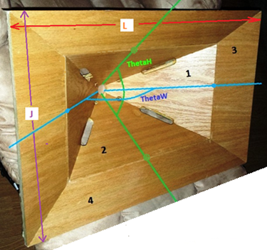

Here is a picture from Bwaslo's spreadsheet showing a typical synergy so you get an idea of what this may look like. The tiny little holes near the throat would be for the face of the 8GFE200's (I would use equivalent CSA of a 2.75in dia hole for each driver), and the slots towards the middel would be for either the bass reflex ports or for the additional woofers you could add.

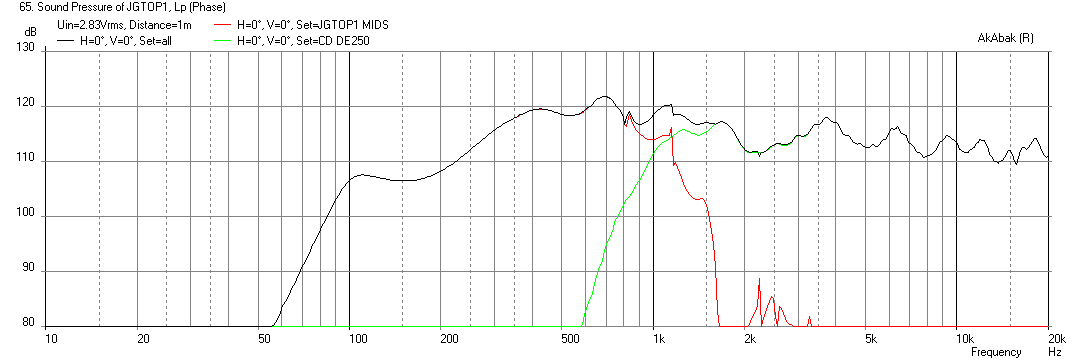

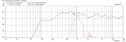

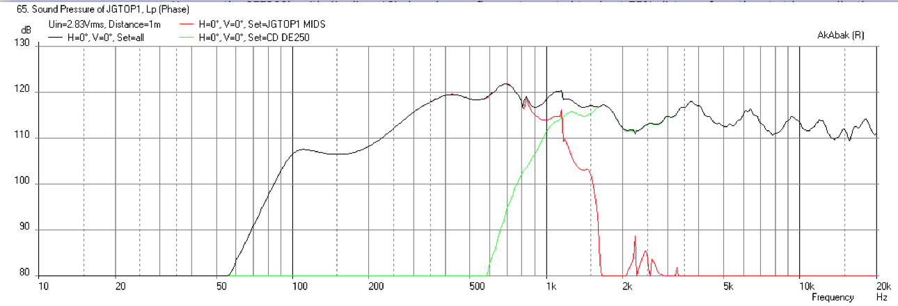

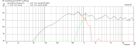

Here are some preliminary results of the 90deg H x 40deg V 2-way synergy with dual 8FE200's and a B&C DE250CD (model not verified but gives you an idea of what CD's can do in a horn).
Here are the 8FE200's running with sealed rear chambers:
![441364d1412249997-faitalpro-15hp1060-vs-3015lf-tapped-horn-jgtop-no-br-freq-1m.png](https://www.diyaudio.com/forums/attachments/subwoofers/441364d1412249997-faitalpro-15hp1060-vs-3015lf-tapped-horn-jgtop-no-br-freq-1m.png)

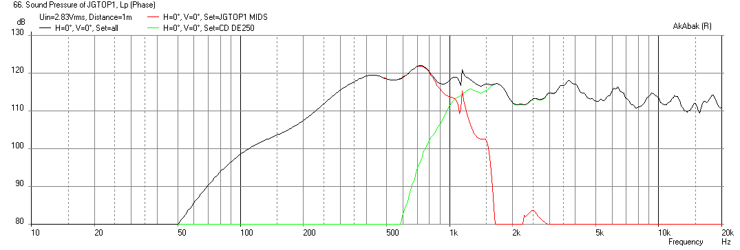

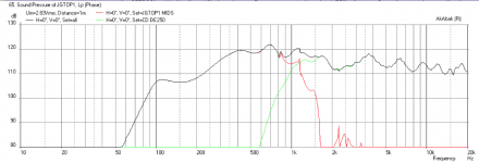

Here are the 8FE200's with 4in dia x 10in long bass reflex ports, routed to about 75% distance from throat at horn walls, the bass assist helps bring up the levels down to 100Hz, but there just isn't enough of it to compete with the highly sensitive front loaded output of the same driver. I think a couple of 15 in woofers ported to these same locations might give you better efficiency (which at circa 110dB is crazy high):
![441365d1412249997-faitalpro-15hp1060-vs-3015lf-tapped-horn-jgtop-br-freq-1m.png](https://www.diyaudio.com/forums/attachments/subwoofers/441365d1412249997-faitalpro-15hp1060-vs-3015lf-tapped-horn-jgtop-br-freq-1m.png)
Alternatively, if you can live with 107dB sensitivity, just EQ cut the front loaded output to be level with the bass reflex output and it will be balanced. That is the cheap and easy, but not ideal, fix. Is 107dB a match for your TH?

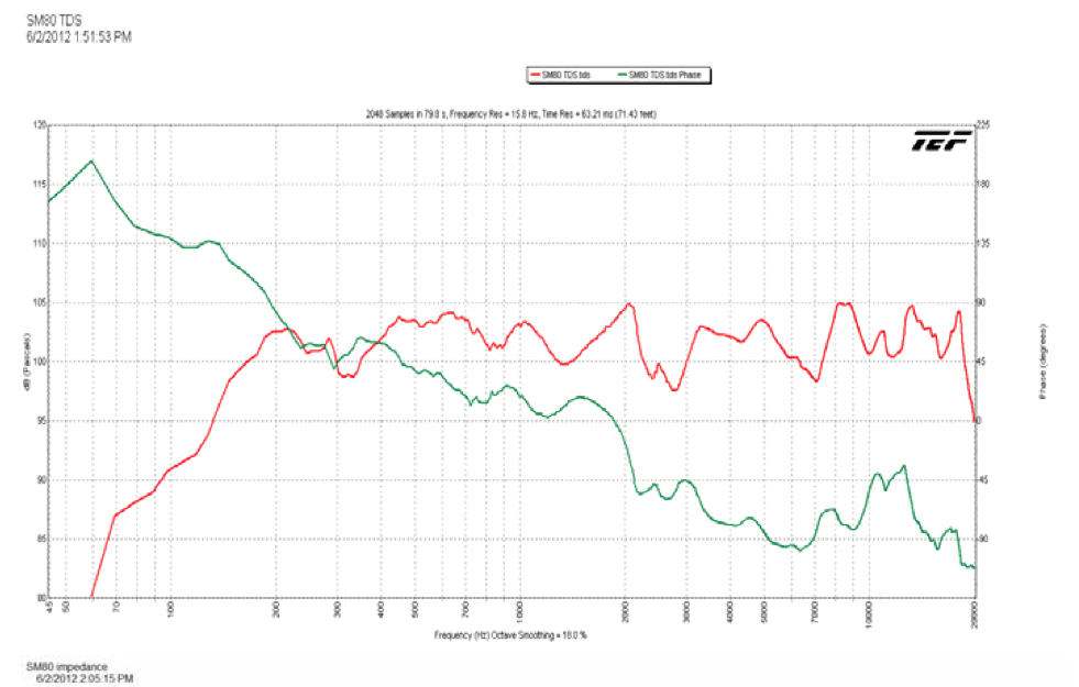

Xrk971's 90x40 2x8" BR Synergy simulation shows the level at 100 Hz around -12 dB from the midband, almost the same as DSL's popular SM80. Many EDM DJs seem quite happy with a ratio of one SM80 to 2 (or more) DSL TH118 outdoors.
The SM80 has about 8 dB more midband output than xrk971's 90x40 2x8", but a pair of TH118 (driven at rated power) probably have more than that much more output over your 2x15" TH.

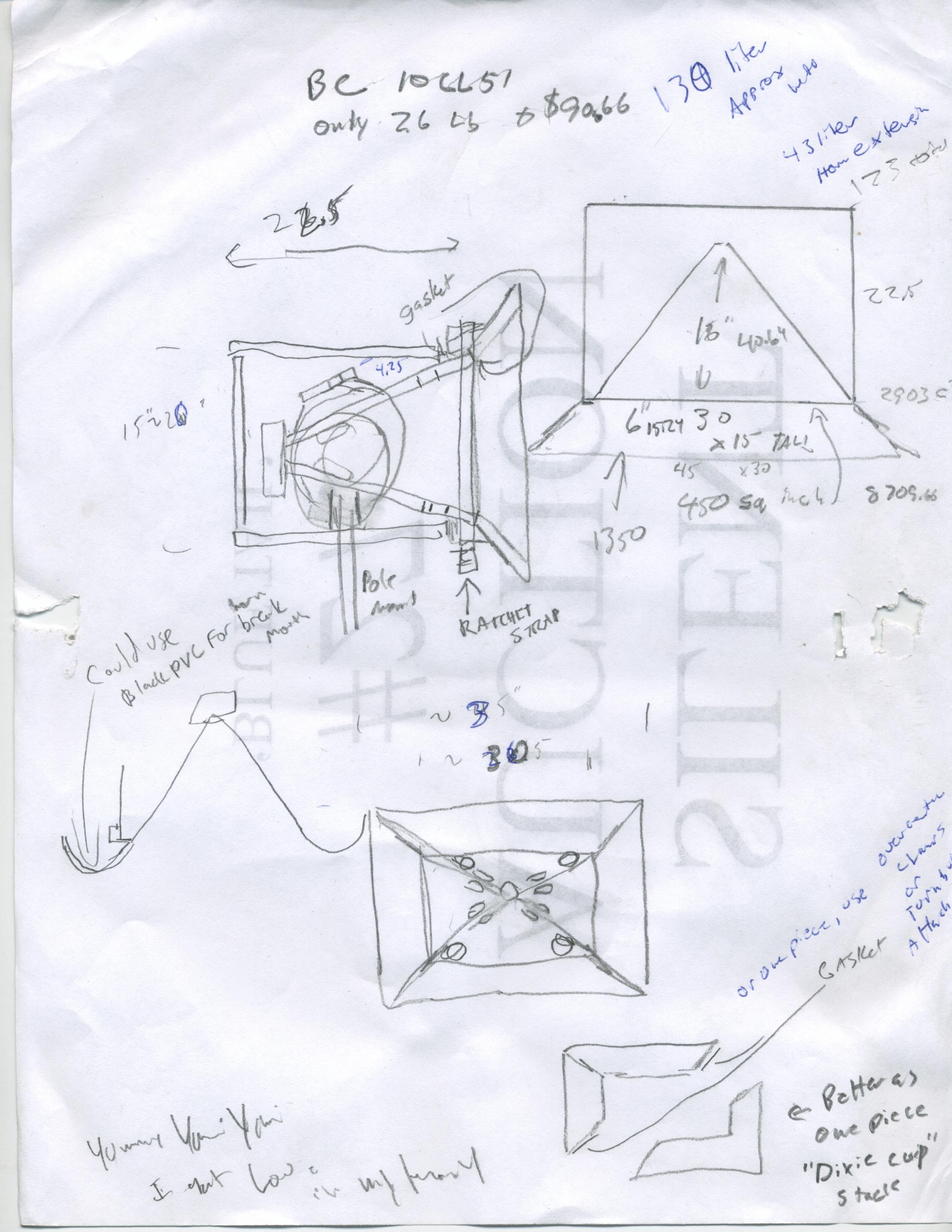

IIRC you only have a pair of 8", you really would want at least a pair in each cabinet.Really digging the dual idea, though. Running the tops stereo would be an awesome bonus.
Art do you think that is possible with what I have on hand and fit into a 25" length (50cm actual horn path)?
The depth is no problem, the DSL SH50 (50x50) is only 22.5" finished depth, going to 45x40 won't add much length, and you can truncate the second portion of the horn to save depth. You could also make the second portion of the horn as a separate piece, and add it on with over center clamps, turnbuckles or a ratchet strap when you get to the music destination.
The sketch below of a 3x10" 90x40 with 1.4" HF shows the concept.
