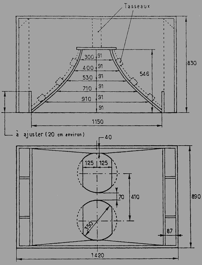

As to the ports, how about using ports as you might find them in a compound/Onken speaker(see attached)? I remember an old Frazier 8" back-loaded horn, that distributed the horn output all the way around the forward outside edge of the speaker.
This certainly can be done but may grow box and complexity of build. Personally, I am lazy and would do the qnty 8 x 2in dia x 5.5in long SCH 40 PVC ducts near the corners of the horn mouth and be done with it...

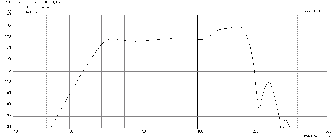

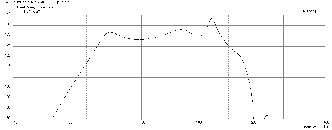

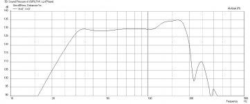

Here is your TH sim in its current state driven to xmax with no low pass filter:

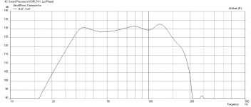

Here is what your TH in its current state looks like with a -48dB/oct LPF at 130Hz applied:

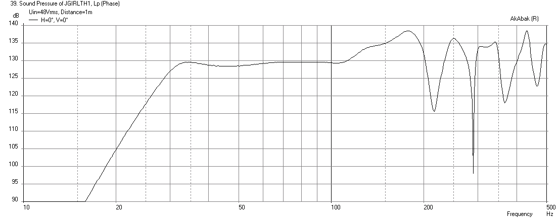

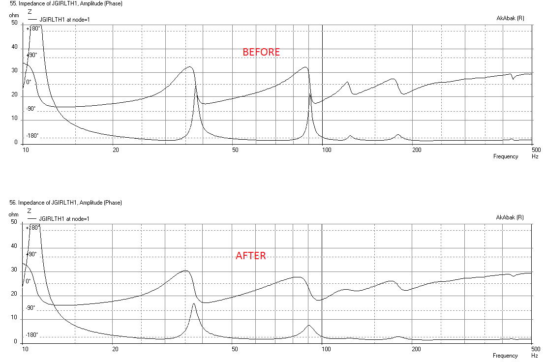

Here is what it looks like with the above stub tubes installed (no LPF) - note that in addition to the peaks at 122Hz and 176Hz being tamed, the sag at 50Hz is almost eliminated:

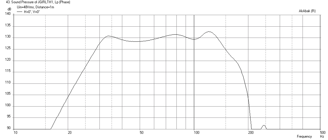

Here it is with the 130Hz LPF applied - pretty good upper extension and flatter response throughout - it becomes a better speaker, flatter response, can go up yo a higher XO point:
If you could only do one set of tubes, pick the 26.1in long ones and here is the response with LPF applied:
If you wanted to XO higher say at 170Hz, still doable, just need a -5dB high shelf applied in miniDSP vs a peak cut filter:
![442197d1412619512-faitalpro-15hp1060-vs-3015lf-tapped-horn-jgth1-no-qwtubes-freq-xmax-1m-no-filter.png](https://www.diyaudio.com/forums/attachments/subwoofers/442197d1412619512-faitalpro-15hp1060-vs-3015lf-tapped-horn-jgth1-no-qwtubes-freq-xmax-1m-no-filter.png)
![442198d1412619512-faitalpro-15hp1060-vs-3015lf-tapped-horn-jgth1-no-qwtubes-freq-xmax-1m-filter.png](https://www.diyaudio.com/forums/attachments/subwoofers/442198d1412619512-faitalpro-15hp1060-vs-3015lf-tapped-horn-jgth1-no-qwtubes-freq-xmax-1m-filter.png)
![442199d1412619512-faitalpro-15hp1060-vs-3015lf-tapped-horn-jgth1-qwtubes-freq-xmax-1m-no-filter.png](https://www.diyaudio.com/forums/attachments/subwoofers/442199d1412619512-faitalpro-15hp1060-vs-3015lf-tapped-horn-jgth1-qwtubes-freq-xmax-1m-no-filter.png)
![442200d1412619512-faitalpro-15hp1060-vs-3015lf-tapped-horn-jgth1-qwtubes-freq-xmax-1m.png](https://www.diyaudio.com/forums/attachments/subwoofers/442200d1412619512-faitalpro-15hp1060-vs-3015lf-tapped-horn-jgth1-qwtubes-freq-xmax-1m.png)
![442201d1412619512-faitalpro-15hp1060-vs-3015lf-tapped-horn-jgth1-no-qwtubes-freq-xmax-1m-filter-26in-only.png](https://www.diyaudio.com/forums/attachments/subwoofers/442201d1412619512-faitalpro-15hp1060-vs-3015lf-tapped-horn-jgth1-no-qwtubes-freq-xmax-1m-filter-26in-only.png)
![442202d1412620069-faitalpro-15hp1060-vs-3015lf-tapped-horn-jgth1-qwtubes-freq-xmax-1m-170hzlpf.png](https://www.diyaudio.com/forums/attachments/subwoofers/442202d1412620069-faitalpro-15hp1060-vs-3015lf-tapped-horn-jgth1-qwtubes-freq-xmax-1m-170hzlpf.png)

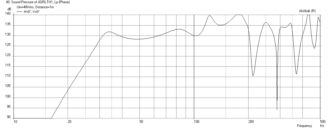

This is also a good opportunity to explain why the acoustic center is so important when using dual or multiple drivers to define S2 in offset driver designs.
In any offset driver design (including tapped horns) the part from S1 to S2 is actually working as a 1/4 wave trap. The sound enters the flare at S2, travels back to S1 and is reflected back to S2 where it creates a notch determined in frequency by the shape of the stub and the distance traveled, and in depth determined by it's size.
Here's a picture of a transmission line. The only difference in these two images is the top response sim was run as Nd and the bottom was run as Od, L12 in both is 33 cm. In the Od sim the volume defined as S1 - S2 is acting as a 1/4 wave trap because of the reflection from the closed end of the line.
This big notch is why it's important to make sure S2 is defined as the acoustic center in the case of dual or multiple drivers. If S2 is set anywhere other than the acoustic center of the drivers the notch won't be in the right place in the sim.
This also shows that 1/4 wave stubs can be very effective in creating notches if they are big enough.
