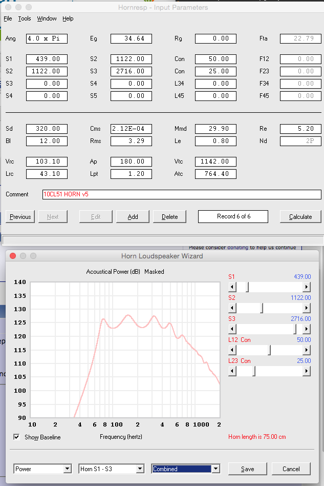

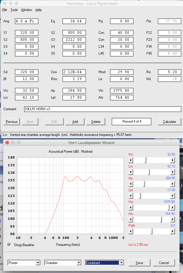

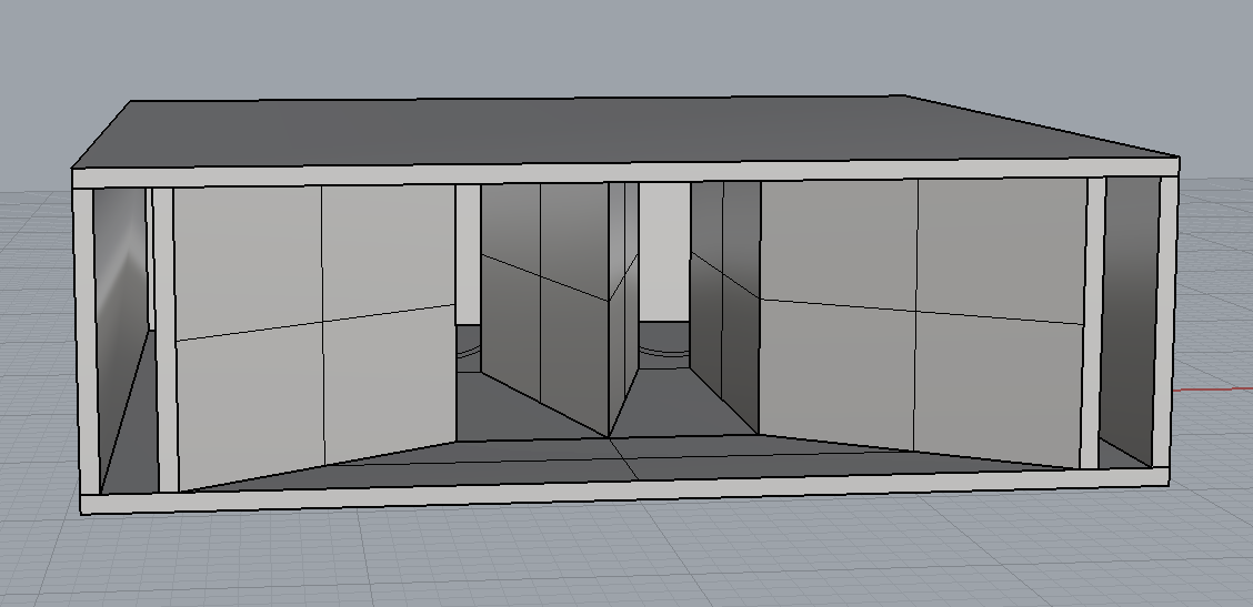

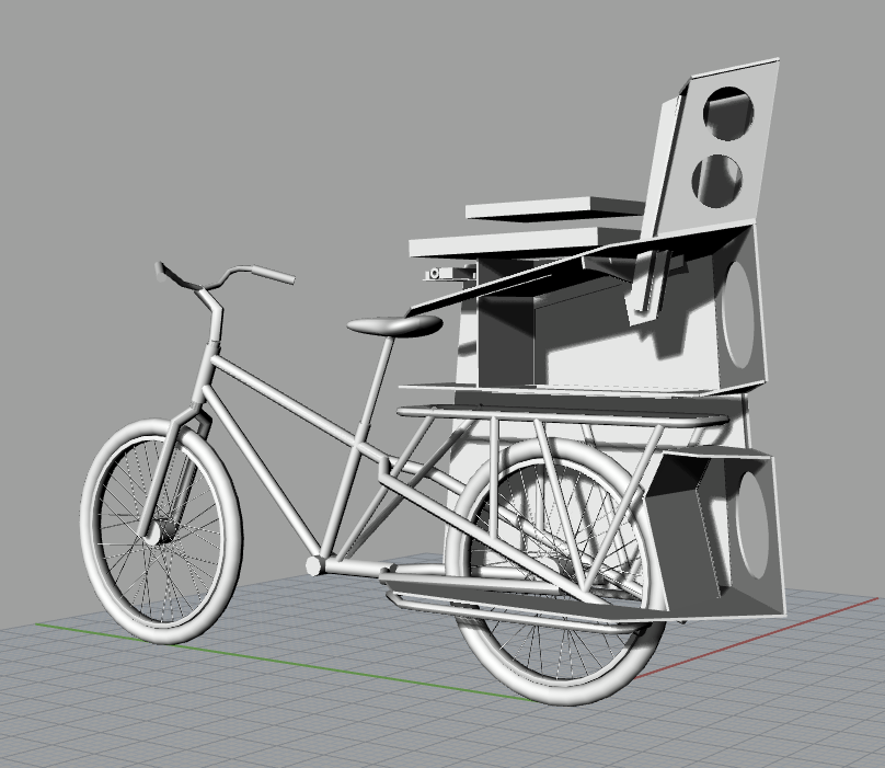

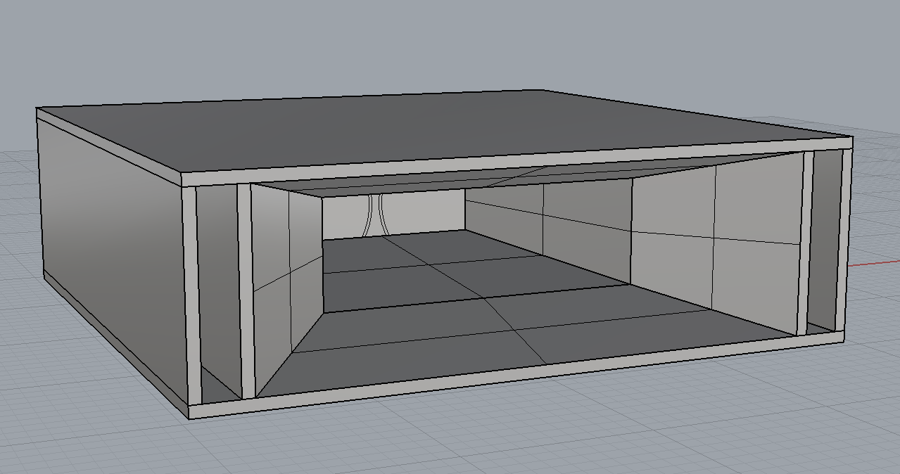

Well the above sim is junk, I was accidentally converting between std-metric using cubic instead of square conversion *facepalm*

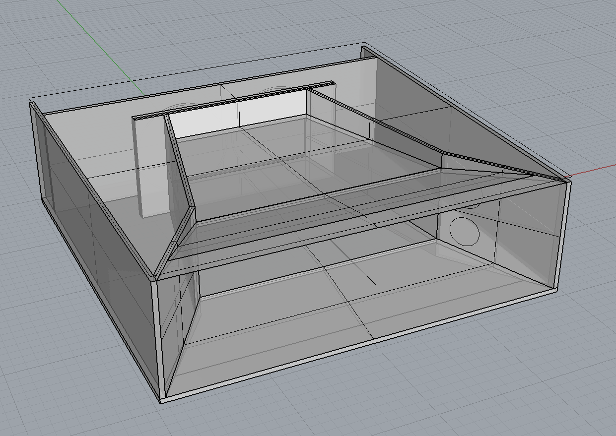

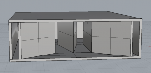

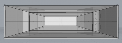

Anyway here is a new sim, and some cad drawings to match.
I'm pretty new to midbass horns, I've only ever done subs. How important is the horn profile? I imagine at a certain frequency it starts to become very important.
More updates
After reading through some threads on FLH midbasses, I took some cues from jbell's HS12
Looking for any comments about the ports- if they are too big / taking up too much space in the horn. Thank you in advance for anyone who might want to chime in!

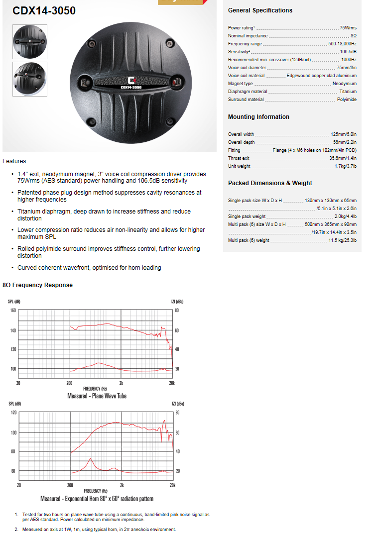

If I did this, it would have a couple of neodymium twelves for the low frequencies, four midranges for the midrange, and a single compression driver for the highs. It would cover 40hz to 20,000hz and it would be about 103dB efficient. With five hundred watts of amplification you could hit 130dB. The heaviest part would probably be the batter to power it, and you'd probably want some way of charging the batteries. Perhaps a solar panel?

Regarding mid horns, the profile is critical - I have found that tractrix profile as predicted by the spreadsheet provided by volvotreter works really well. I have built a few and they sound great. They load the cone well and the displacement is really small so distortion is low. They are not constant directivity though.

The other profile that I have see that works really well as a bass horn that goes from 60Hz to 500Hz is the University Classic. If you take the same expansion and scale it for higher frequencies it can work really well. Very efficient and smooth response.
See examples here - there are some HR models and Akabak models posted:

About a year ago I ran some sims comparing the 100,000 watt setups from PK Sound to the Tonka rig, and the Tonka systems were pretty close. Naturally, the PK boxes are much smaller.
I'm super busy, but I'm fairly local, so if you need any help with horns, LMK.
I would be REALLY careful about picking the F3. Your efficiency is going to drop like a rock the lower you play. PK Sound started out running labsubs, and when they switched to systems that play about half an octave lower, they had to increase their amplifier output to about 100,000 watts. It takes an insane amount of power to do 30hz justice. And I've heard the PK rigs inside and outside, and when they're outside they sound pretty anemic, even with all that power. (Indoors they're mind bending.)I guess using the sub as-is a huge excitement for me, I have spent so much time and research building it. The 28hz 130dB thing is huge, too!
As far as mid/hf options, a synergy I think would be too top heavy on the trailer being that it would be mounted so high up (there needs to be room for DJ equipment atop the sub).
In a nutshell, I'd be looking at an F3 around 40-50hz to keep the efficiency high. Unless you're prepared to bring 10,000 watts or more.

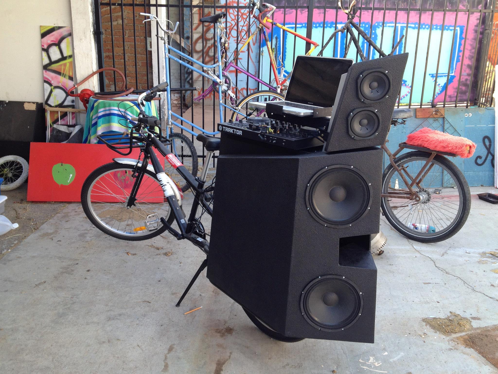

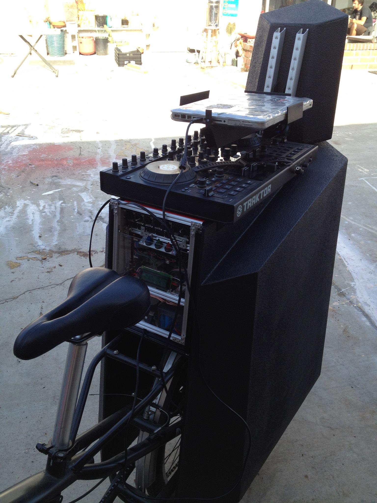

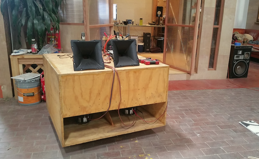

Here are some photos of a previous bicycle build I did several years ago. It uses 4x10CL51, 4xgalaxy 5.5" drivers, a ~60L enclosure, powered by 36v li-ions, classdaudio.com amps. Pumps like crazy for about 20 hours with 10lbs of battery. Party machine.
This next project is trailer based, with not nearly as much consideration for weight efficiency. Really, I just want bass. If it's less portable, that's okay. I always have the older setup if I need something smaller and efficient

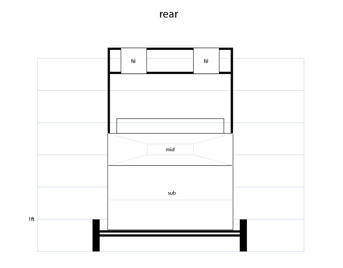

Oh, it just clicked:
Bass bins at the bottom, midbass on top of it, and the tweeters up high.
You don't want the tweeters that far from the midbass; it's going to create some nightmarish comb filtering. I can understand why you're avoiding the Synergy route, it *would* make it top heavy.
If it were me, I'd ditch the tweeters up high and go with a two-way Synergy horn where the midbass horn is located now.
So it would still be a three-way, but the mids and the highs would be coherent and would have superior directivity, which is really nice with percussive music like EDM.

But then the highs would get lost in the first few people of the dance party in front?
The biggest use of it is when stopped, and the DJ is on the decks.
I could see the synergy horn working, only if it were telescopic and could be raised up when stopped, in the down position when traveling. That's actually what i did with the previous bicycle build shown in my previous post
Then I would have a lot of weight up top, or I could put it right above the sub but then if anyone stands up next to the sub to dance (which they will) then highs get lost into the person's belly![]()

Oh, maybe I didn't specify. This is going on a trailer to be pulled by the trike. So mounting options are pretty flexible as long as there is room for the DJ part!
More and more leaning towards Synergy. I had been wanting to build one when I had just completed the sub, but for some reason started down the FLH path.
