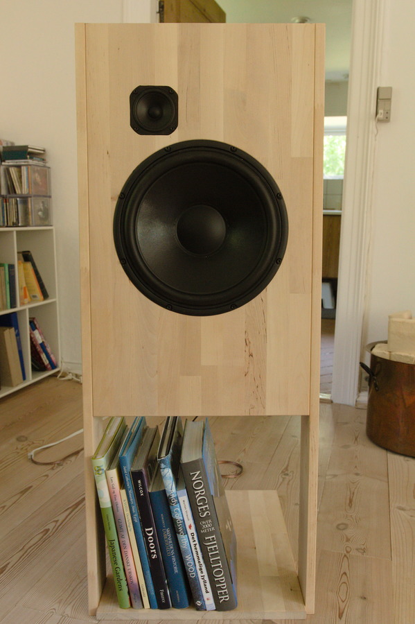

regarding the position of the Manzanitas, as I understand the stand at least 12" high is primary to limit the floor bounce in 100-400Hz region, and instead of a stand it is possible to make the wings longer, but wich is the difference in having also the baffle longer under the woofer only, making the Manzanitas kind of a smaller Ultra version? Is the longer baffle the problem or that one touching the floor that could be avoided putting some feet under the speakers? Also John said answering to a member about the baffle "16" baffle width is ok, wider is better actually", so could be even wider than the "standard" one? There is a correlation to height and width?
daide... Width is of more importance than over all baffle length. The baffle width (along with wing depth) sets both the potential efficiency of the system and F equal value. The crossover is designed around these two dimension values. You can extend the baffle down toward the floor, jusk keep the woofer and tweeter where they would be relative to floor distance if they were mounted on an 18" stand. With a longer baffle extending downward to the floor there may be a slight efficiency gain and a bit more floor refelction issues at certain listening distances. Some builders run the wings all the way to the floor, as in 18" of added vertical length. Hope this all make sense. Please let us know what you do and how it works out! J
Is the crossover shelf / place an acoustically significant element?
I'm talking about the stand mount - the SLS12 + tc9fd.
She plans to look in the style shown in the photo.

xover location...
The crossover location should not be an issue. Just make sure all of the crossover parts are securely fixed. Given the mechanical forces the woofer puts on the baffle, anything that can move or vibrate, well, will move and vibrate! Let us know how your Manzanita works out for you! J
