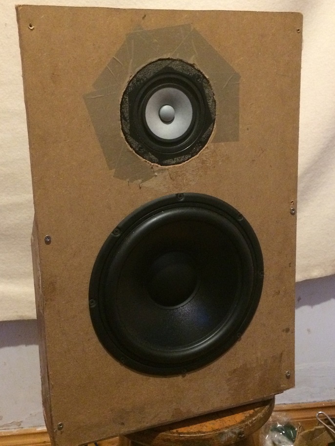

Here is a rough Manzanita-style build with Alpair 7p and Peerless SLS-P830668 (10'')
I'm amazed at how well it turned out, A7p technical performance is excellent from treble down to high bass, the woofer provides clean and deep bass up to very high levels.
All with that super clean and natural OB sound.
It also plays very well in small rooms.
The Peerless 10'' was chosen instead of 12'' because it was cheaper+available, my power requirements weren't that high and it's response up top looked a bit smoother (more flexible for other projects).
For €50 they are really killer woofers.

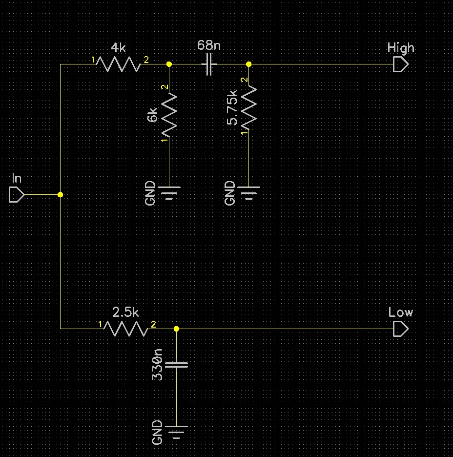

I cheated with the XO, they are bi-amped with an 'active' XO (1st order passive before amps). Check schematics for XO values I settled at
The XO point was critical for the woofer, there was a very fine line between sounding thin/sucked out and honky
The a7p was much more flexible, attenuator can be fine tuned for brighter/warmer sound.
XO point worked well in the 200Hz to 300Hz range, depends on your preference for slightly more body vs clarity.

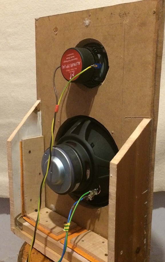

2 small but important things learned during the build:
-The A7p was badly effected if not tightly coupled to the baffle, the mids and highs became harsher and the driver lost some of its subtlety.
-While OBs are generally easier to build than boxes, the impact of the quality of the baffle is huge, maybe bigger than boxes.
Just to mention in case someone wants to build something similar, it is not exactly the same as a Manzanita baffle.
Baffle is 20mm MDF, 15x22''.
Wings are 20mm pine, 4'' deep and obviously tapered off below the a7p, later adding some bits of ply boards to try to stiffen it.
Not much of it is intentional, just working with what materials I had on hand.
This was mostly to serve as a test baffle but there is really very little wrong with it, so happy for the moment.
edit:HP resistor should be 7.75k

Hi Lasercut,
Ignoramus over here just trying to piece together an understanding of the XO,
if you don't mind,
what's the (output) impedance of your source and the (input impedence of the)
two amps you're using to drive the speakers?
[Edit] And the gain of the two amps?

My current source Z is 20r, the amps are 4x LM3886s at 10x gain.
The HP connects directly to an LM3886 input, so the 7.75k resistors sets the input impedance.
The LP LM3886 input has a 10k resistor in parallel which sets the input impedance... I should have added this to the XO diagram since it is attenuating the LP output.
I dont mind the questions btw

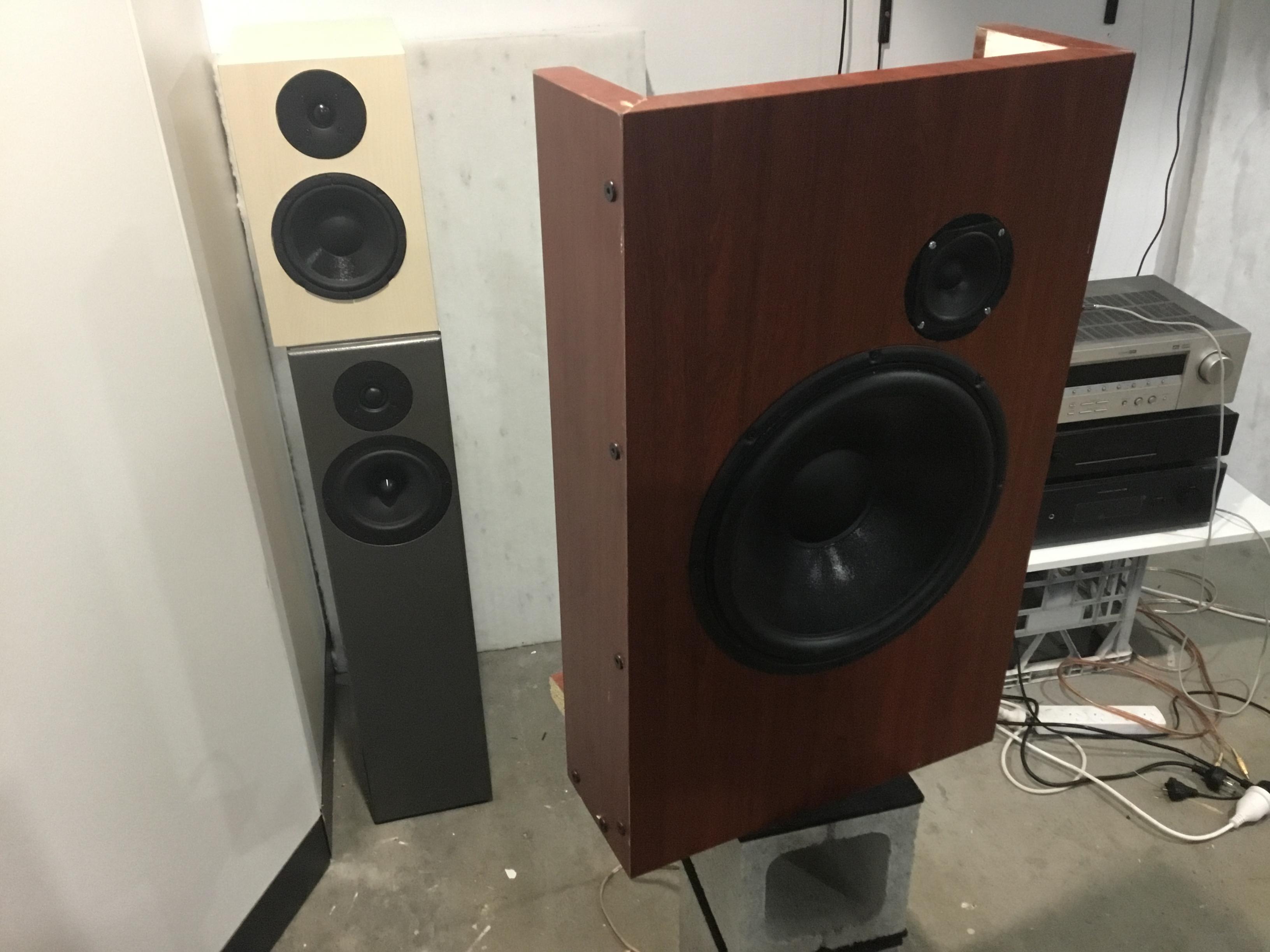

I thought I’d just keep this thread alive and let everyone know this design is still getting built.
I knocked together the 12” inch version from and old bed head I had laying around and was amazed by the open baffle experience
The baffle is only particle board so the woofer really excites it and the thin panel the vifa is mounted in vibrates considerably so I’ve got a few improvements planned for the next build.
Thanks to John and everyone who has contributed to this thread.
I’m keeping an eye out for the next version with the twin woofers that’s been teased. Hope your well John and Hello from down here in Australia
