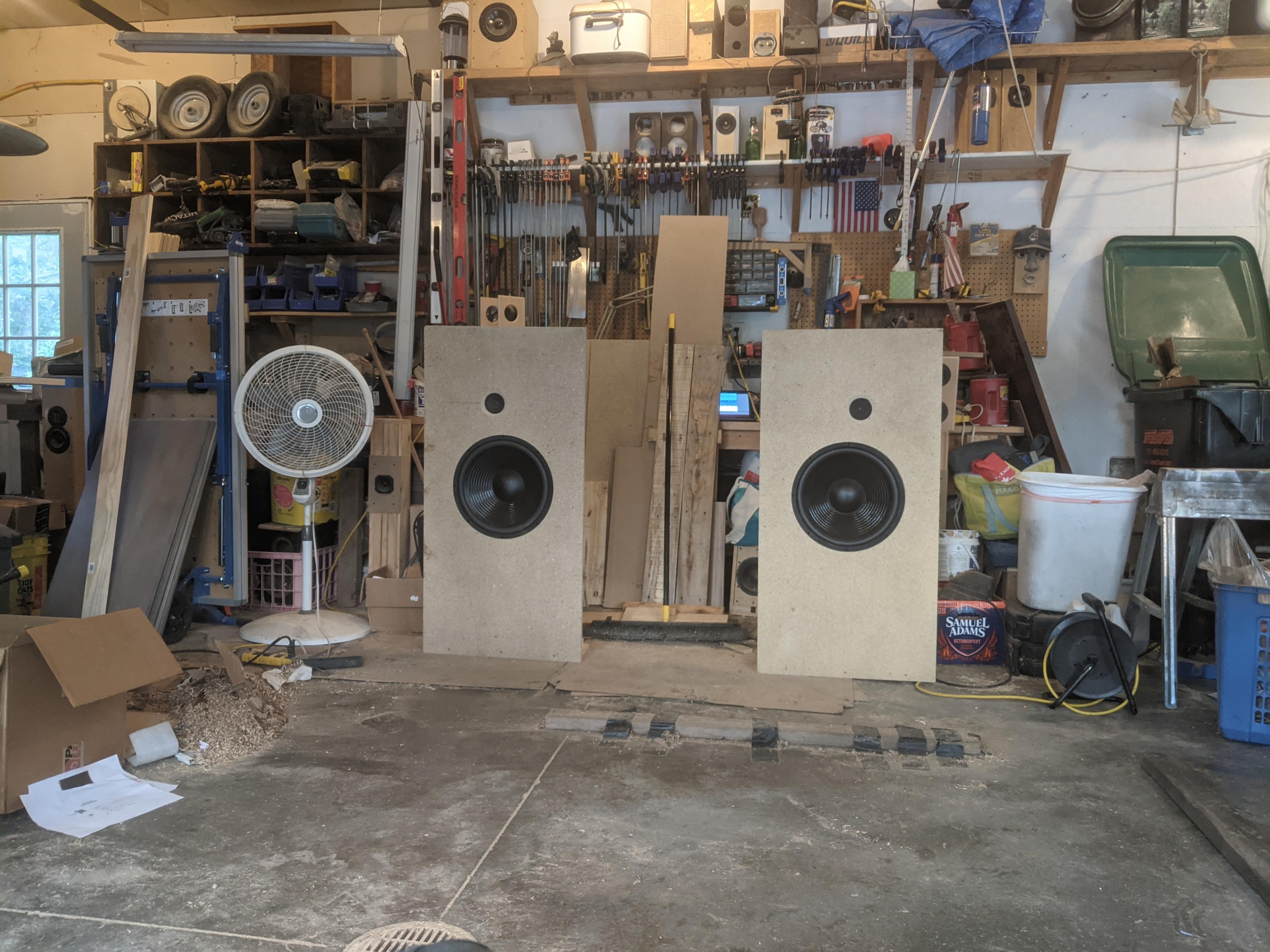

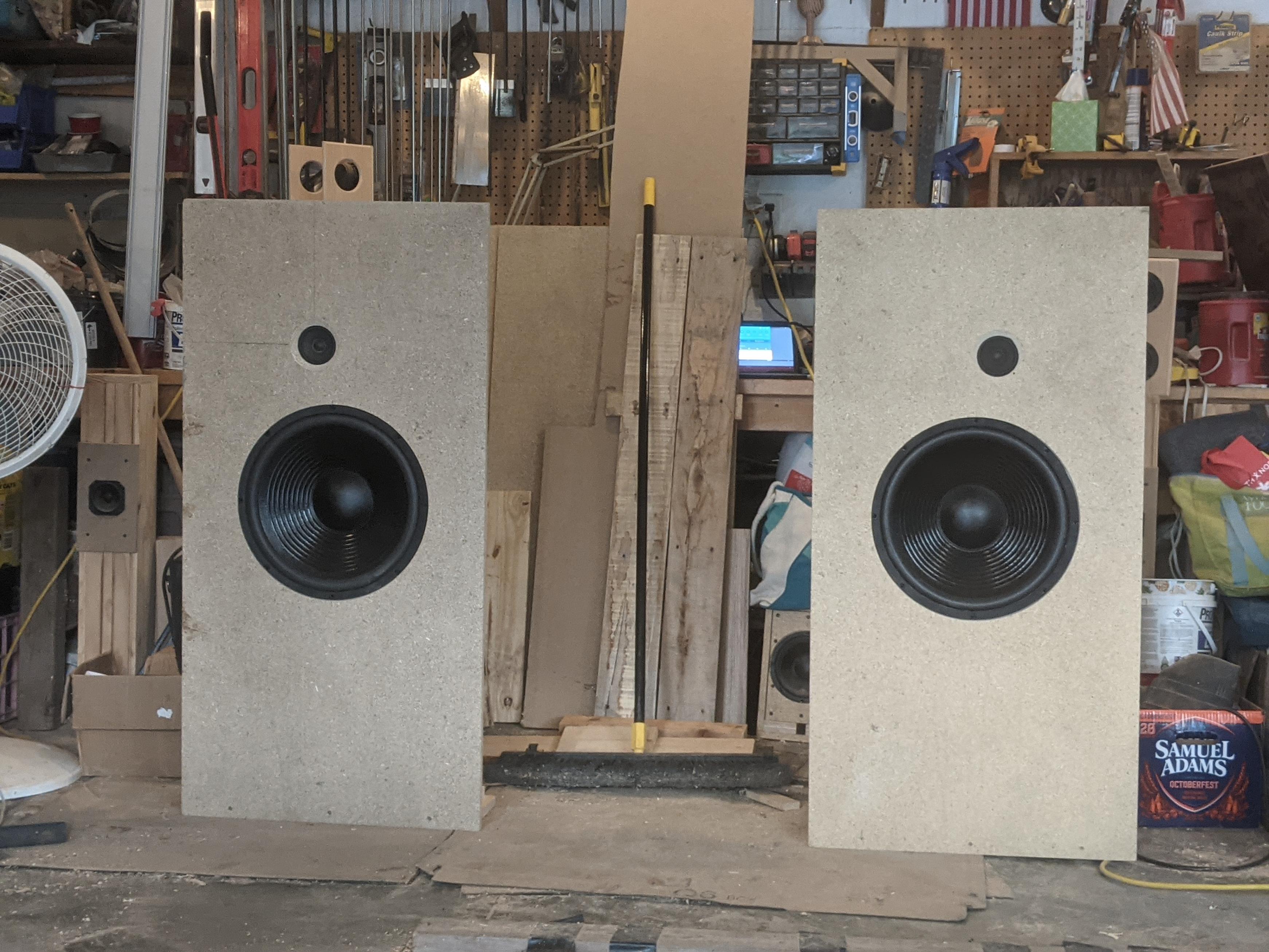

Don't mind the background, my messy shop, but I finished my Manzanitas. I ordered the wrong inductor, so I had to wait for the right one to get here. These guys are well worth the low price tag. They sound far better than the price would lead a guy to believe they should sound. I wasn't sure what to expect with the bass, but I'm very pleasantly surprised. Very impressed all the way around. That little TC9 is a great little driver. I'm going to have to order 10 or 12 more just to have for other projects
Now... I need to find some place for them other than my shop.

It looks like the edit function is turned off.
First, I wanted to thank Pano as well as John.
Second, I used the word finished, but that's only for the first listen. If I shrink the baffle size to 29" X 17", how much different will they sound?
Finally, I'm not sure what finish will look best on them. I don't think veneer will work since I've already recessed the woofer hole, and since I rear-mounted the TC-9, I chamfered the hole in front of the driver. I've never had good results trimming veneer around a recess.
Anyway, thanks again, John and Pano!

Reduced baffle dimensions
Mike.. Thanks for the pictures and positive comments! You can reduce the baffle a bit without serious new issues. You will give away some deep bass and over all efficiency. As usual, everything is a trade off of sorts. If you can, do a simple heavy card board mock up using the smaller dimensions and see what you get is acceptable to you. J
