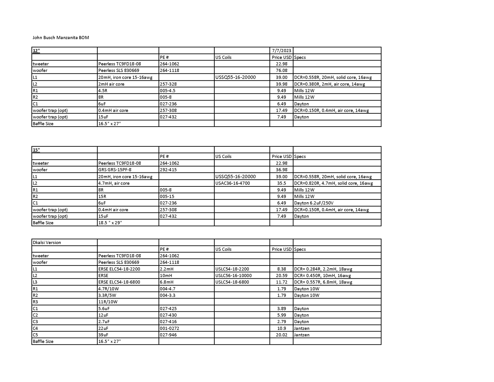

I've always wanted to build some of these since I heard John play them at the 2007 LSAF. He was always great to hang around at the shows through the years (RIP). So now that I've finally got off my butt I'm seeing the inductors have gotten stupid $$$ and are hard to find. Any good source for the 20mH and the 2mH inductors that will work well with the regular 12" design?
Happy to hear you're still active -- I remember sending time with you in Jef and Deborah Leonard's room at the last GPAF and the first LSAF get togethers. In any case, the nice inductors that were sold as Erse Super Q coils are now made by US Coils:
https://uscoils.us/super-q-coils/
While not cheap, they haven't gone through the roof, and I think they are now shipping. I also see that they now have a 20mH in 12 gauge, so a nice drop in dcr.

The inductors were always a big part of the cost, but now of course they are scary expensive for a budget project like this. If the Link that Skip Pack posted doesn't bring you any joy, somewhere in this long thread I have posted some Parts Express crossovers that have decent coils for a decent price. Not like the big Erse or Sledgehammer inductors, but they will get you started.
There are 6 types of coils listed on uscoils website but there didn't seem to be a 20 mh version. But double check my work as I tend to miss things. No idea if they'd make them up custom.
An Internet search for 20 mh inductors didn't bring up much.
In the mean time the Parts-Express low pass filter that has the 18 mh inductor is #266-446. They are listed as being in stock.
