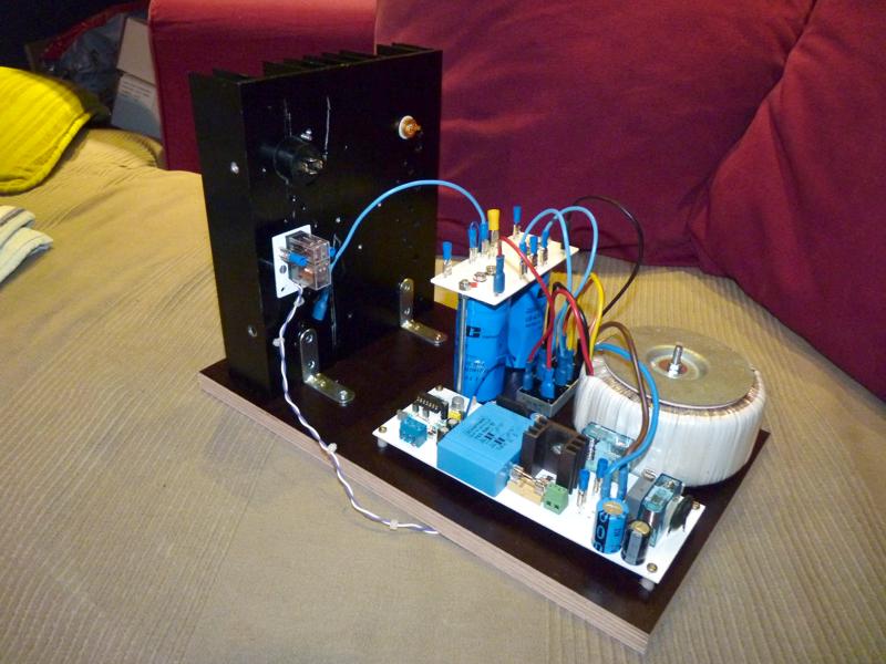

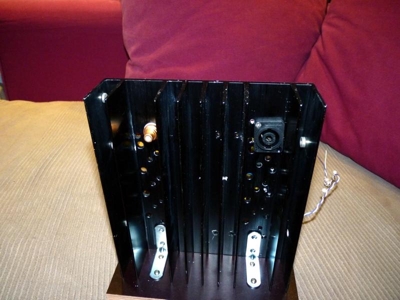

It will take a little more time, i am always waiting Sanken and VAS devices. BG1_bjt will run on the +/-36V test chassis (sheet of wood with complete power supply, soft-start, DC-speaker protection). I just have to swap heatsink who has amp-board on and to connect supply to make it running. I will take few picture tomorrow.
Final building wil integrate PMI capacitance multiplier and monobloc configuration.

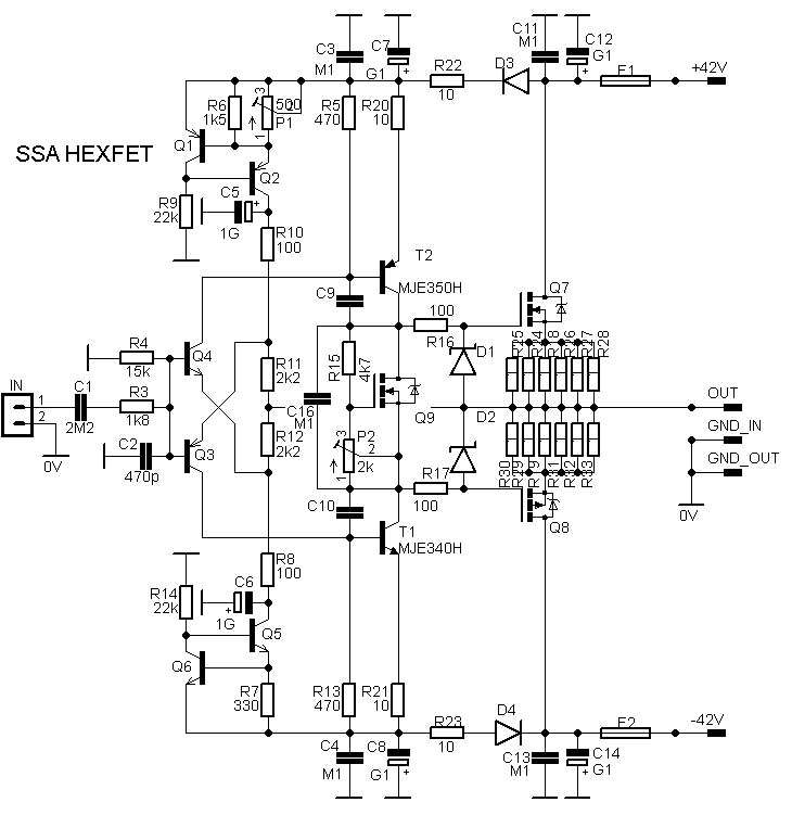

If you are going to use caps next to the o/p transistors put them as close as possible to o/p devices anyway (example bellow).
For one pair of hexfets I didnt used any source resistors ( i know that the are recommended) and results were perfect.
I have measured DF of latfet version and at 8R 100Hz it was 735 so I think is very good.
After I come back from my holidays I will try to mesure BJT and FET-hex version too

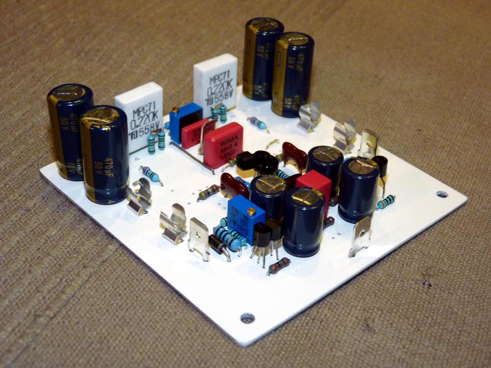

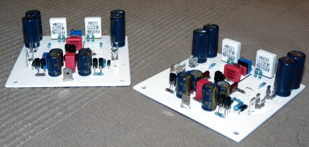

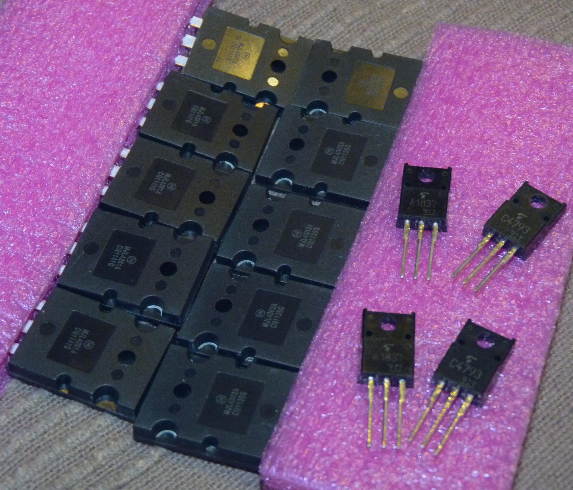

Yesterday night i populate second board. I still waiting for driver and Sanken output. I just take a look at my stock in case they take more time to than i expected. I have some 2sc4793/2sa1837 from other project, MJL4281/4302, NJW3281/1302, and MJL3281/1302... to begin with...
Marc

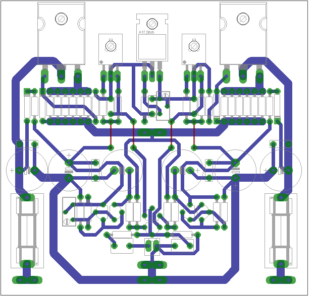

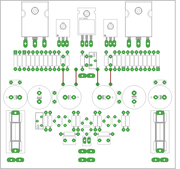

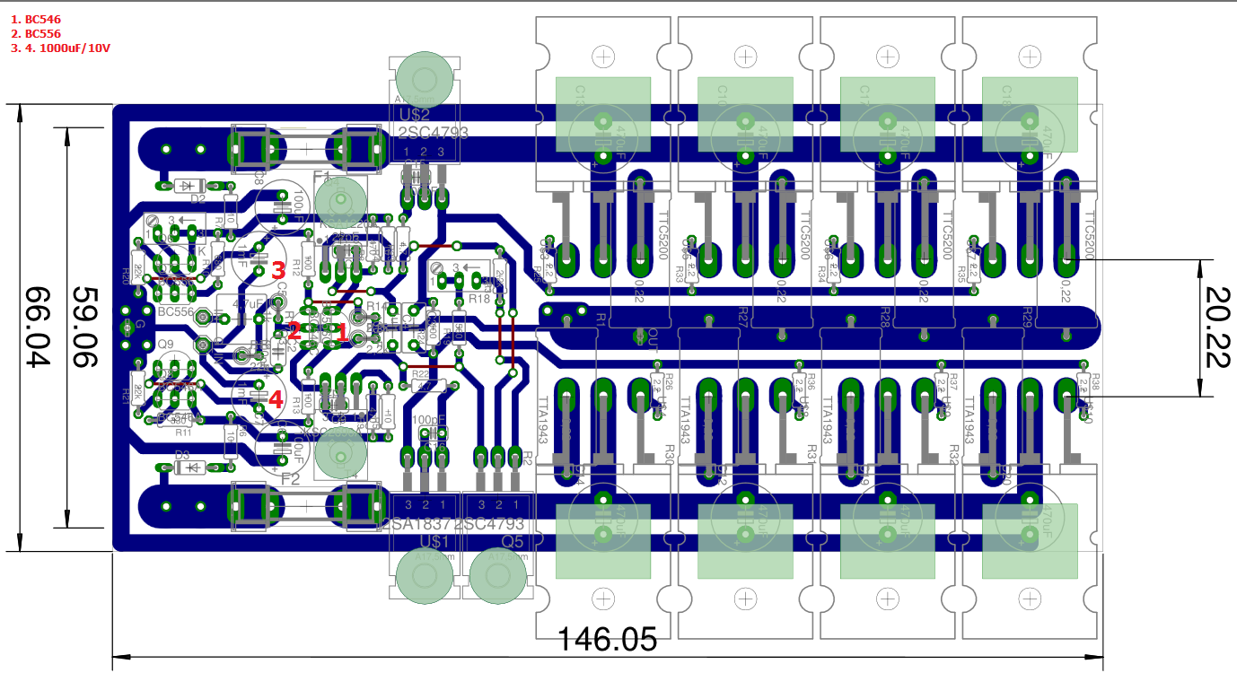

My PCB version VSSA BJT, double sided without metallization:
Not tested, it will be soon.
Looks like a very good component placement, but the grey-on-grey layout is hard to see. Looking forward to more pics...My PCB version VSSA BJT, double sided without metallization...
Marc
MJL4281/4302 one of the best ON Semi BJT, I used those and other MJL or MJW but these are my favorite.
It would be good to know how will measure up with the Sankens.
Greetings G
Greetings G
I have five each...If sanken take too long time maybe will i try with these since i have no projet on them.
Marc
Yes, I knowLooks like a very good component placement, but the grey-on-grey layout is hard to see. Looking forward to more pics...![]()
BR

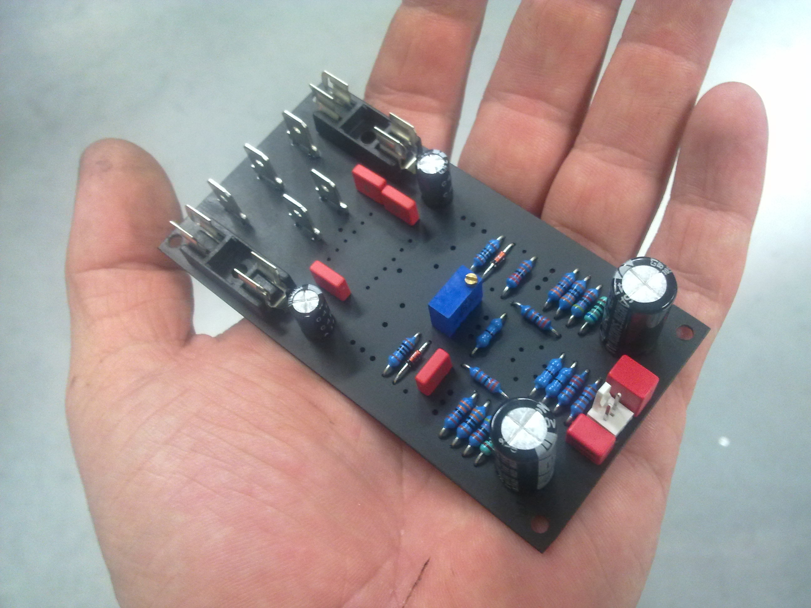

That's a work of art, Marc! If I could do that, I might not bother having them "professionally" made...![]()
Hi Pete,
"having them pofessionnaly made" has some advantages...I really hate the drilling PCB session for exemple...or having metallized drill made under PCB transistor soldering easyer.....but desoldering not....
Marc

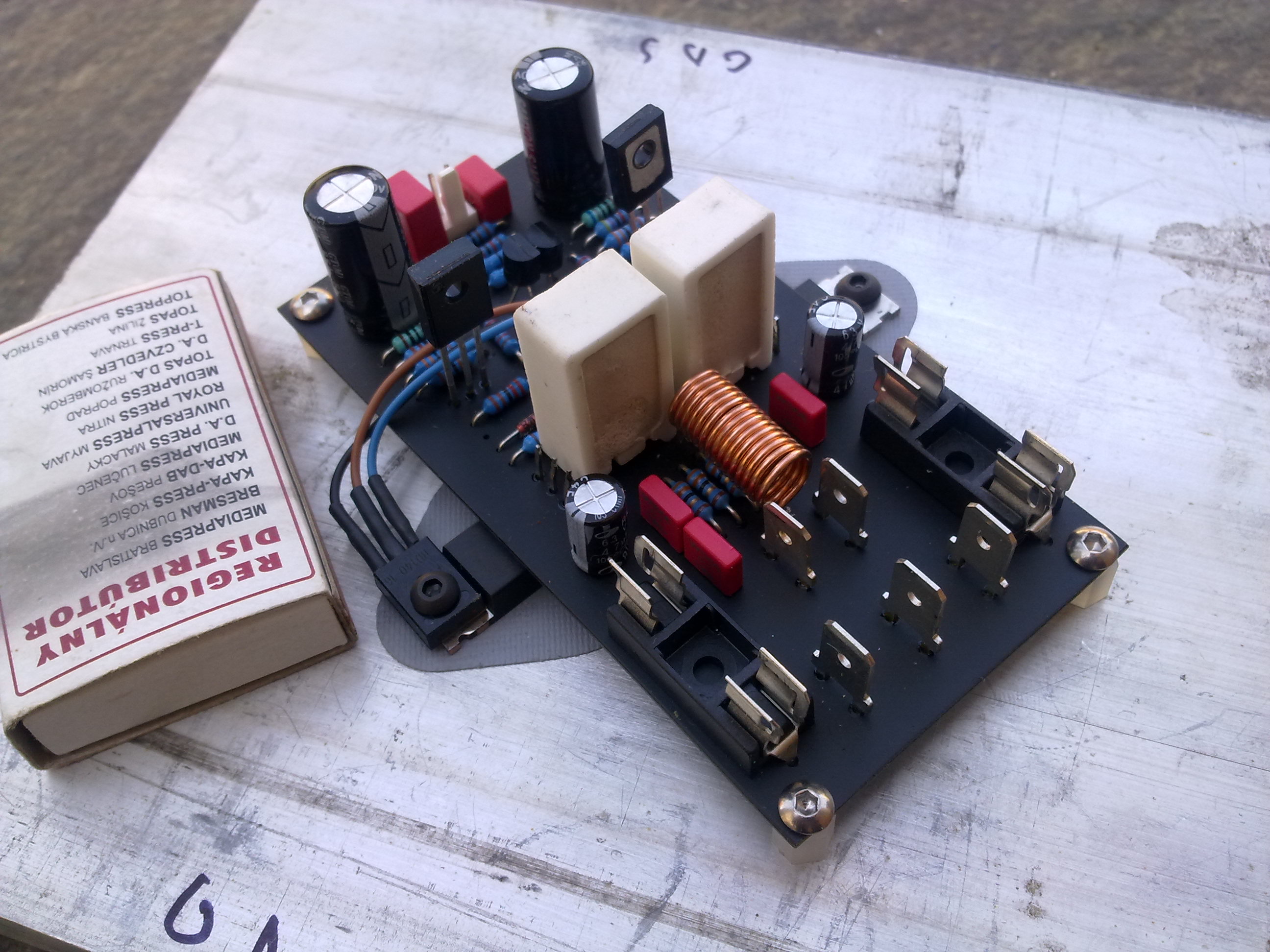

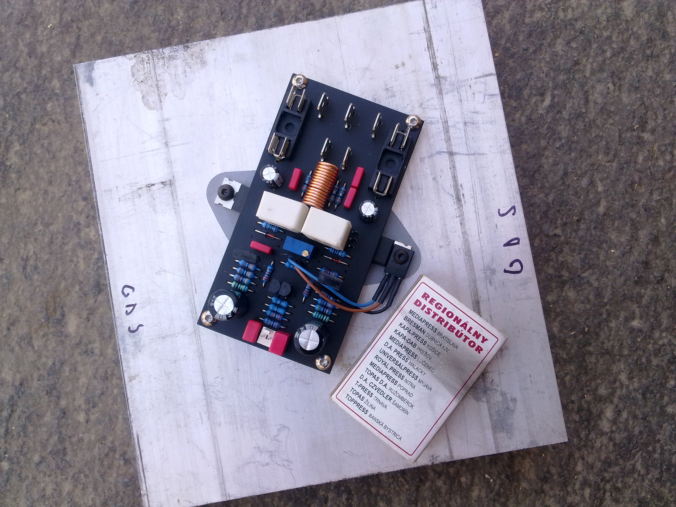

VSSA with IRF640/9640 on a small PCB
Really neat job...Why the output coil? have you encounter issue with stability?
IRF640/9640 => Headphone amp???
Marc
