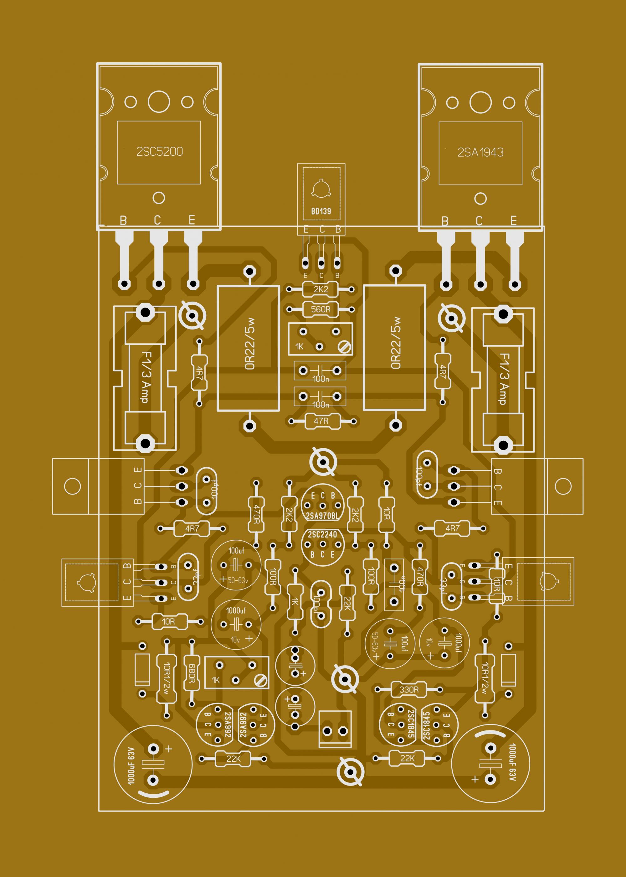

Hi All!
I made my own lay-out based on VSSA BJT by Borys. I'm kind of liking the BJT version for the reason of parts availability. I have made the input pair to be 2SC2240/A970 and the CCS to be 2SC1845/A992. These types are very much available here in my place. My lay-out is not final, not till Borys (or somebody who has the skill) will post results of a stable VSSA BJT version. Sorry I do not have the skill to properly test this amp.
Best Regards!
Best Regards!
Hi All!
Best Regards!

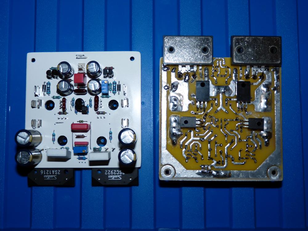

BG1-bjt Sanken progress : PCB has been drill for transistor screw and all transistors are soldered on place
Excellent job. I wish I had some sankens in stock to try them.
