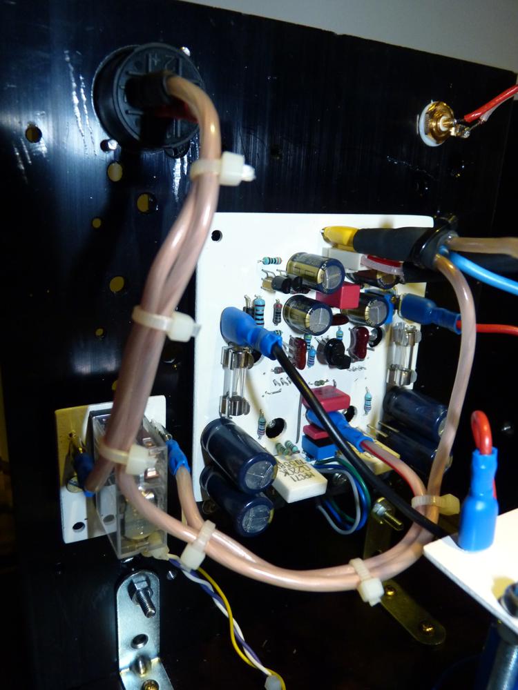

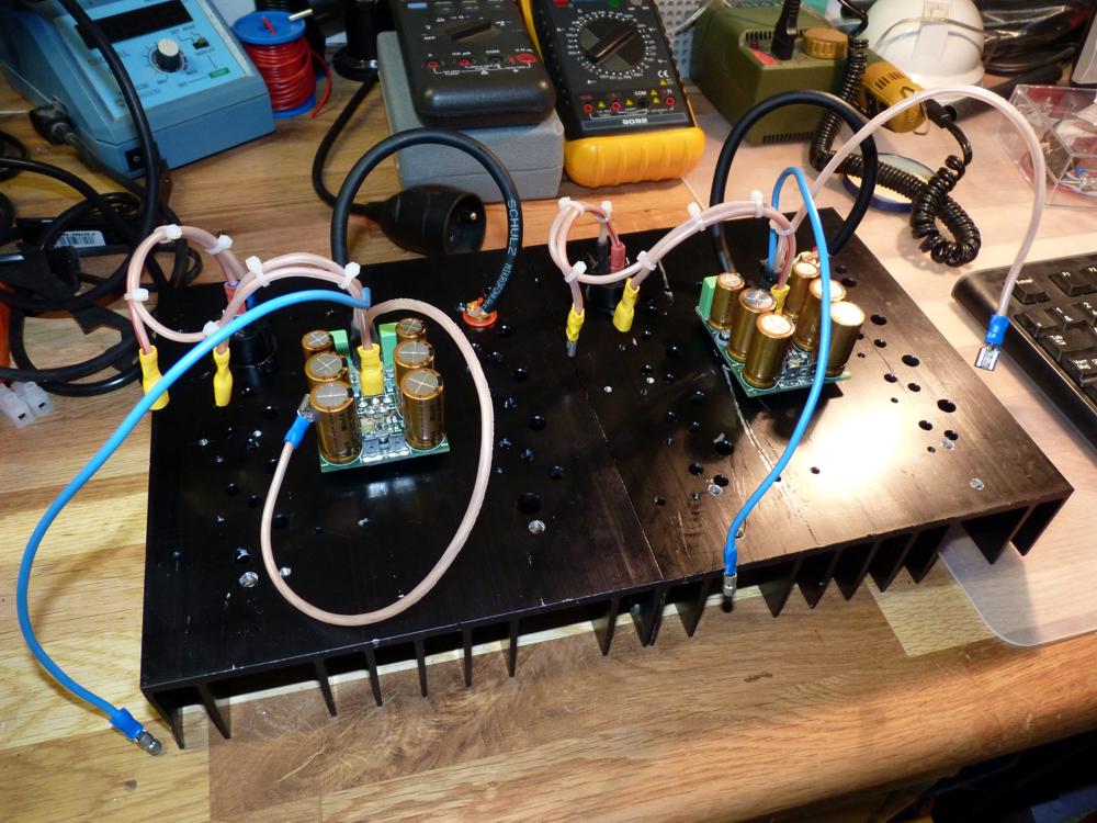

I like the use of a to-3 heat sink to install input RCA and speaker terminals :cool:
It is quite original and could even be used for final product and not only prototype..
Fab
It's why i found an easy way for the test plateform : no need to additional support for RCA and Speakon connectic. But for final product this heatsink are in to bad presentation form to be used but for test they are on top, one or two new hole doesn't matter....

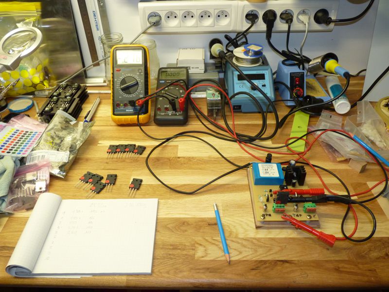

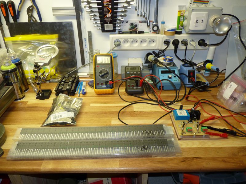

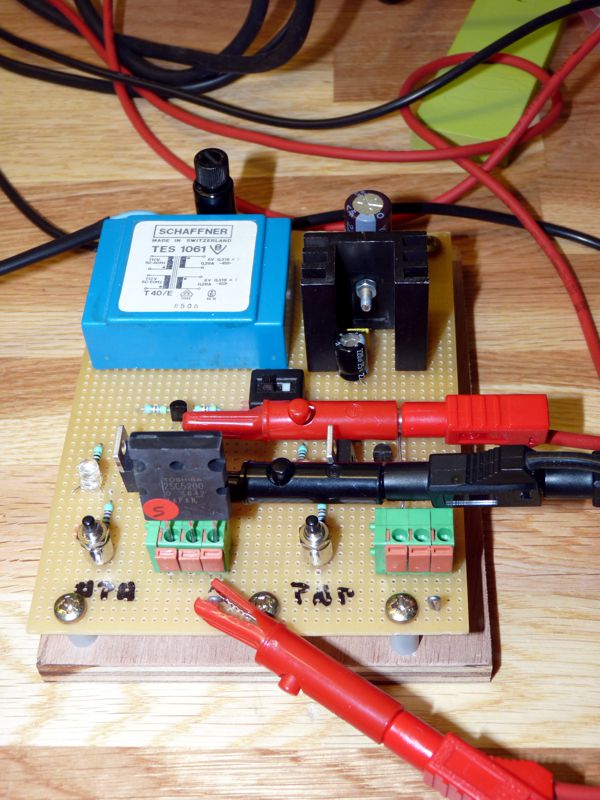

I have MJL4281/1302, MJL3281/1302, NJW3281/1302 but goe for sanken for the "mythe" that represent these transistors. BG1 was the occasion to play with 2 pairs. Due the price it's non reasonnable to use them in a build where we they are several in parallel. I even match my transistor in this case....as i my Nbip where MJL3281 were clese matched in HFE at 50mA (the 3 pictures above was sc5200/sa1943 session for a friend and before bigining 100x 3281A and 100x1302A mesure session). MJL for TSSA BIGBT are comming from this session.

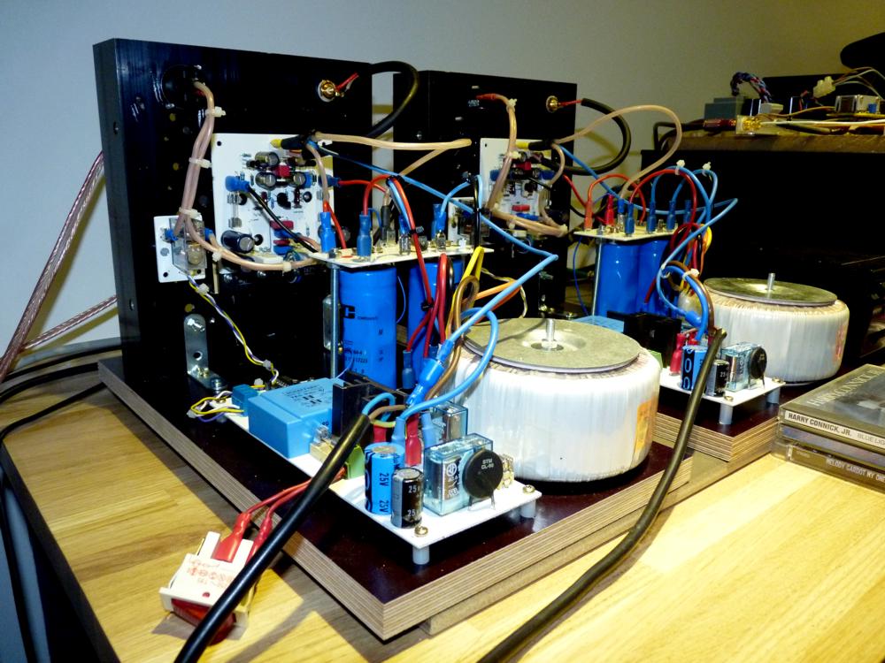

So BG1-BJT is running since yesterday all days long and what it deliever still remain as the first impressions. I had time to play many of my beloved album (Harry Conick Jr at this time), and nothing wrong appear : always a clear, detailed, airy sound reproduction with quite good bottom presentation...If i wasn't contaminated by DIY virus it could be my allday long amplifier. I think i will build a decent enclosure and it will goes to my office room at work beacause he can play really cool at low level without tiresome listening.
