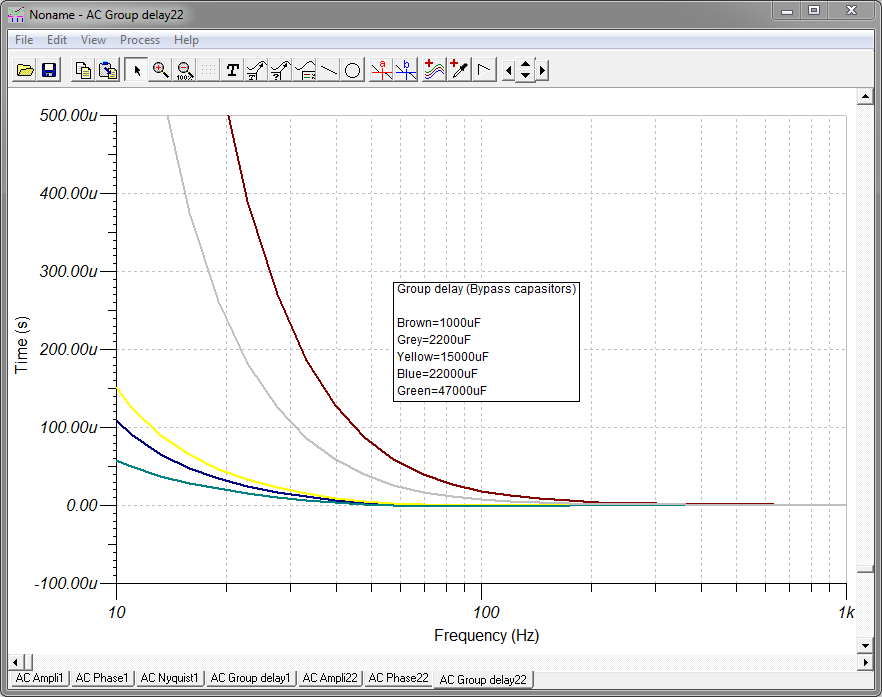

Comment on groupdelay funktion of cap if tweaked is welcome.

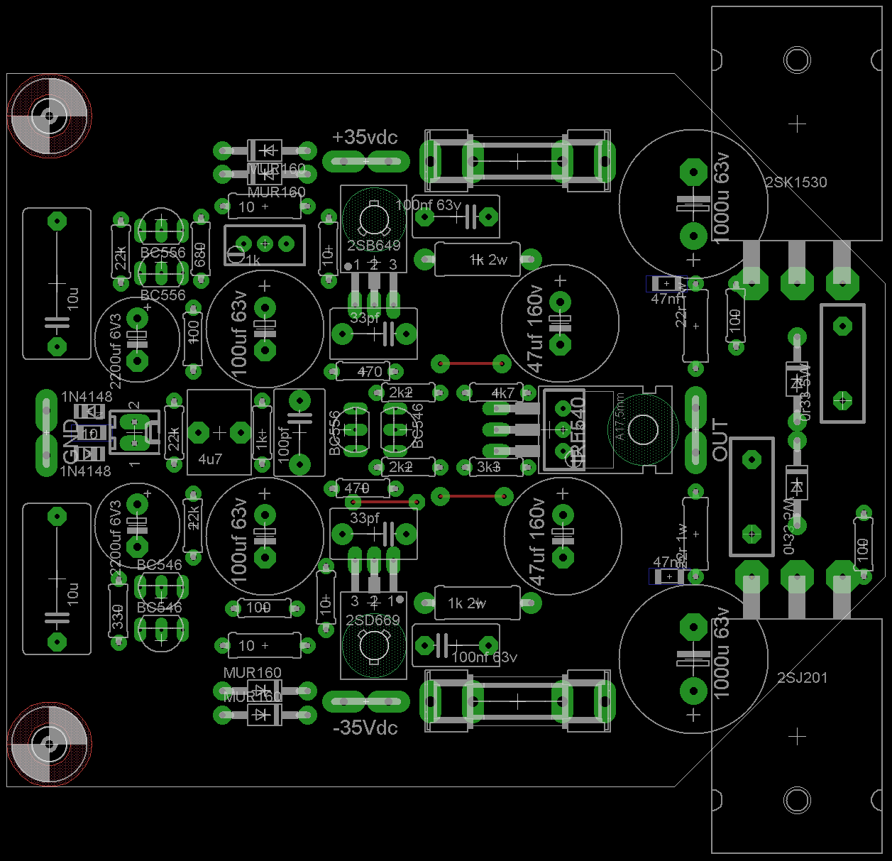

I have 4x Nichicon 2200uf/6.3V take spare when order from mouser for VSSA as 1000µF/50V...i wil try to change FC in place.
Marc
Hi Marc that would be very interesting to hear if its audible, try to listen for if Lows get lower and in theory faster/tighter bass (downside in this test is that we not use FC against FC, but FC against Nichicon think you agree). I attach picture with simulated examples of different cap values (Look at yellow line, this is possible with FC 15000uF/6.3v).I have 4x Nichicon 2200uf/6.3V take spare when order from mouser for VSSA as 1000µF/50V...i wil try to change FC in place.
Marc
One thing i care about with the slowness down there is that most speaker/box have same error Down there (even higher delays), and one error + one error = double error so could we remove one we have the haff error.
If it is audible maybe we could adopt one of those huge value (farads) storage capacitors available nowadays for making overkill-like in this position.
And last thing, at same place Andrej use 10uF bypass which i think is intended for take out the inductor effekt by large caps, so it could be a very important cap for both SQ and stability in high/ultra high band.

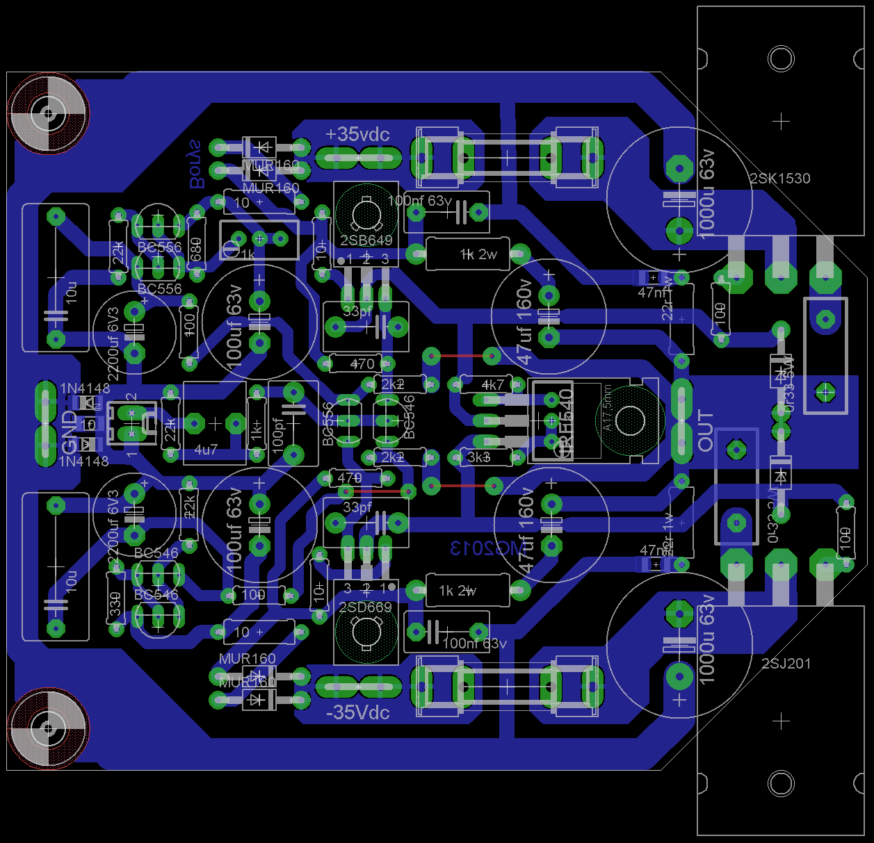

So i replug LC VSSA and i can confirm BG1-BJT have better lower presentation (more weigth, more details, more dry, driver seem to be better manage by amp in these chapter. VSSA is on the brighter side, may be a little bit "airyness" but it's realy difficult to say one is the absolute winner...If VSSA had the BG1-BJT lower frequency presentation it would be the on the top.
I think to that capa arragement could be better on BG1 : 2200uf/6v3 or more with 10uf MKT (i juste order one more set of 4), maybe the 100uf must lat place to some thing bigger....

OOOh gets boy alike and can't wait for my turn to get pakage from Andrej (because of your Words "BG1 / VSSA are over what i have built in past". To explain why i do Andrej,s VSSA first, when it arives in august, and then your BG1 is because of time issues and speaker projekt.
your "Add on note:" is lovely explanation to a music lover. I guess your narrow listening position gives headphone alike (two speakers one listener so close). I have Alpair 10.2 sealed for top and 10" bottom, and this is going to be same top and new 15" Sealed bottom. But when i run the Alpair also 2.5m alone with EQ (DigitalDomainLinearPhase) they sound very pure ala headphone, probably because of phase domain are untouched. In this senaria i melt of pure sound pleasure and like to raise volume, but the EQ for the lows would then kill the speaker. So gold with speakers is volume, and i have a fair chance to bring in the 15" and A10.2 in the same phasedomain with some untried tricks.
Seems your BG1 on top, to dig on possible reasons. Am i right all your devices are fairly/well matched, what about the Sanken. Don't think devices matched in VSSA, except Alfets if proberly produced.
If you order more caps, maybe try 15000uF/6,3v (Yellow line in post 244), or i will try later when my turn to test comes.

Sanken are not matched as the other are due their prices. Even in my 100xMJL3281 and 100xMJl1302 i was be abble to form 8 pair NP well matched imagine that with about 5 to 7€ the unit...NJW3281/1302 are indicate in datasheet as to be NPN/PNP Gain Matching within 10% from 50 mA to 5 A but is this NPN/PNP matching necessary??

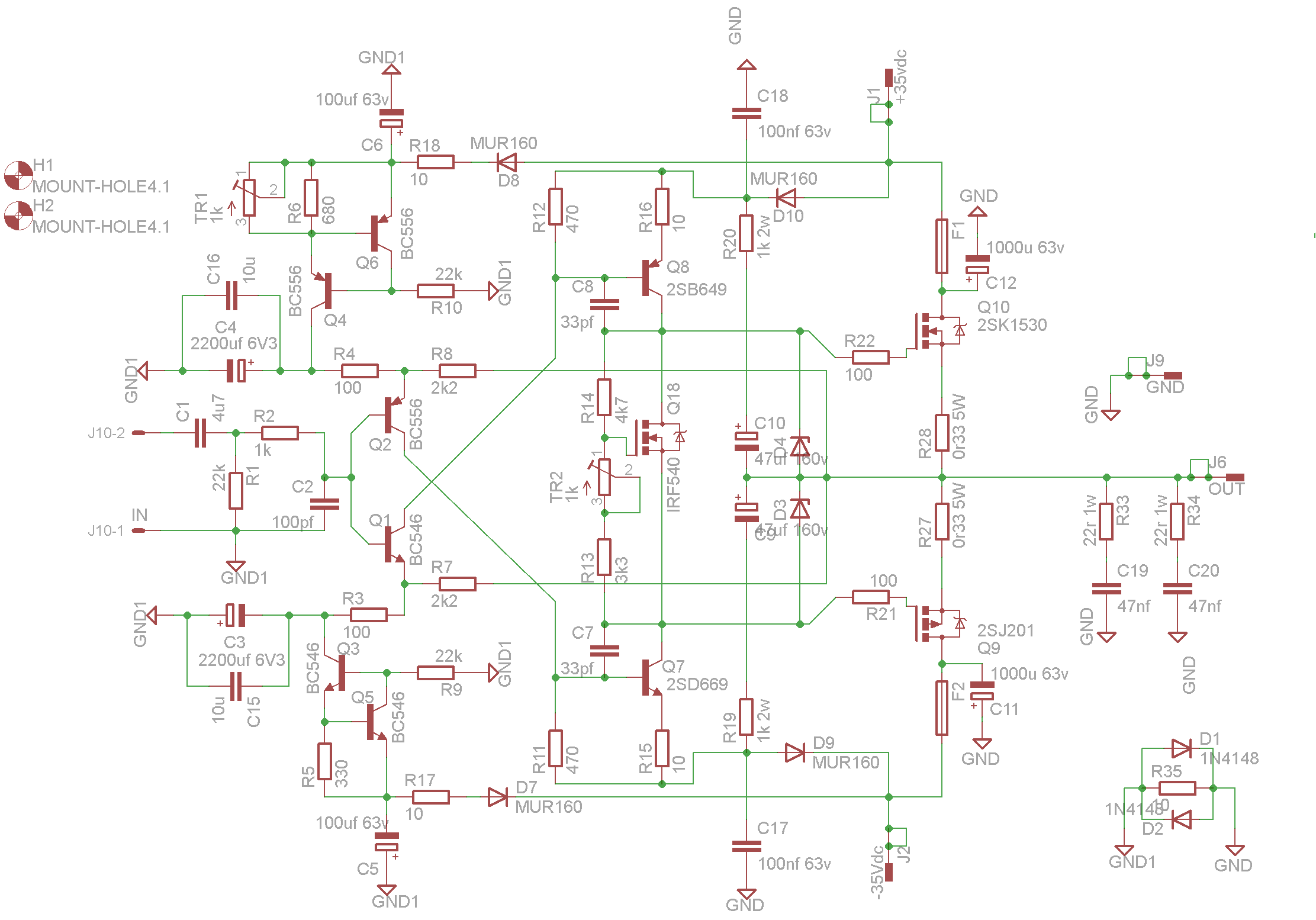

This position of the FB cap is very unique since we decouple FB from output DC current to flow and at the same time injecting operating point DC bias current for the input stage and doing it that in double, splitted FB path. This proved to be the best way also considering thermal conditions, since we are getting in the sub mV output DC offset range without the need the input pair to be matched and without the need to use any invasive DC servo to come to this superior DC offset levels. Any capacitor here insuring lowest AC voltage drop across the bandwidth is the best choice. Group delay and/or mHz (mili Hertz) range can only be realized with enormous capacitor value, measuring in F range. The good thing is that it has to be declared only to 1 V DC specs and that is perfect place to use quality memory backup caps.If it is audible maybe we could adopt one of those huge value (farads) storage capacitors available nowadays for making overkill-like in this position.
Exacly for that reason.And last thing, at same place Andrej use 10uF bypass which i think is intended for take out the inductor effekt by large caps, so it could be a very important cap for both SQ and stability in high/ultra high band.

That just proves the Lat Fets implementation also need VAS to be buffered so to use drivers and than the situation is quite different.To me LATfet in the bass area a bit shy compare to BJT, please do not think I'm against LAT fet..Just my experience.

What You think about putting another driver cascade after vas pair (as it is in bjt version of amp) ?
So instead 6 transistors we will have 8 transistors in signal track ?
And there is another thing going around my head - put j-fet input in the amp, or simple j-fet buffer just befor input.
