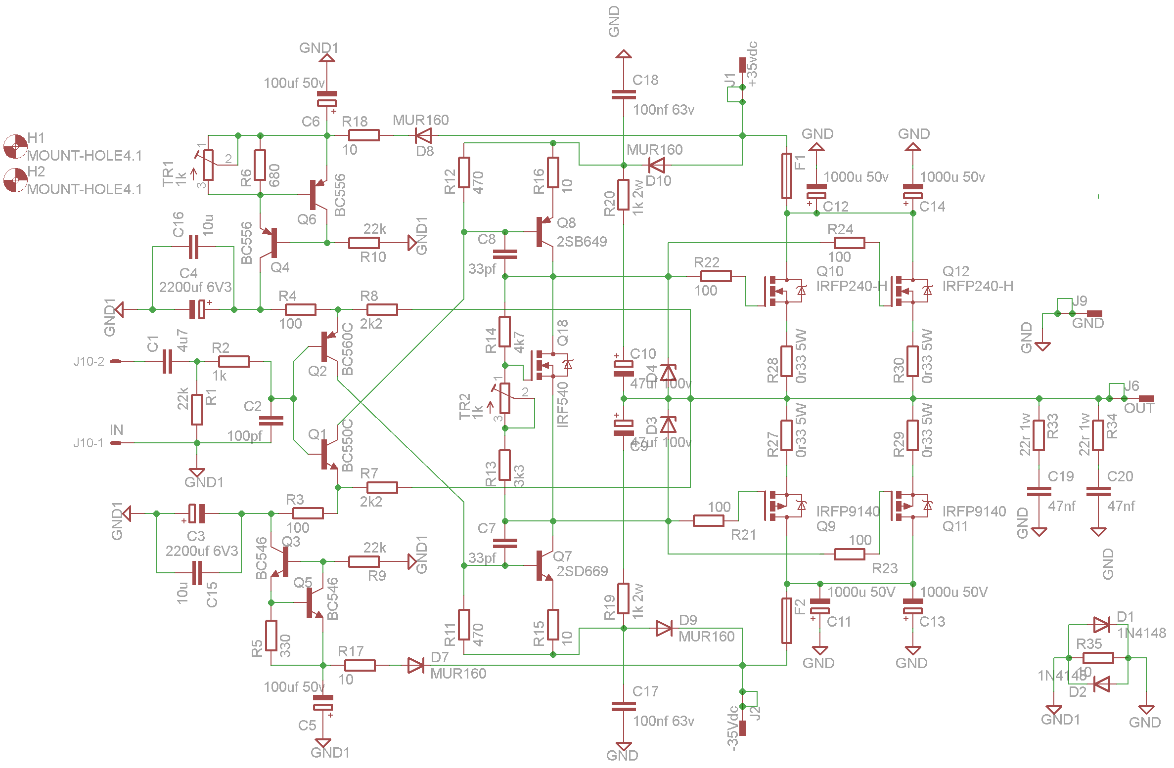

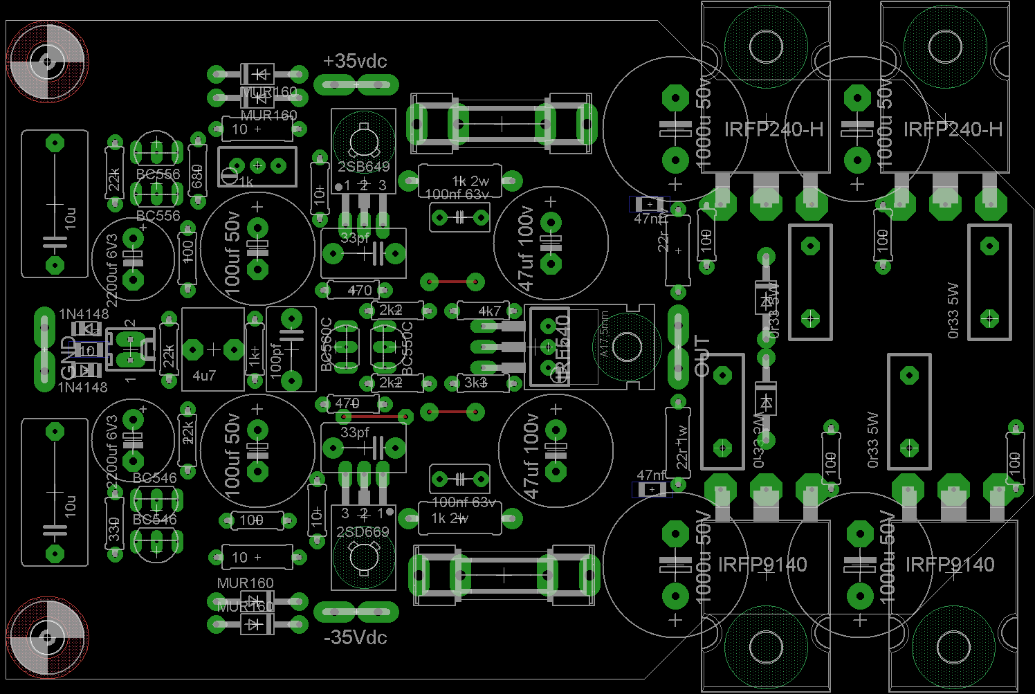

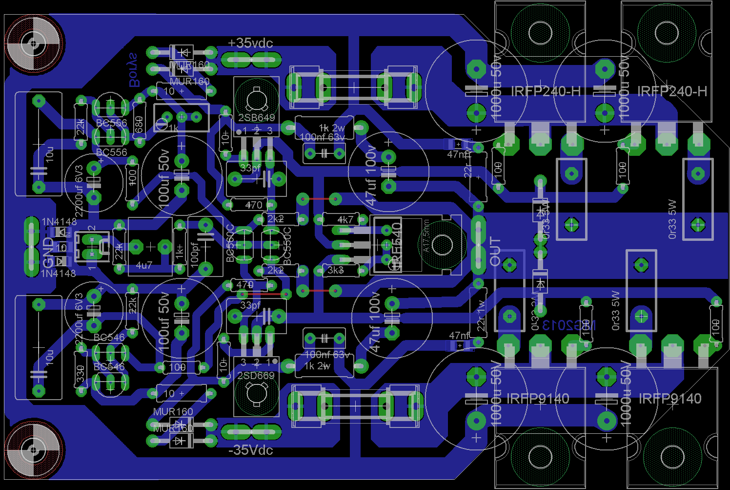

FET-hex explendit amplifier
This evening i take reverse way and swap another time from VSSA to BG1-BJT and i confirm all waht i say before except about details : Vssa gives a little more in this chapter, but it really lack comparativ BG1 in lower frequency (weight, details, articulation). So the best were a mix of two.....
So next step may be to try a hexfet version. I hesitate to go for IRFP240/9240 or to go for Toshiba 2SK1530/2SJ201 with background to be limitate to one pair due the fct they are to pricy for matching session...
Under BG2 with 2 pair 240/9240 and 10uf in // 2200uf at input stage current injection point.

Look like you are not going to use the 50V power supply, I see on your latest layout only 50V caps.

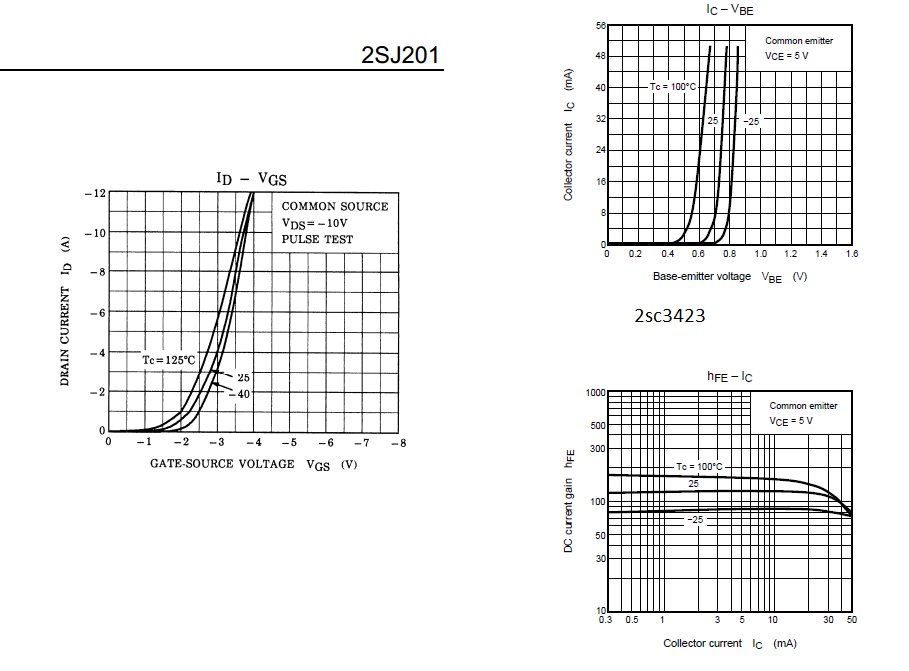

The schematic for FET-hex amp is for irfp --->ugs around 3,7V each transistor ---> biasing circuit for Toshiba mosfets has to be changed !! --> I mean resistor network cause Ugs of 2sj201/2sk1530 is lower (group O and Y have different Ugs !!).
In irfp -------> around 6,7V between gates to get bias 100mA
In 2sj/sk group Y-----> prapobly around 3,5-4V to get bias 100mA
Another point is thermal behavior.
IRFP version --> hexfet in o/p and hexfet in bias (same tempco)
2sj/2sk version --> biasing should be done by the same type of tranistor
But I do not know any siutable mosfet to do proper bias compensation in 2sj/2sk version.
Maybe BJT transistor in toshiba mosfet would be better ??

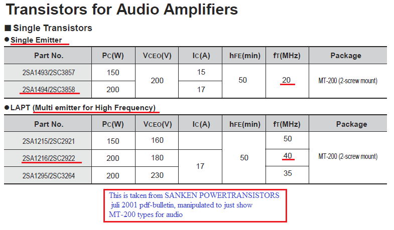

Hi Marc
I mentioned eaylier that your choosen Sanken model have multi emitter for higher bandwith performance witch i think lead to a aery sound compared to same model without and your changed types are probably standard single emitter. Think you can compare sound a bit like: multicore-wire=multi-emitter and solidcore-wire=single-emitter, i prefer the last which is same as traces on pcb, and then Again paralell=muticore-wire, serial=solidcore-wire.
Attach picture from old Sanken catalog.
BR Ricky

Hi Marc
I mentioned eaylier that your choosen Sanken model have multi emitter for higher bandwith performance witch i think lead to a aery sound compared to same model without and your changed types are probably standard single emitter. Think you can compare sound a bit like: multicore-wire=multi-emitter and solidcore-wire=single-emitter, i prefer the last which is same as traces on pcb.
Attach picture form old Sanken catalog.
BR Ricky

I just order a couple IRFP240/9240 (to keep intact my matched sextet) and 2SB649/2SD669. By the same vendor i bought 100x BC546C and will try BC546C from mixelec.
