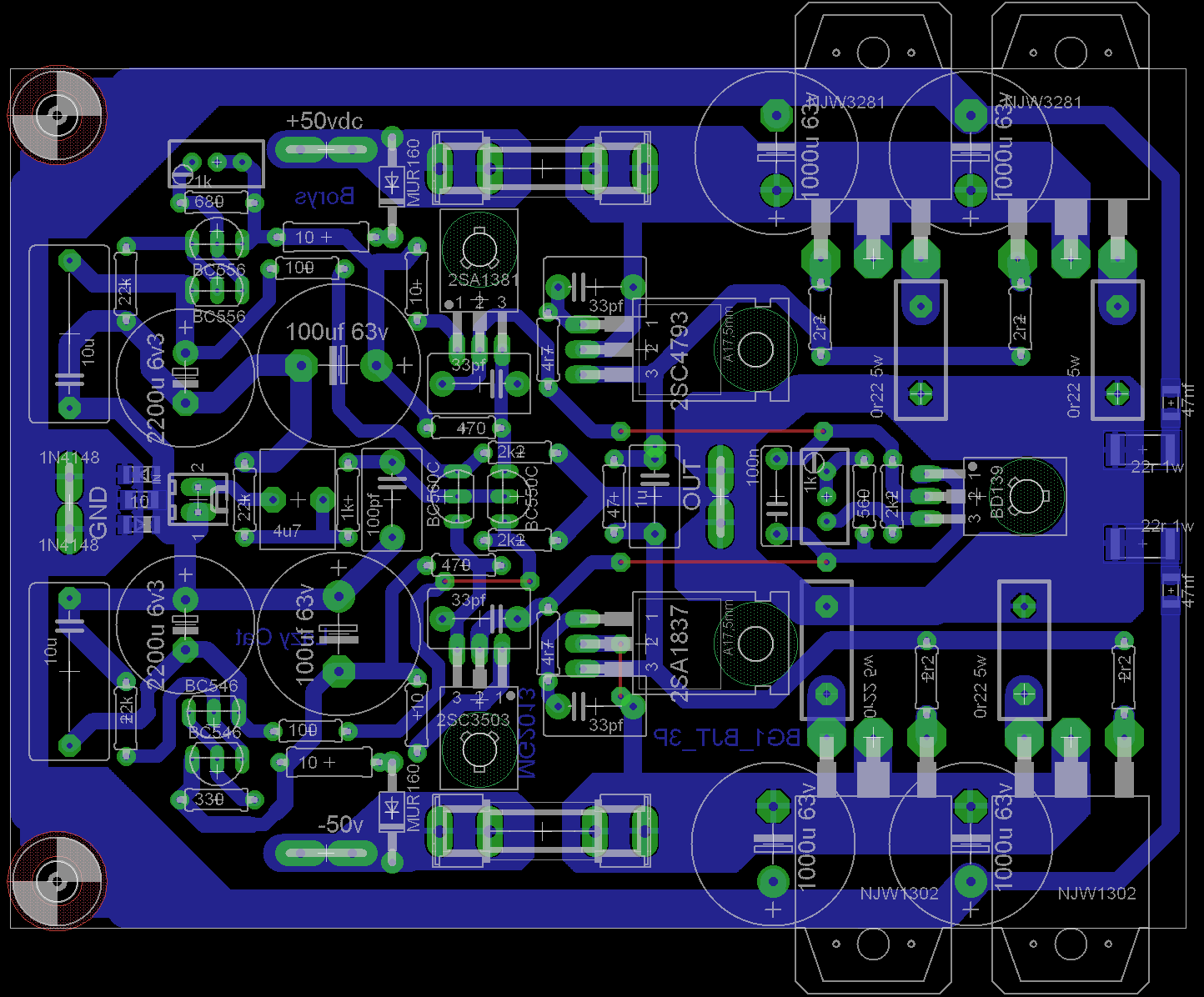

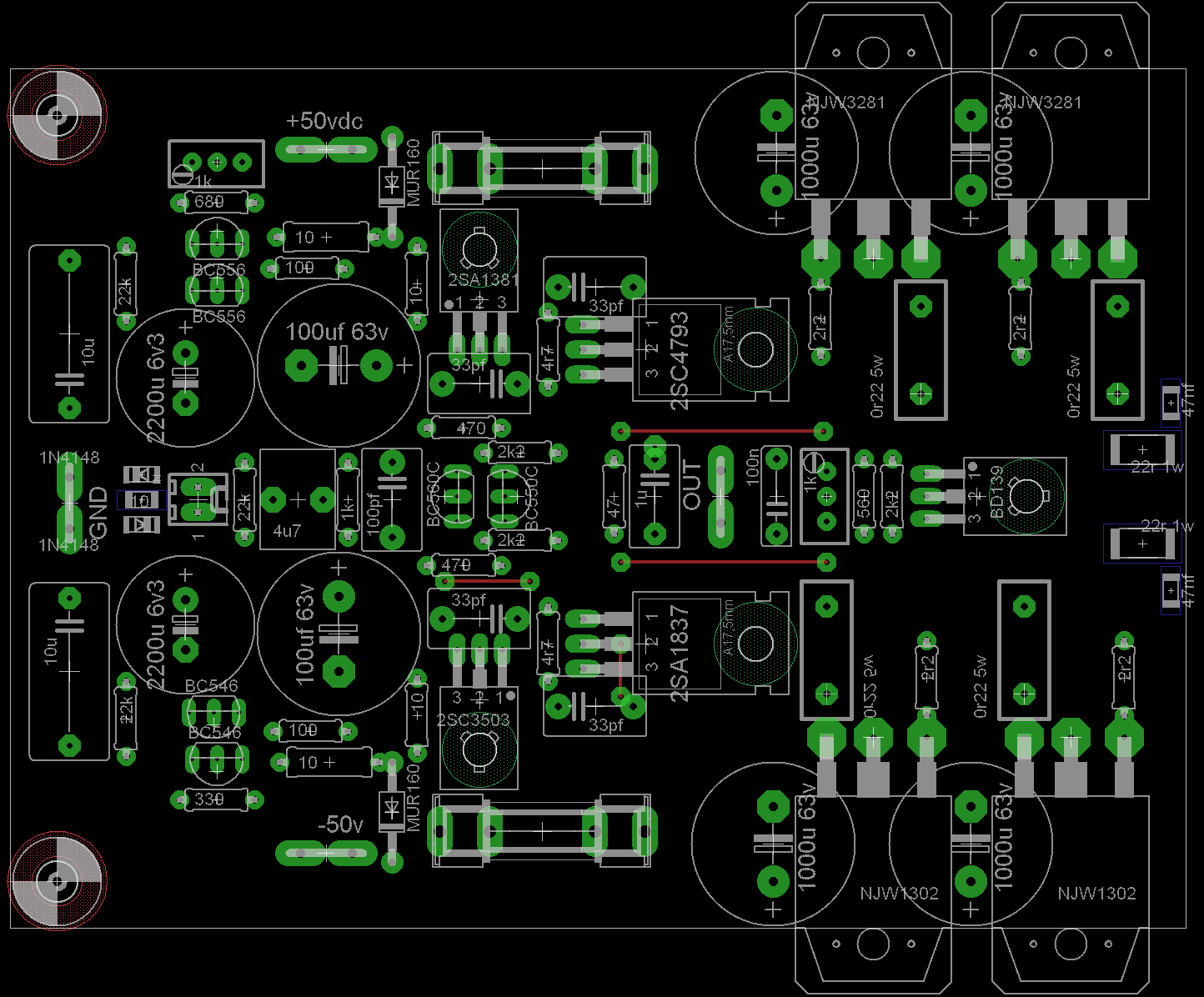

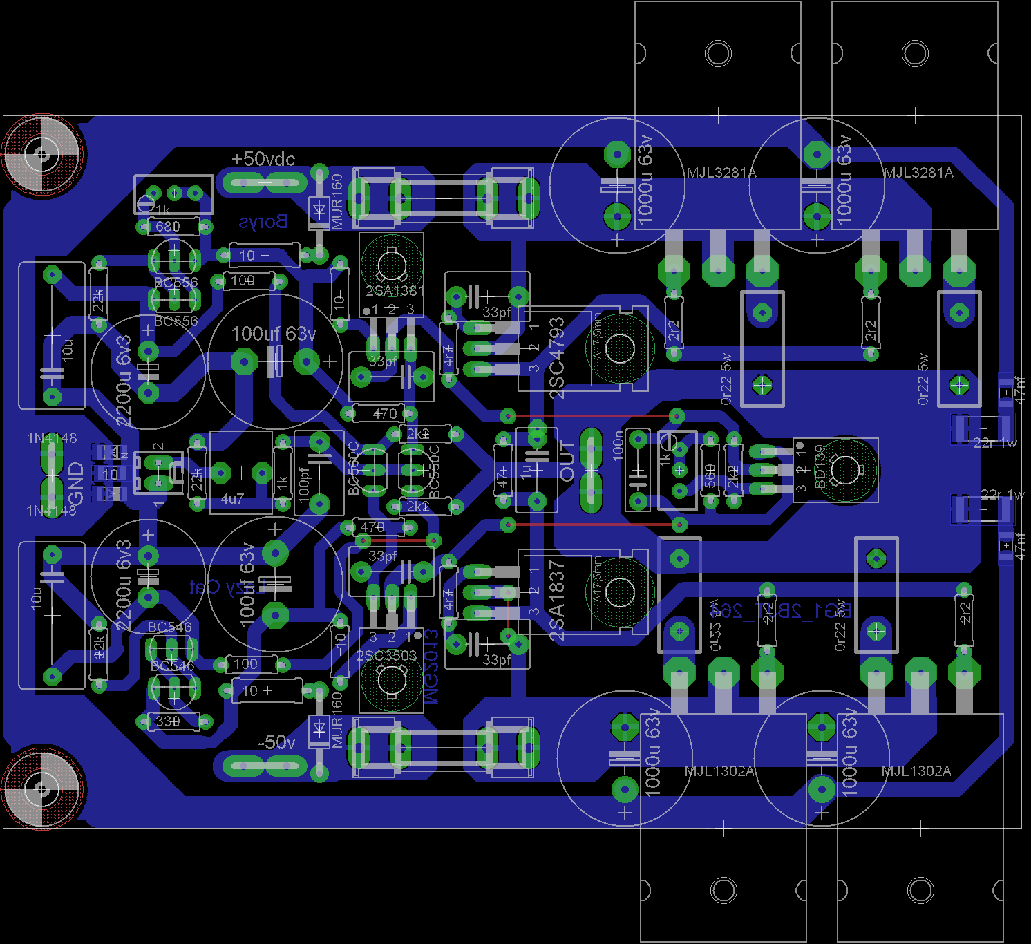

During music listening session i spend a little time with eagle to give a face to +/-50V 2BJT version...see attached. There is 2 versions : one with To264 devices (MJL) and one with TO3P (NJW)

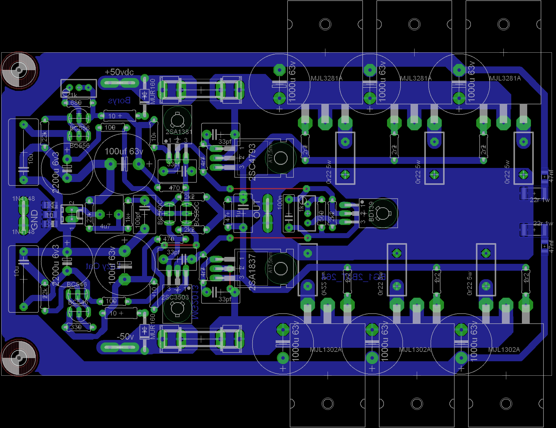

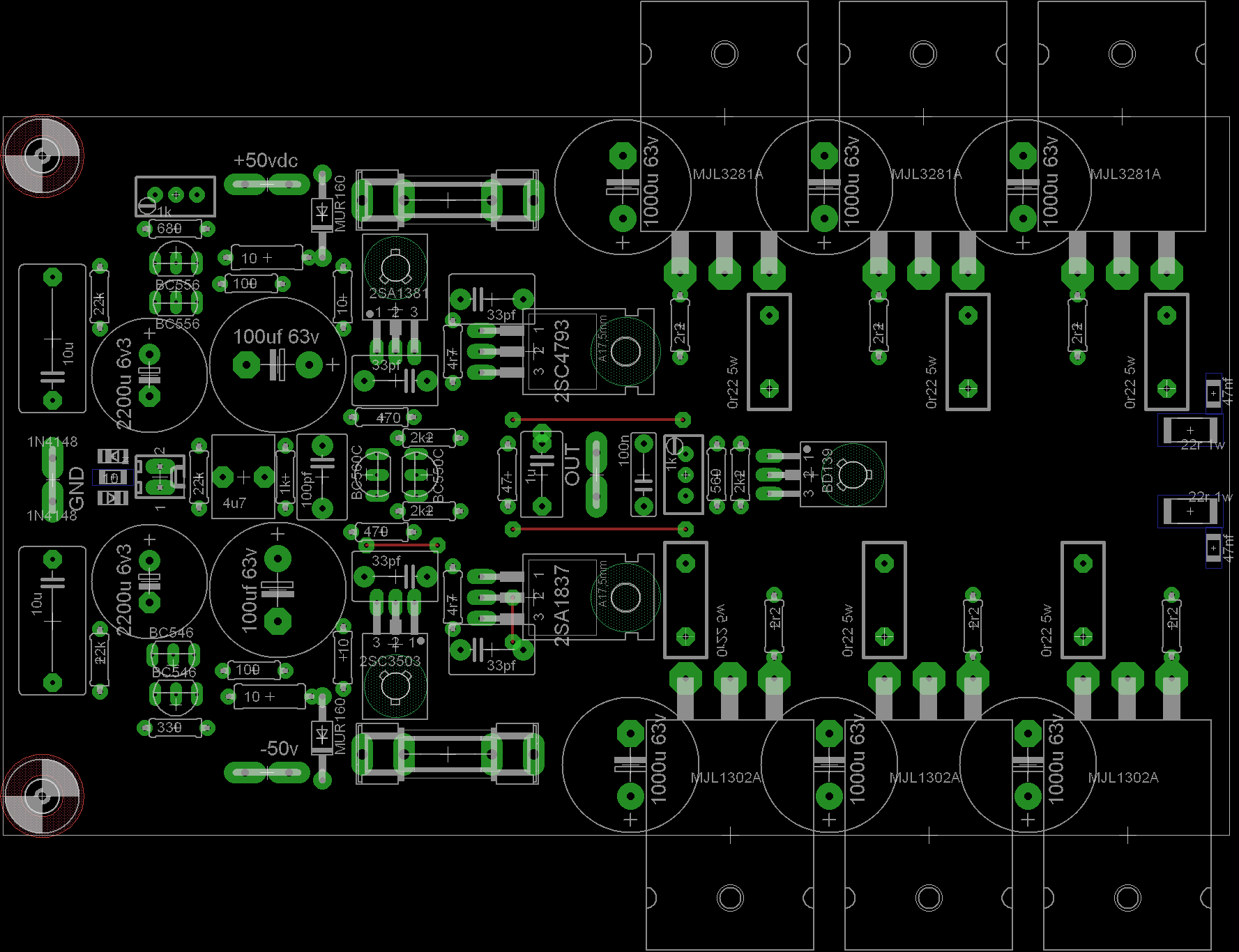

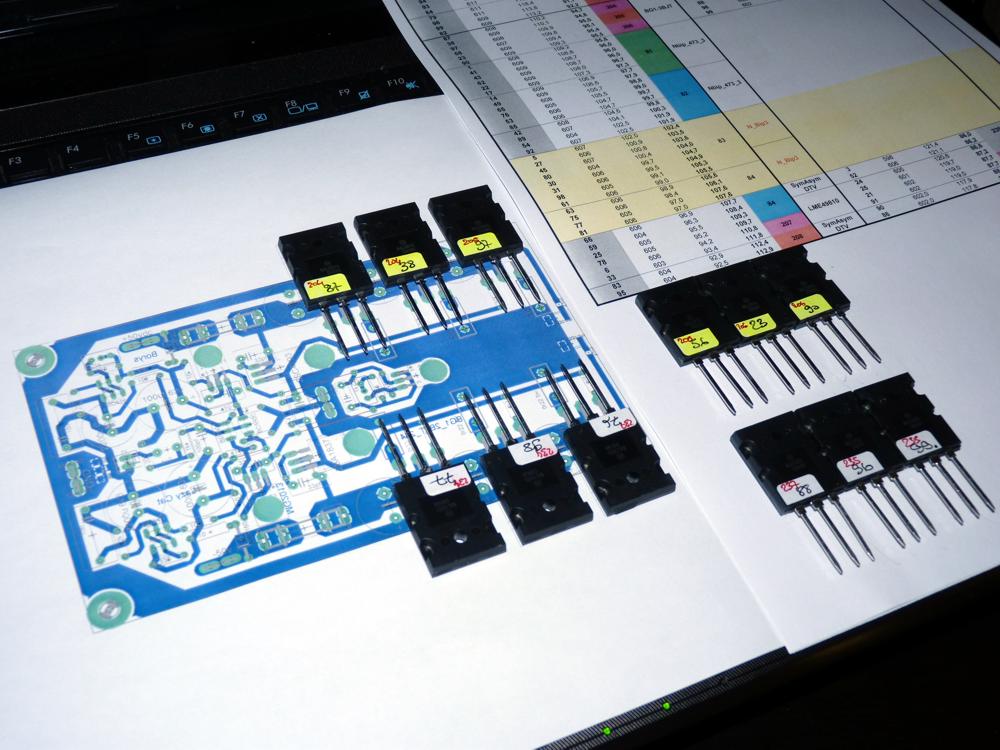

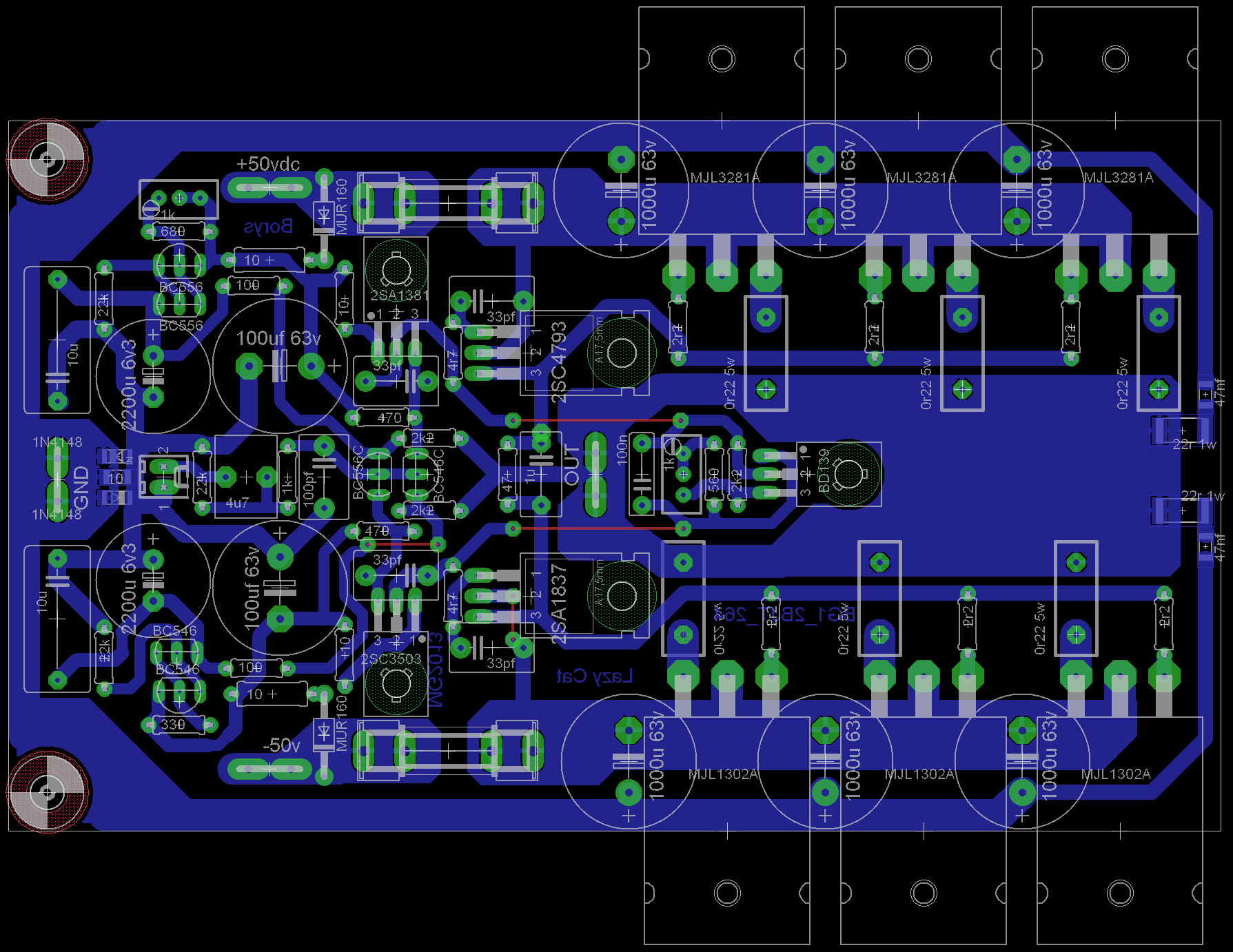

Mine will be more 3BJT version as i have good stock matched MJL3281/1302....Board size is 150x86mm

very nice layout Marc, what is dimensoin?
i'll prepare to listen bjt version
i'll prepare to listen bjt version![]()
TO3P : 120x87mm
TO264: 125x87mm
Since there is only is only 5mm difference between the two board better is to go for TO264 one more versatile beacause comptable with TO264 and TO3P
Marc

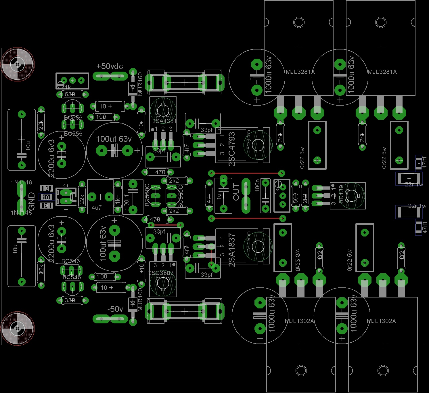

Idefixes, maybe is not bad to change the following things on the PCB:
This is what I have noticed at first glance. Maybe there is still room for improvement.

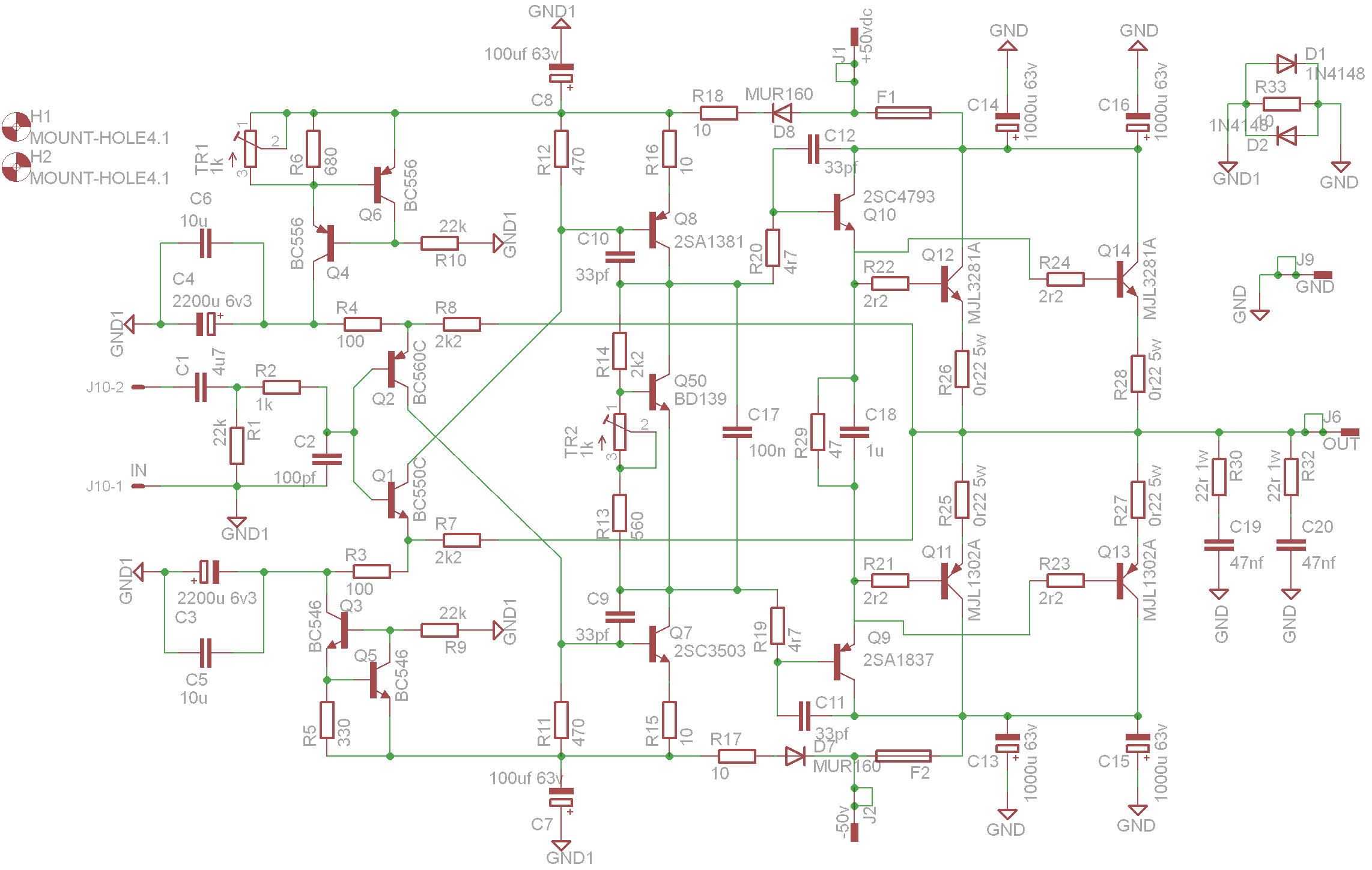

edit: Also, 22K resistor (part of CCS) should go to GND, not to GND1?
BR,
Boban
BR,
Boban
Coupling cap ground
Nice layout Marc. However, I wonder if the 100uf power supply caps ground should be better connected to GND than GND1? Or connect to GND1 before meeting 2200uf feedback caps gnd trace connection? Like a star connection for parts that connect to GND1.

Hi boban, i though to this configuration but this configuration let a bit room to plug signal connector(room due resistor). With you mod. signal connector is direct to 4u7 and his boring...my finger are not really thin...Idem for cap : when ripping to install cap. trimmer is direct near faston plug so not confortable to adjust bias....
Fab
In that way?
In that way?
Yes you are FAST! but I would even connect the 2200uf caps gnd with a separate track directly to GND1.
Fab
