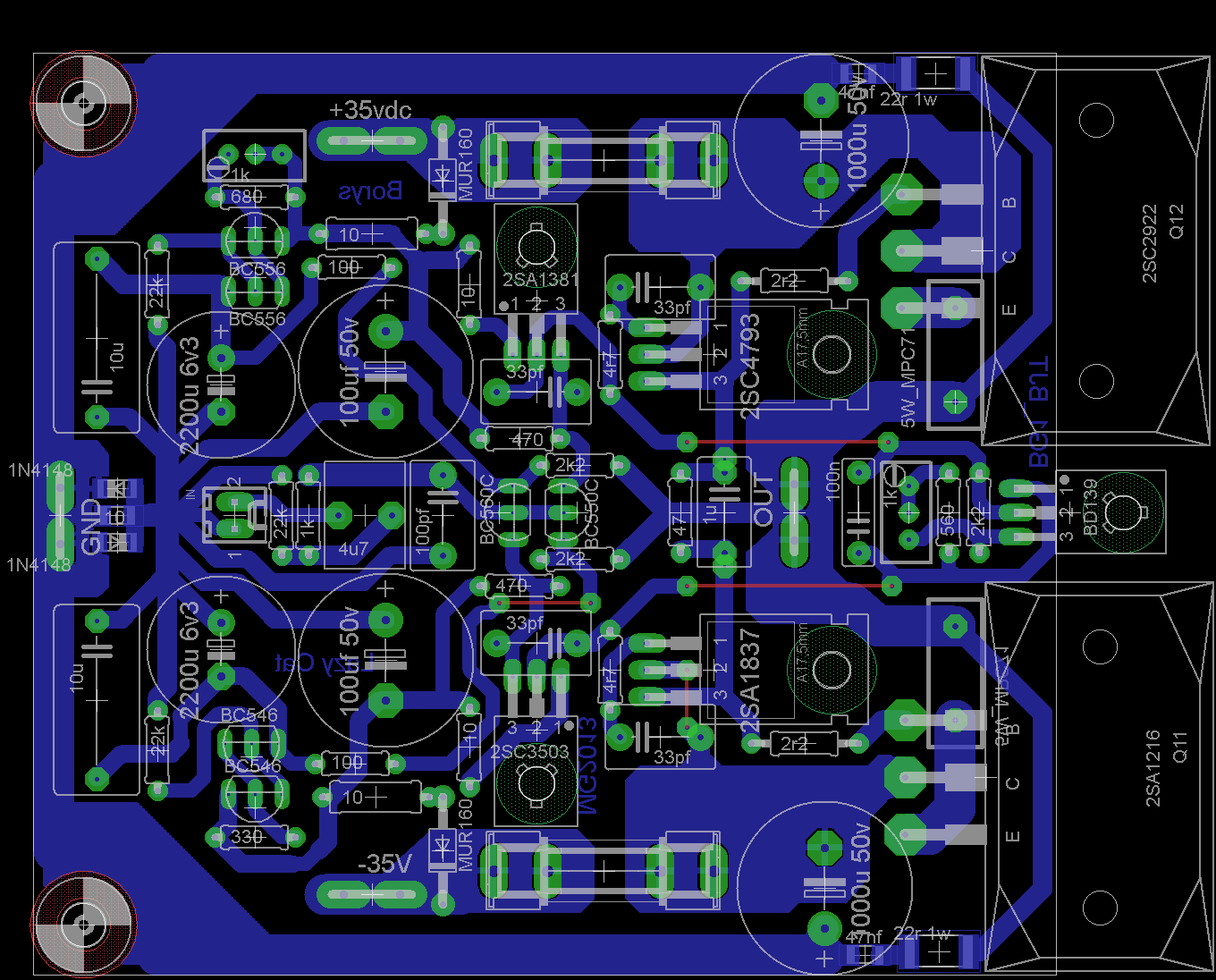

Also Same thing for the 22k input resistor gnd for separation from 100uf gnd trace.

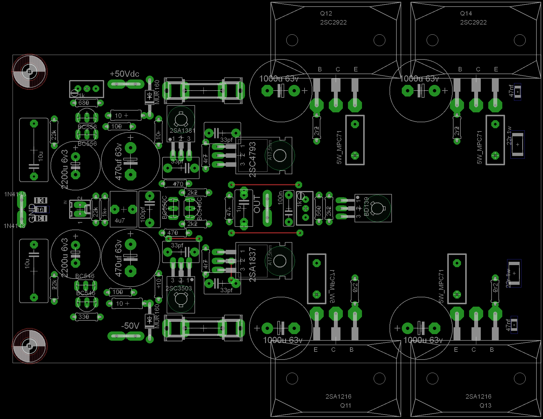

Fab
In addition, If you intend to follow Lazycat published amplifier ground connections scheme for its VsSA you may consider adding more terminals for GND connection on pcb ( for main central gnd of amplifier thus for main power supply caps gnd, zobel, speaker return gnd, etc...) or
you may prefer your main amp central gnd closer to the main power supply gnd.
I do not know if there is an accepted preferred gnd scheme be between 2 above options...
Fab
Fab
Fab
No fab with one GND faston spad i achieve all ground necessary ground connections : speaker, chassis, PSU (see the picture how i manage LC recommandations)
For supply spad i don't want them too near signal board connection...In the better case i desire GND/+V/-V connection near output section but i want apply that here i need to grown up board length...i didn't want that

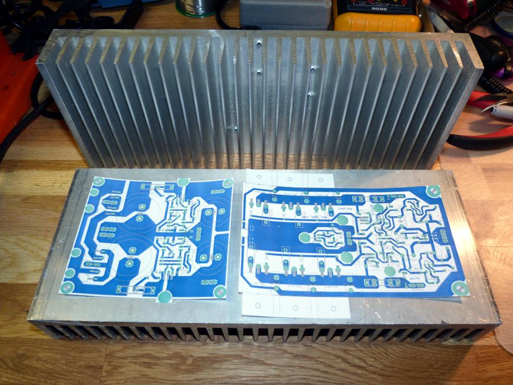

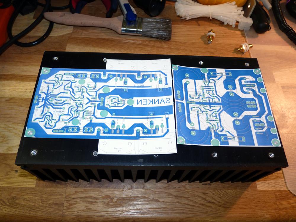

Here what i plan...as every time i can heatsink comes from rubish...i will see if they (300x120x40mm base plate 10mm) are sufficent. On what i see on BG1-BJT it would fit...
Supply board is EVIL/PMI capacitance multiplier

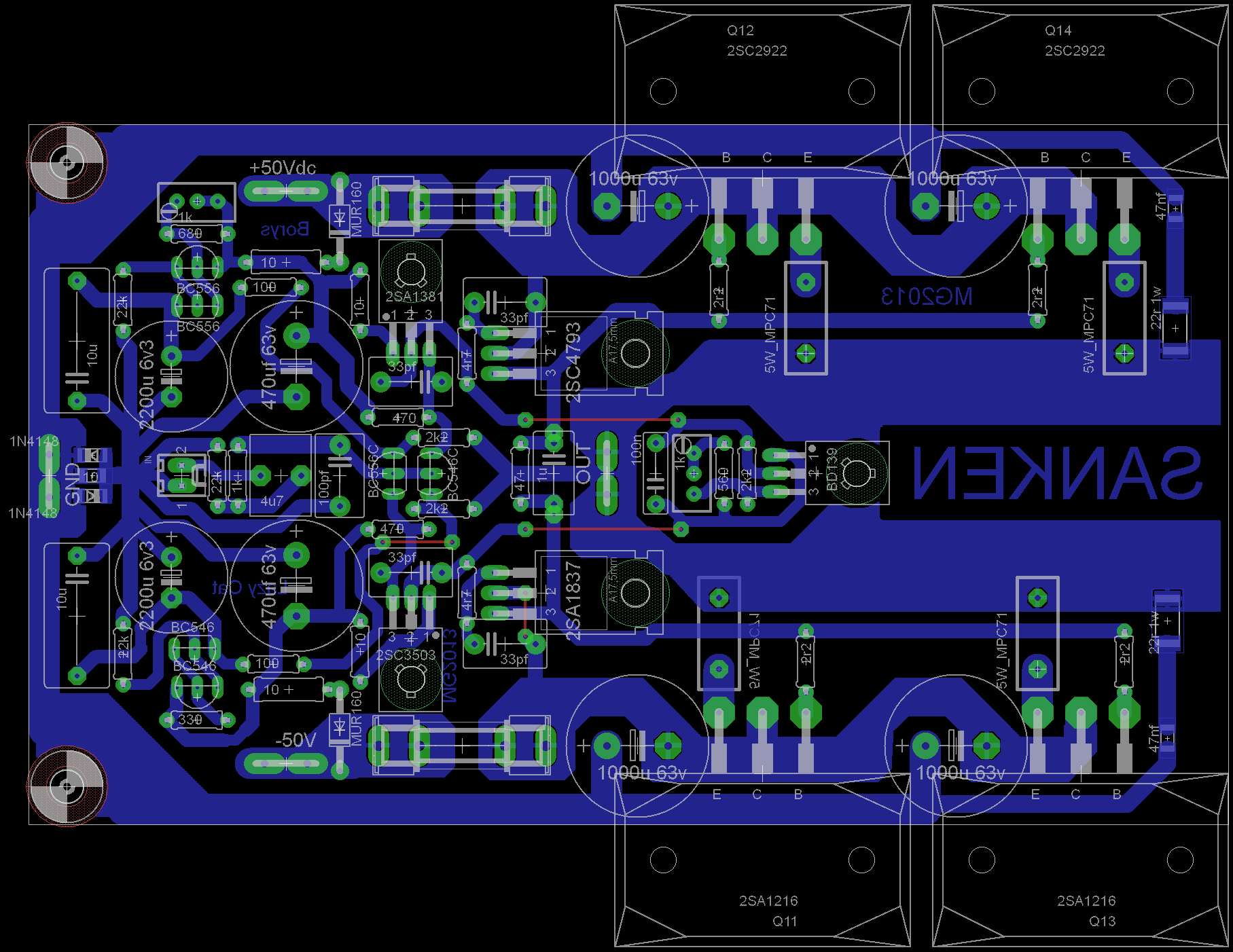

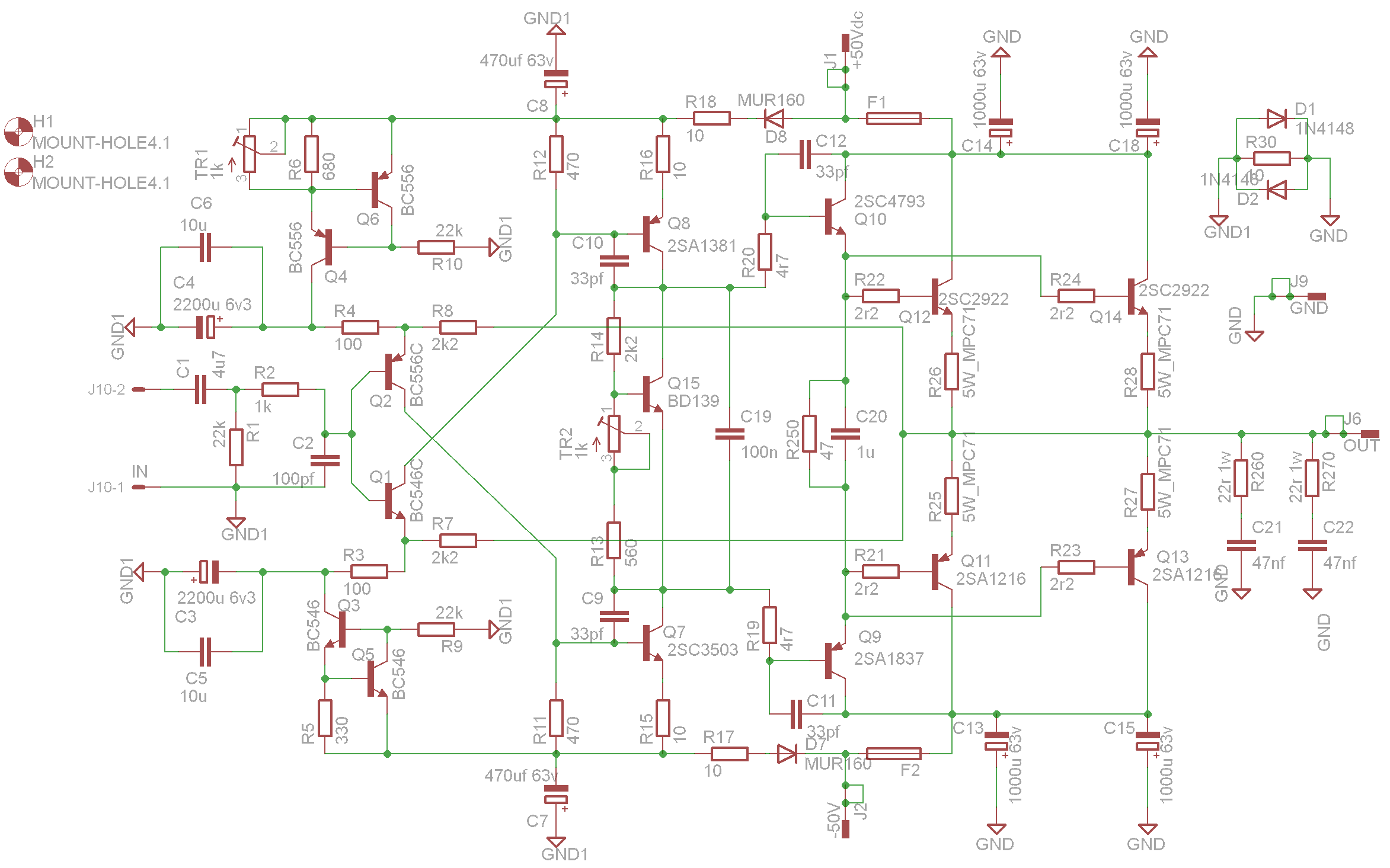

I am just thinking about universal board (just few resistor values differend), board for BJT can take o/p transistors:
-BJT
-IRFP
-2SJ/2SK
The only difference for mosfets would be another driver pair (required for BJT outputs). I have asked few posts before about adding another pair of drivers for mosfets (so we will have 8 transistors in direct signal line) - but had no response.
I will test that on wednesday (will have some time), have some 2sj201/2sk1530 in stock so why not try them on.

Funny i was thinking at somethink quite near but a little different :
=>Input board+Output board (Mosfet or BJT or Latfet)
For PSU => capacitance multiplier

BJT's,irfp, 2sk/2sj (toshiba) they have same pinout so there is nothink to modify to fitt them. Latfets they have different pinout - so different board.
THX for psu link.

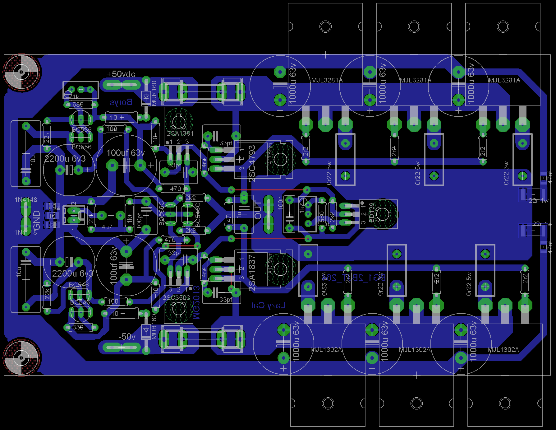

For Mosfets you don't need drivers, and for Lateral mosfets, you also don't need bias servo. But drivers with Mosfets (both lateral and Hex fet) will double the slew rate. They will just make amp better, so if there is place on pcb you can use them with any of the output transistors: BJT, Hexfet or Latfet. But you must test the stability of the amp if drivers are used.
THX for psu link.
Yes your are right...so "just need to test" Mosfet with buffer....

Some little changes on BG1-BJT sanken according members advices
-input stage ground layout
-electro caps all same orientation
-zobel resistor swap to cms 2512 package : not really satisfy due location and room around to solder..
your input stage ground layout is a lot better
![cheers :cheers: :cheers:](https://files.diyaudio.com/forums/images/smilies/cheers.gif)
I really consider using your layout now...

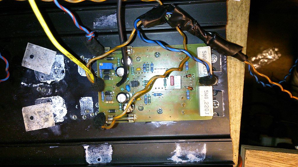

Just tu confirm, BG1 is working with fets OK. I have soldered 2sj201/2sk1530, replaced gate resistors with 100R and putted two zeners. Bias is setting up ok. At the moment I have as bias transistor bd139 and cold amp setted up to 45mA bias is dropping to 38mA after 10min playing of music (so is not too bad).
Idefixes
If you will made a room just for two zeners on the board there would be posibility to solder BJT or mosfets at output.
Sound with toshiba mosfets has really rich top end, worth every penny I have spent on them.
Idefixes
