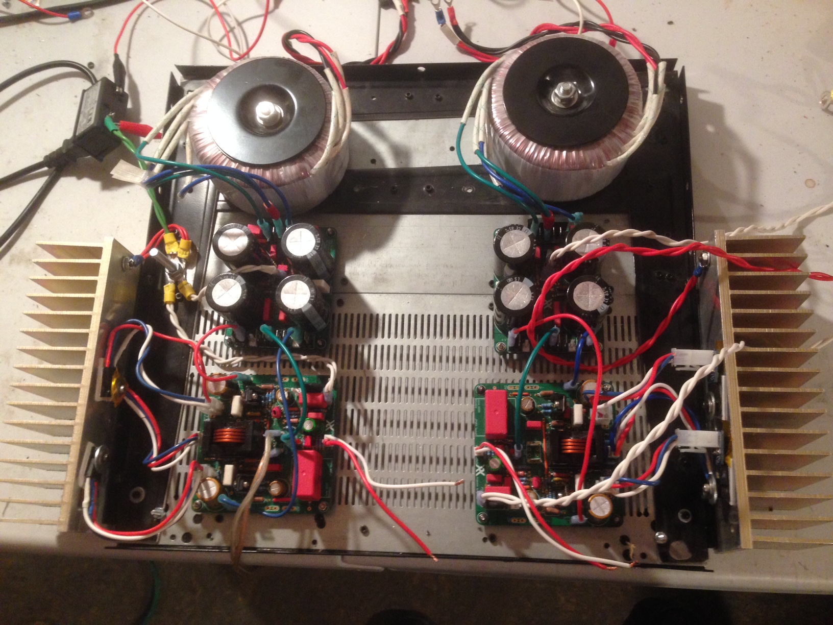

Next thing is to take a clear picture of your amp layout - top view with IEC, trafo, PSU board, soft start board etc all in view.

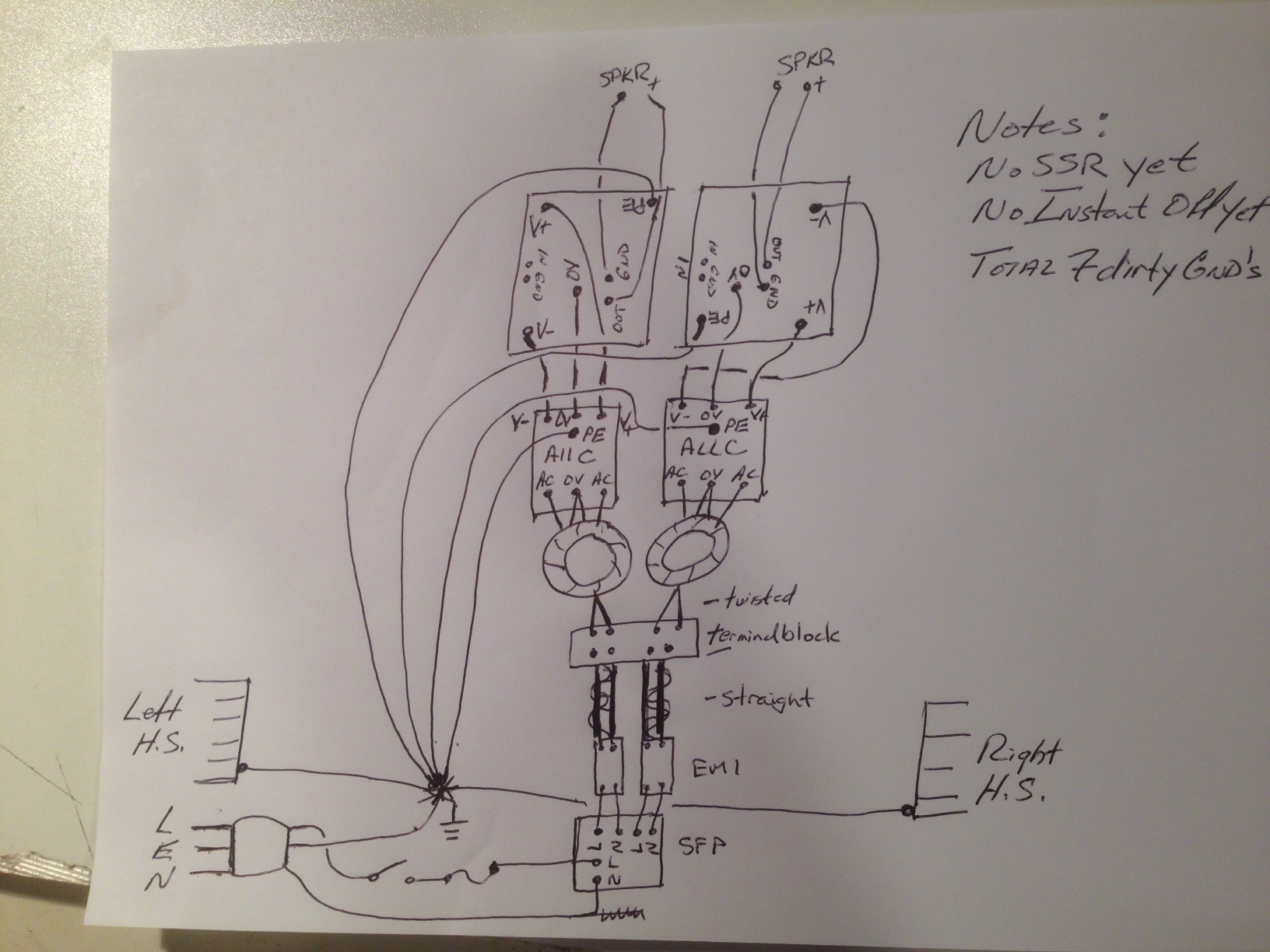

X and all, please see attached block diagram of how I hooked up everything before:

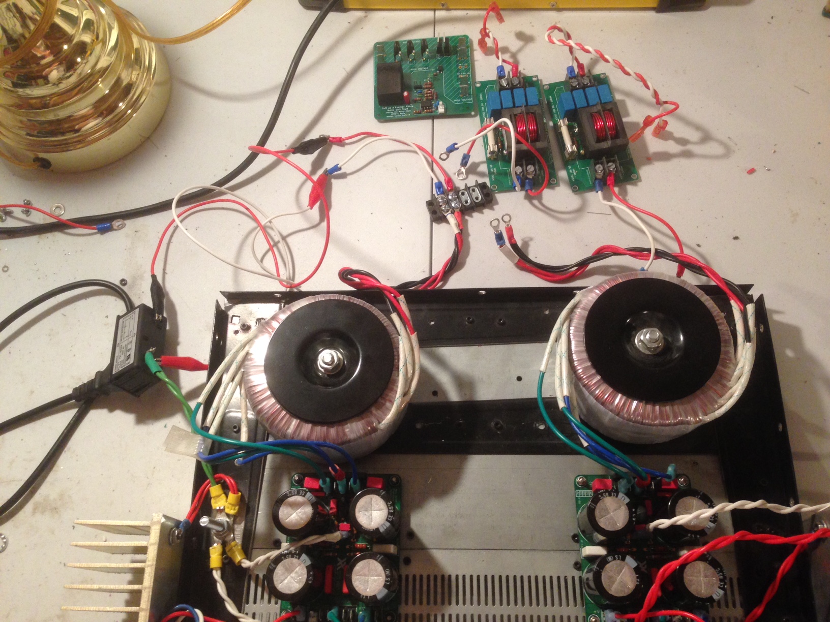

Here is a pic of the top part of wiring connections, without connections to SFP & EMI filters. Only shows connection to 1 channel.
Here is a pic of the bottom part of wiring connections, again only 1 channel connected.

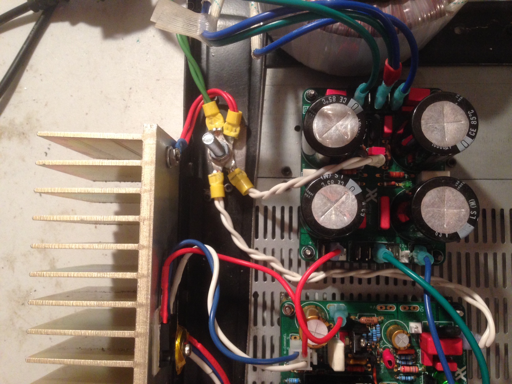

Here is a pic of the gnd post and area around the PS.
Here is a pic of the inputs and the wire connection to an rca connection. I just have it in my lap for the picture. Gnd goes to rca solder tab and In goes to the center pole on the rca connector. If I connect this and turn on power, I receive hum instantly.

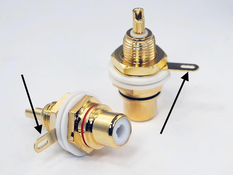

Kokanee: see the picture. You’re only grounding the (-) or signal return parts of the RCA inputs to the earth ground (star ground). You can connect both of them at the same time.
Pete

Hi Myles,
I’m trying to get a grasp on your current FH9HVX setup. Lets start from the beginning.
Both the amplifier boards and the All Cee’s PS boards have GLB’s built-in, no need to use another GLB externally.
Earth gnd from the AC inlet module attaches to a single point on the chassis(the bolt in your pic). If your heatsinks are attached to the metal chassis they should make continuous connection to earth gnd and should not need separate gnd wires to the “star” bolt. (check heatsink gnd continuity with your DMM). Connect your amp board PE and All Cee’s PE (GLB’s) to the star bolt. Which it looks like you did this already.
Never connect your sensitive signal gnd from input rca tab to dirty chassis gnd!! That will defeat the purpose of the GLB’s by bypassing them straight to chassis gnd. Alligator clips on the rca socket (signal/gnd tab) is not a good connection and could introduce all sorts of noise problems.
Also, you are building a dual mono amplifier, you don’t want to connect your signal input grounds together, they will not be separate anymore defeating the dual mono set up.
Try this, Remove the alligator clips and rca socket from the amplifier. Tie the red and white wires together, this will “short” your signal input. Then power up and check for hum/noise.

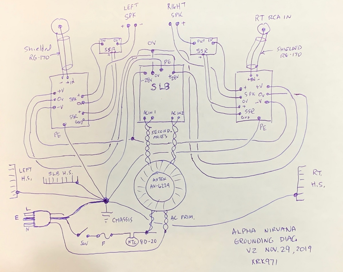

Hi Vunce, thanks for the help. I have been following the pic below as a guide for grounding and connections, and adapting to the components I am using.
If it is better to attach heatsink ground to the chassis, I can easily do this
You are correct with the PE's from PSU & Amp attaching to the star ground post.
I am going to hard connect my inlet power live and neutral connections and I will also tie the input wires together and then power up. Will keep you informed in the next couple of days, as I am playing in our golf club championship on Wed & Thurs.
