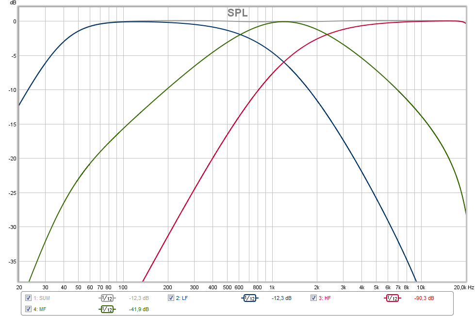

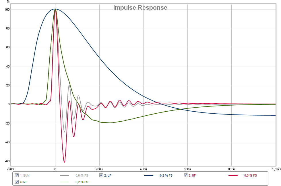

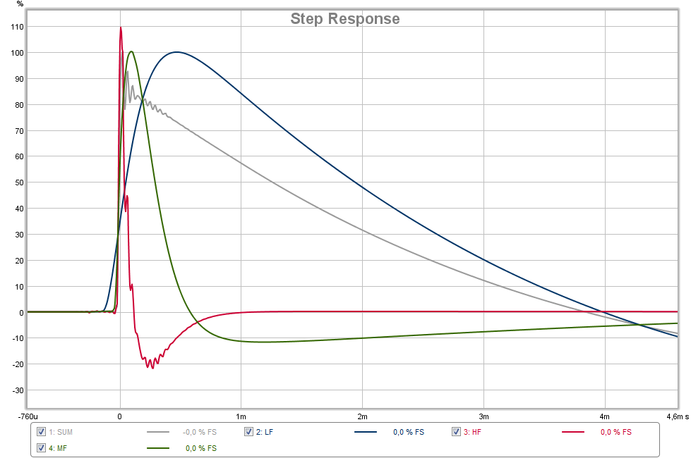

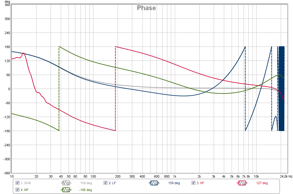

Did the same plots at Fx 1200Hz gamma 1,0 because thought they can mayby help you when calibrating your system that you have a close to same target where filters are run in a more perfect domain electric than acoustic. To see the three bandpass sections SR that sum to the triangle think can be help when trimming system one driver at a time how it approximate should look like. My soundcard probably fall off somewhere below 10Hz and HF is limited by 24kHz DAC filters when run at 48kHz sample rate and can be seen push little to slopes at HF but still very usefull.

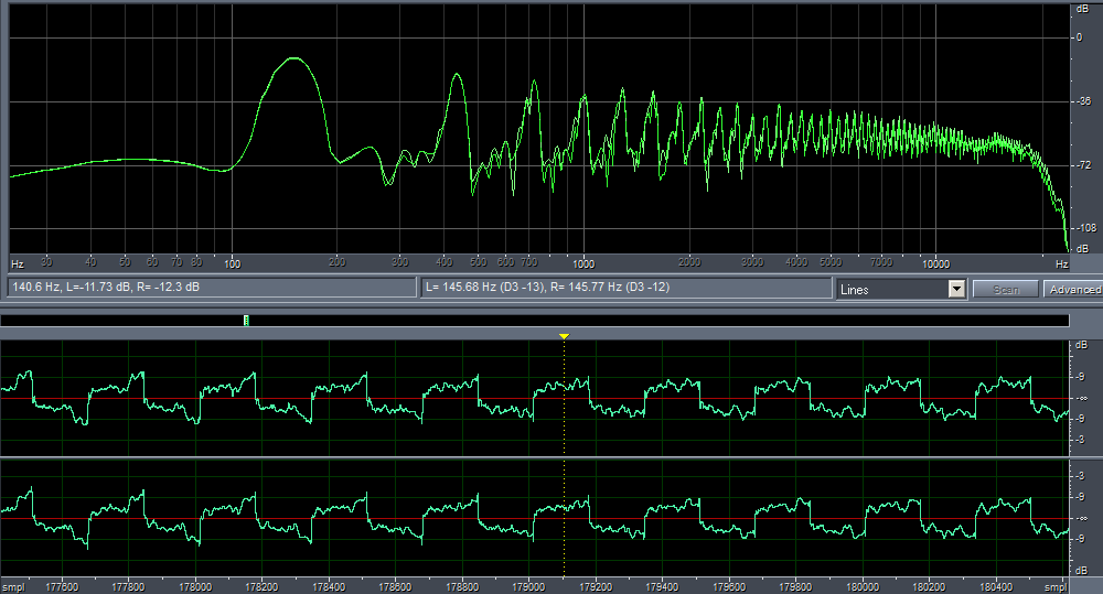

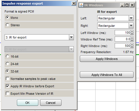

Pop up IR.wav of your last two results and I will investigate windowing and square waves with Cool Edit; only takes a couple of minutes. Export from REW with rectangular window:
File will be about 32k; just do the usual and change extension to .asc.
Ok, thanks for the offer. Here you go... 100-500ms rectangular window 32bit.

Byrtt,

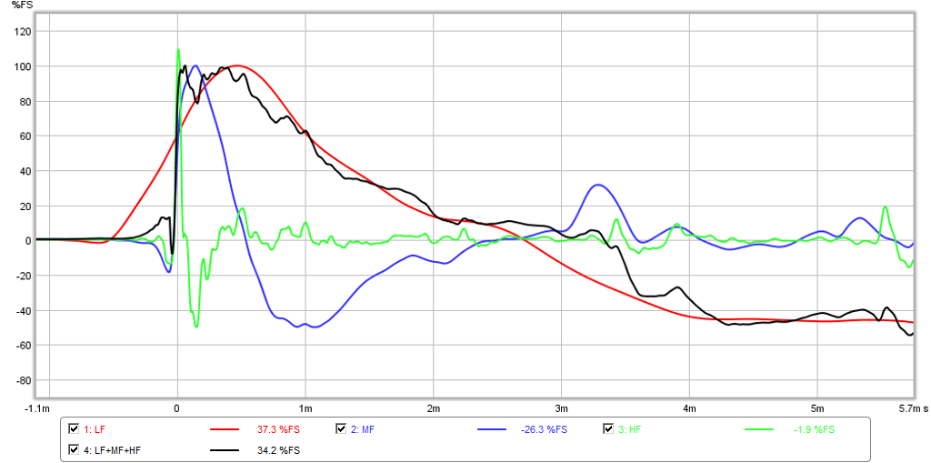

I finally figured out how to plot multiple traces of any parameter ("Overlay" plot feature) :) REW actually is a very nice fully featured plotting package in general. Nice graphs.
Your plots of the different SR's for LF/MF/HF/ALL inspired me. Here is what I have - they sort of resemble what you have.
Somebody is up way to late....
I'll put some more pics up later; but relax. You've got a really nice alignment with both variants showing extensive square wave performance in 400Hz-3.5kHz range using full IR; and lots of crisp views when reflections are suppressed.
Here is full IR convolution in 140Hz zone of swept square wave:
For measurement set up reflections/modes are sympathetic.
More later.....
Thanks the plot later in day after job time will try analyze to see if we can find some clues.
A quick comment when compare to my electric is HF at 110% MF/LF at 100% is good, but sum shall start at 100% make some very steep sawtooth (HF fall off or call it system LP) and then triangle shall first real start at aprox 85% falling off to the right. In sum that we clear can see raw LF hump turn to 100% is a error and points little to errors PLB showed us which was timing offset and amplitude lower down in slopes but its complicated setup we also have a LF and HF that where they meet in air have to cansel to get right slopes to blend with MF. That HF and MF goes too negative by over 40% i don't know but will check tonight mayby its to steep slopes or suddenly slope fall off deep low.

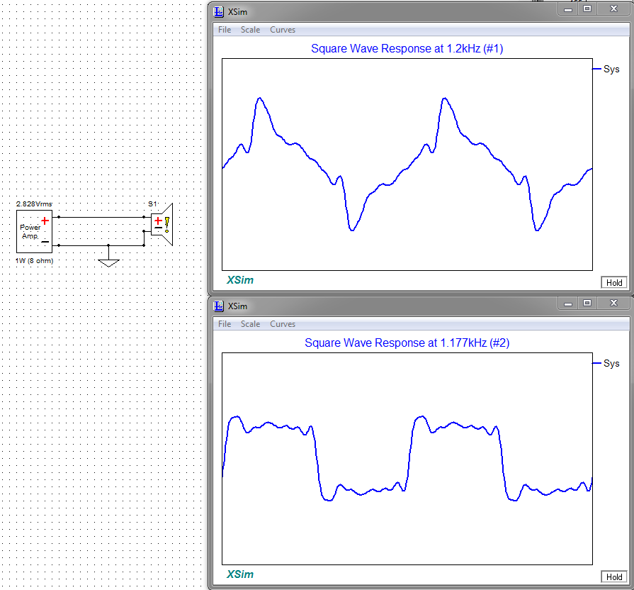

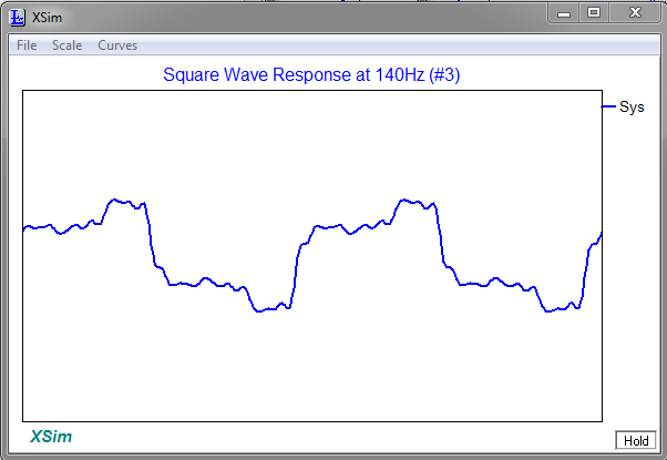

There seems to be a faster way to reveal square waves from a system that do real bench it with a oscilloscope, remember bwaslo mentioned it over your Trynergy thread. In his XSim program make simple circuit by link a ideal driver to the amp then double click the driver and link frd file from measurement of speaker. Now start the "Square Wave Response" and as default it shows 1kHz but in the "Scale" meny one can sweep up and down in frq. Took the IR-1 file you uploaded for Barleywater imported it to REW and then export a frd file to use in XSim. Below is what XSim show for the 1,2kHz you showed at post 118, but then see had you choosen 1,177kHz instead : )
attachment.php
Barleywater,
Here what XSim get out of the IR-1 file when asking a 140Hz square wave:
attachment.php

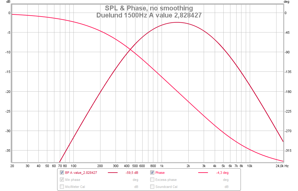

Correct me if wrong but even it has very flat phase it seems add a 360º phase turn around filler center and then add system passband ending at little >540º, where the ala B&O is linear phase only error is system passband little >180º and outside mid frq area. Below is a Duelund mid filler at 1500Hz A value 2,828427.

Byrtt,

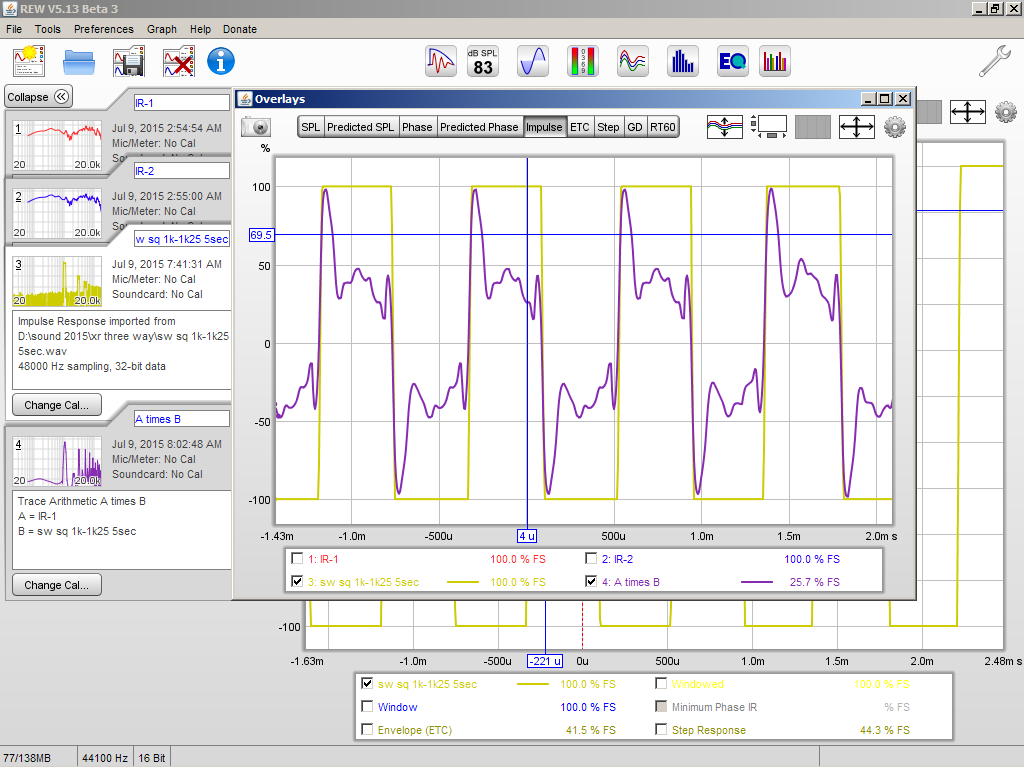

Good idea on using xsim to simulate the step response. I wonder if REW has a utility for importing a .wav file (truncated via editor program) that can do the same?
So if changing from 1.200kHz to 1.177kHz changes the result significantly, does that mean it is a reflection issue or a time alignment/phase alignment issue?
A pair of PA130-8's are on order as well as a waveguide (PRV Audio WG16-25-B) for my PRV D280Ti CD. I think I want to try to make a high efficiency "Econotransient" speaker next. WMTMW using the two Beta 12cx's, the PA130-8 for mids, and the D280Ti for the highs. Probably push central freq higher up to 2kHz, the woofers might balk...
The waveguide is a 45 deg pattern and about 6in wide with 1200Hz min XO. I am hoping it has a nice integration or blend into the 5in PA310-8's frequency response and polar pattern wise. The XO freq may need fiddling with for a good match.
Yes Mr. Virginian, REWclause has got this functionality in his Java bag:
For this square wave log sweep of 5 seconds length was generated from 1kHz to 1.25kHz in Cool Edit, saved as 32bit integer wave. This was imported into REW; various shifting and windowing is applied to get square wave set to desired location and the 'A times B' function in options of 'All SPL' view used to convolve IR-1 with square wave for display.
Various window lengths and types may be used to focus in ways that combined with multiple microphone positions allow discrimination of baffle behavior, room reflections, and effects of filters. REW's EQ functionality allows selection of devices such as miniDSP, DCX2496 and others; these filters setting may be exported, then re-imported and A times B used to see what will happen when used live. John Mulcahy has done a lot of great work with this SW development; and he has received numerous feature requests, some expressing continued development for more convenient application of EQ filters.
XSim makes use of FR representation of a system's response for a convolution result as demonstrated by BYRTT; similarly SPICE implementations allow use of external filters/signal sources for getting the goods.

Barleywater,
I am not surprised that it can be done, and great to know. I am a bit slow so can you elaborate on the process again? Why is a swept square wave needed? Sounds tricky all that shifting in cooledit. Can I apply the window on the IR-1 data to remove reflections?
