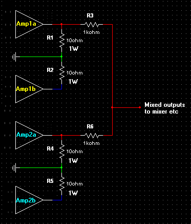

How do you sum output of 4 channels of BTL class D amps onto one resistor? The squarewave integration happens in the air with pressure waves. There may be built in phase shifts to allow acoustic signal to sum and be time aligned. I doubt electrical signals without drivers will be time aligned.

Class D BTL outputs cannot be tied together - they will short the amp and it will go into self protect and shut down.

No you can't connect the outputs together like that, but you don't need to. See my screenie for how you could safely do it. Make sure you ONLY feed around 1 Volt into the resistors, so start off with the Amp gains on Zero & measure the outputs as you slowly increase them to be sure. Also Feed the Amps with sensible signals too.
As All the equipment should be earthed, the fact that the Mixed outputs wire isn't shown with a direct earth connection to the Mixer etc, shouldn't matter ! But you could use screened cable for the mixer input, & ONLY connect the screen to ONE of the Amps earths, but leave the other end of the screen to the mixer UNCONNECTED.
I've just shown 2 x BTL Amps connected, but you can connect more. Duplicate the resistors on more Amps as on Amps 1 & 2, & connect the 1K's together @ the central point.

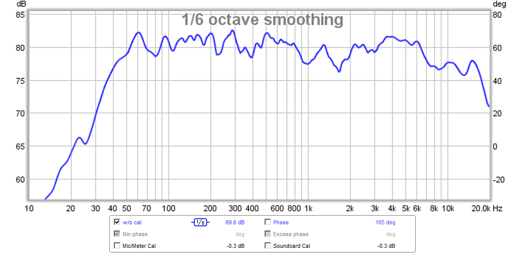

Without touching any DSP setting, I moved the speaker out into the main rec room about 6x bigger (50 ft deep, 35 ft wide, irregular shaped with carpet and furniture, same 8ft ceiling. I placed a sofa cushion on floor between mic and speaker, draped curtains on tripod legs, and placed away from walls at 45 deg angle. Here are repeated measurements of frequency response, impulse and step response, and harmonic distortion referenced to 90dB at 1m. I checked for the effect of having the mic cal file included and not included in the sound card setup - it makes no difference probably because the sound skips the sound card as USB mic is used.
Frequency response is much better than I expected, looks like tweeter can use some more power or more efficient tweeter, but bass uniformity is excellent:

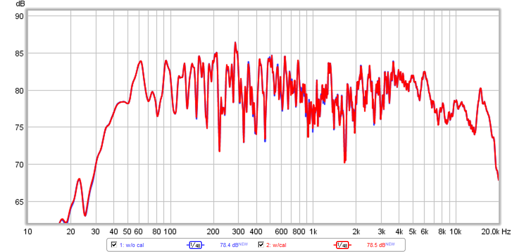

Here is the with mic calibration and without mic calibration file on sound card:

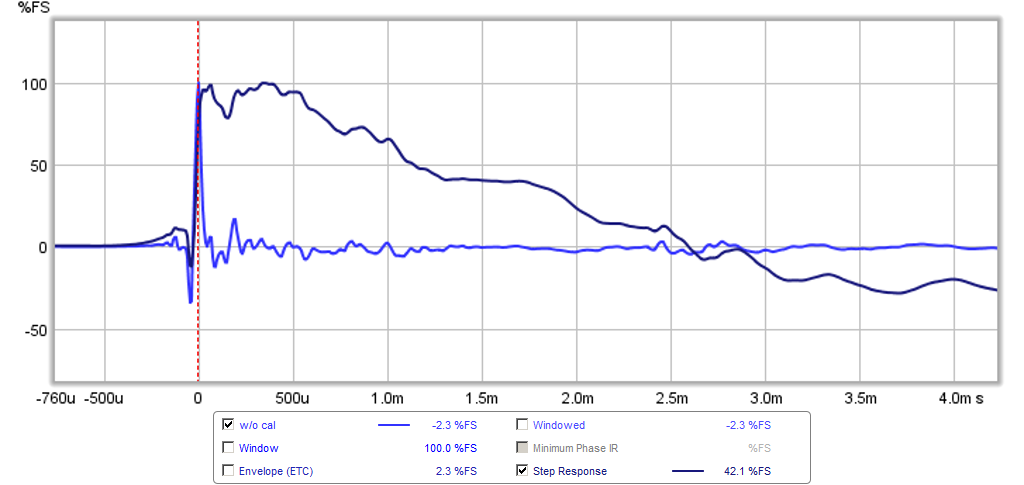

Here is impulse and step response:

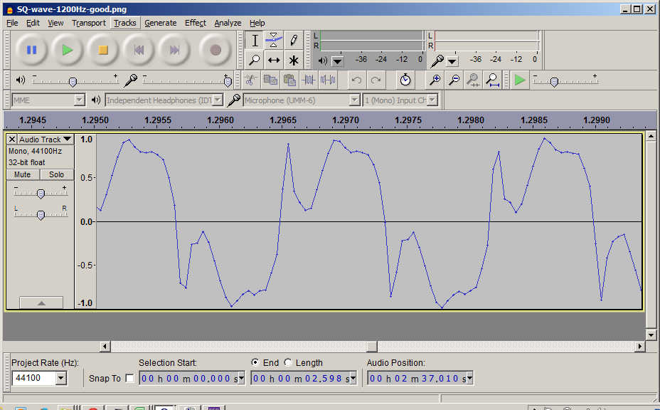

Here is a 1200Hz square wave as recorded with Audacity and using same USB mic:

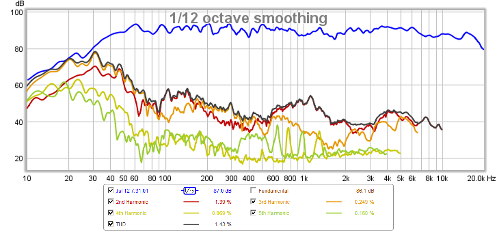

Here is HD at 90dB and 1m:

![493176d1436702936-filler-driver-ala-b-o-b-o-big-room-fr.png](https://www.diyaudio.com/forums/attachments/multi-way/493176d1436702936-filler-driver-ala-b-o-b-o-big-room-fr.png)
![493184d1436703396-filler-driver-ala-b-o-b-o-big-room-fr-cal-vs-nocal.png](https://www.diyaudio.com/forums/attachments/multi-way/493184d1436703396-filler-driver-ala-b-o-b-o-big-room-fr-cal-vs-nocal.png)
![493177d1436702936-filler-driver-ala-b-o-b-o-big-room-ir-sr.png](https://www.diyaudio.com/forums/attachments/multi-way/493177d1436702936-filler-driver-ala-b-o-b-o-big-room-ir-sr.png)
![493179d1436702936-filler-driver-ala-b-o-b-o-big-room-squarewave-1200hz.png](https://www.diyaudio.com/forums/attachments/multi-way/493179d1436702936-filler-driver-ala-b-o-b-o-big-room-squarewave-1200hz.png)
![493178d1436702936-filler-driver-ala-b-o-b-o-big-room-hd.png](https://www.diyaudio.com/forums/attachments/multi-way/493178d1436702936-filler-driver-ala-b-o-b-o-big-room-hd.png)

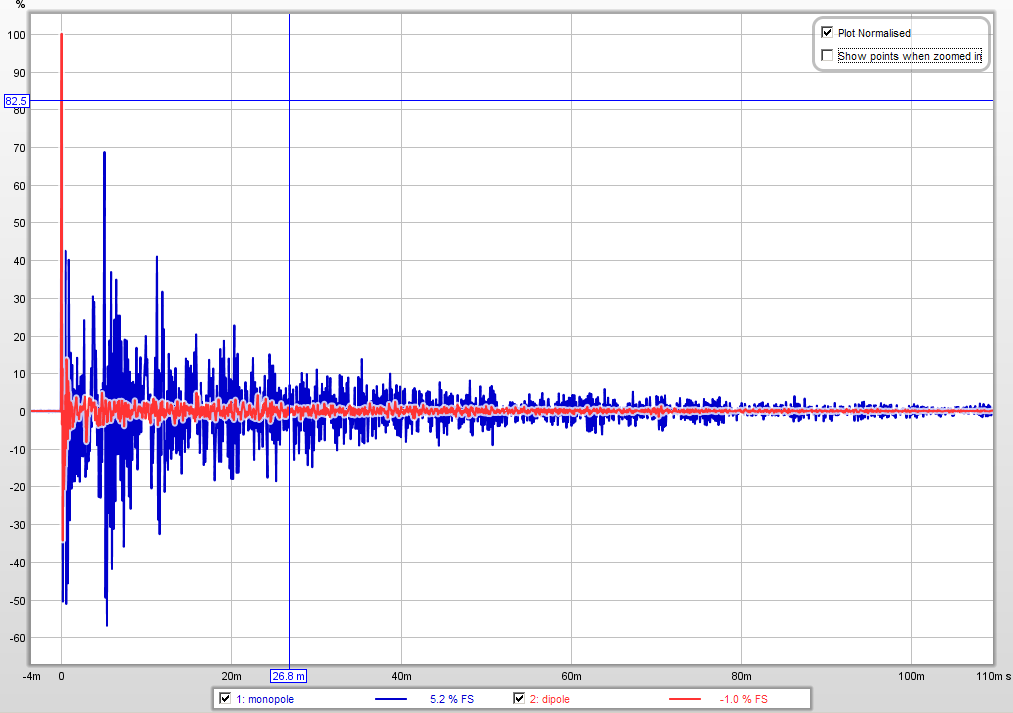

............. They do sound very nice - but quite a bit more busy with all the room reflections.
If OB fans saw this statement they would likely want to see some hard evidence; quite the opposite is what I find:
![dipole v monopole reflections.png dipole v monopole reflections.png](https://www.diyaudio.com/community/data/attachments/451/451038-612adaaea08e27a573904d46a3e15ec4.jpg)
An omni microphone with flat response, and calibration data is more important than distortion measurements for low level signals.

More on calibration file usage. Your UMM-6 is relatively flat; flatter than what you are currently targeting thus far. Here is your B-TC9FD loaded solo three times into REW; short windows without smoothing. 1) is calibration applied in both microphone and soundcard fields. 2) is calibration in microphone field only. 3) is with calibration cleared completely:

Hmm... I get virtually no difference (maybe <0.5dB) between with cal on both vs mic only:
Note this is with the UMM-6 mic attached and working. If you don't actually have a mic, it may apply the filter twice as you are showing. With mic plugged in, the input sound card is bypassed. Do you have a USB mic plugged in? I assume you are using your usual analog input sound card and XLR mic.
