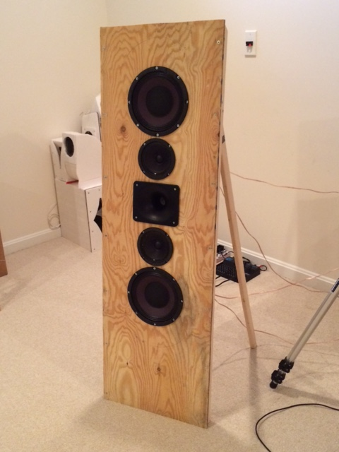

Here is my gen 2 using an WMTMW layout to get better integration and more efficiency. Woofers are Beta 8cx, mids are PA130-8, tweeter is PRV D280Ti with 45x45 WG16-25B waveguide.
Still optimizing XO and delays so work in progress. Very loud... but dual 8's in an OB don't cut it for bass. I will enlarge cutouts and swap for 12's.

The tweeter will be 2nd order LR at 2400Hz, one octave above recommended minimum XO. The woofer XO is also LR2 but at 600Hz. The mid fills in the hole created by both LR2 woofer and mids canceling steeply at 1200Hz.

This is research lab speaker test bed so no I won't be painting it. If I make a permanent speaker then yes.

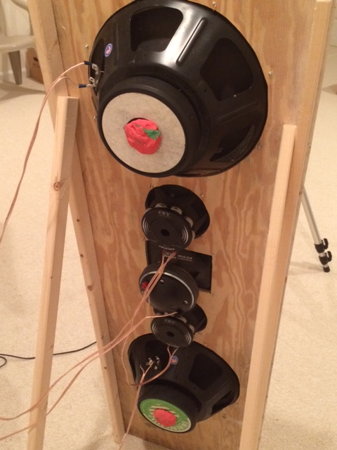

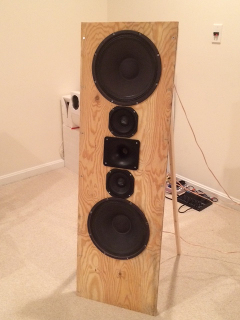

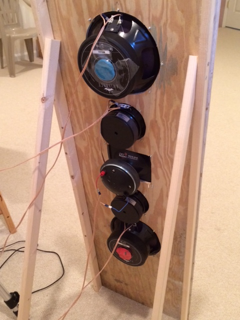

B&O with Beta 12cx, 5MR450NDY, D280Ti
I swapped out the woofers for the Beta 12cx to get some real bass, while I was at it, I decided to swap the mids to the higher sensitivity 5MR450NDY. Both the woofers and mids are now wired in parallel (4 ohms nominal) in order to boost sensitivity by 6dB for same voltage.
Here is what it looks like:

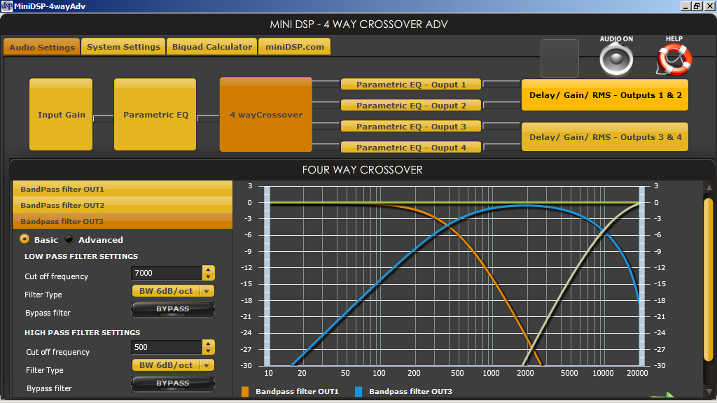

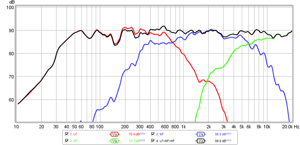

And after some initial quick and dirty DSP settings adjusted (delays and very minor EQ) we get this for acoustical crossover. I am using the mid in a wide mode in order to keep the mid in the telephone band without a XO.
Here is the XO setting in miniDSP:
Here is the impulse response:
Here is the step response:
Still listening to it now, so far so good.
![494160d1437200618-filler-driver-ala-b-o-gen2-beta12cx-5mr450ndy-d280ti-front-photo.png](https://www.diyaudio.com/forums/attachments/multi-way/494160d1437200618-filler-driver-ala-b-o-gen2-beta12cx-5mr450ndy-d280ti-front-photo.png)
![494161d1437200618-filler-driver-ala-b-o-gen2-beta12cx-5mr450ndy-d280ti-back-photo.png](https://www.diyaudio.com/forums/attachments/multi-way/494161d1437200618-filler-driver-ala-b-o-gen2-beta12cx-5mr450ndy-d280ti-back-photo.png)
![494162d1437200618-filler-driver-ala-b-o-beta12cx-5mr450ndy-d280ti-xo.png](https://www.diyaudio.com/forums/attachments/multi-way/494162d1437200618-filler-driver-ala-b-o-beta12cx-5mr450ndy-d280ti-xo.png)
![494165d1437200618-filler-driver-ala-b-o-beta12cx-5mr450ndy-d280ti-xo-minidsp.png](https://www.diyaudio.com/forums/attachments/multi-way/494165d1437200618-filler-driver-ala-b-o-beta12cx-5mr450ndy-d280ti-xo-minidsp.png)

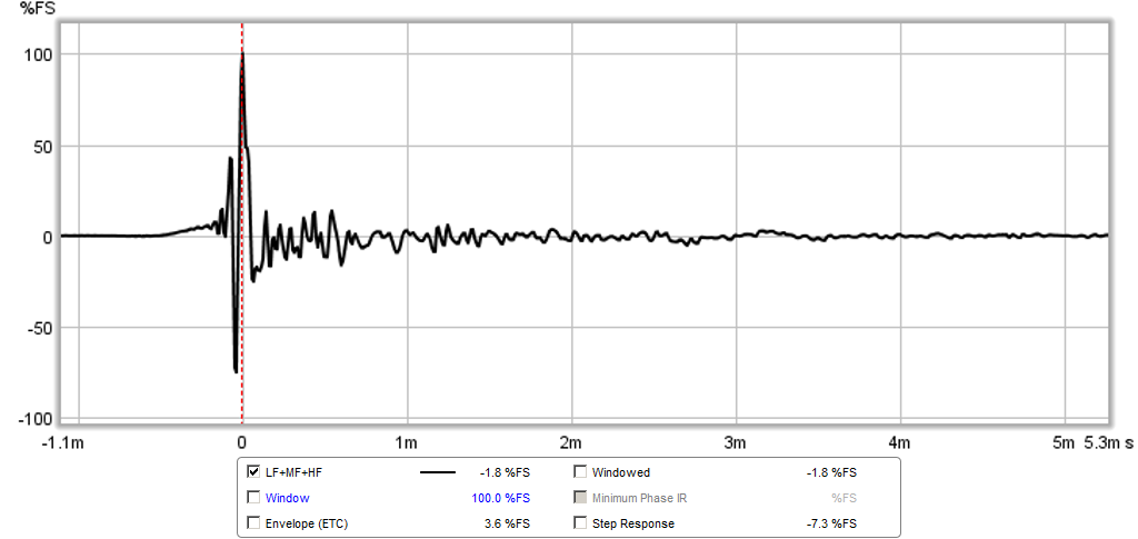

![494163d1437200618-filler-driver-ala-b-o-beta12cx-5mr450ndy-d280ti-ir.png](https://www.diyaudio.com/forums/attachments/multi-way/494163d1437200618-filler-driver-ala-b-o-beta12cx-5mr450ndy-d280ti-ir.png)

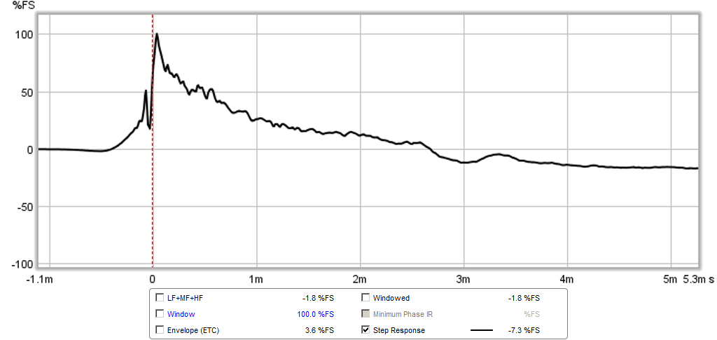

![494164d1437200618-filler-driver-ala-b-o-beta12cx-5mr450ndy-d280ti-sr.png](https://www.diyaudio.com/forums/attachments/multi-way/494164d1437200618-filler-driver-ala-b-o-beta12cx-5mr450ndy-d280ti-sr.png)

It sounds much cleaner than the PA130-8 which has a lot more breakup peaks in the 5k area. The system is indeed "strong". After building it and looking at how intimidating it looks I realize it is a bonafide pro audio blaster. Two 95dB sensitive woofers, two 95dB sensitive mids, and a CD and horn capable of 108dB. On paper it should be about 101dB at 2.83v and 4ohm system.
I got to listen to only several tracks so far and recorded them too but have not had chance to post yet. The sound is very good - balanced overall as can be seen from frequency response. As expected it sounds good with all genres. The TG9FD-DC28F-TG9FD combo seems to have slightly better articulation of the upper registers - but that was because the system had more of the HF's handled by the soft dome. But this system has a lot of reserves left over as the drivers are able to still take on a lot more power. Acoustic guitar realism and attack is still sure convincingly realistic. Eric Clapton's "Unplugged" is rendered very well.
The system is very loud as one would expect.
Pretty good starting point xrk971. Have you tried hammering the drivers into close to perfect slopes using the miniDSP EQ?
No, I tried this last time with the other drivers and found that it requires too much PEQ that it sounded phasey yet did not make the SR any better. I find that this sounds best with minimal EQ and let the acoustical slope take whatever it ends up as. Just need to make it electrically LR2-BW1-LR2.
