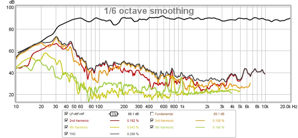

Do you have distortion graphs for this one?

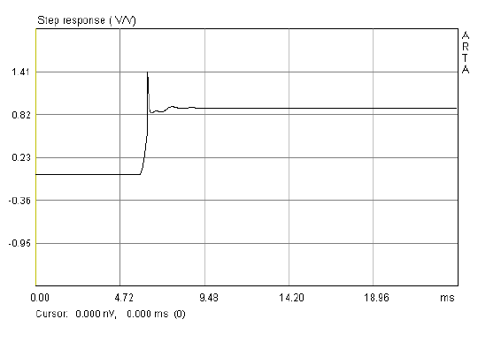

i´m amazed for the step plot, i haven´t got any similar
Maninnen,
Thanks. You can get the step response if you use a very wide band mid and band pass it with 1st order Butterworth on both ends. Then low pass the woofer with Linkwitz Riley 2nd order and high pass the tweeter with Linkwitz Riley 2nd order as well. Now very important: all drivers are in phase with positive pushing drivers out. Next adjust delays between each separately. I start with woofer and mid first by setting sine generator at xo frequency and flip polarity of mid then adjust for minimum signal at xo frequency using and RTA. Then flip back and check to see if it looks good and smooth response through the xo range. Repeat for mid and tweeter. This should get you close - within 0.04ms then fine tune delay one increment at a time. Plot step response and tune as needed for best shape. I think I can improve it more. When you get it right the difference in percussive dynamics is like night and day. Good luck!
Here is HD, not the best I have seen as I think thin 3/8in thick ply baffle is vibrating and there are too many empty foam speaker boxes nearby resonating during the test.
![494415d1437312709-filler-driver-ala-b-o-image.jpg](https://www.diyaudio.com/forums/attachments/multi-way/494415d1437312709-filler-driver-ala-b-o-image.jpg)

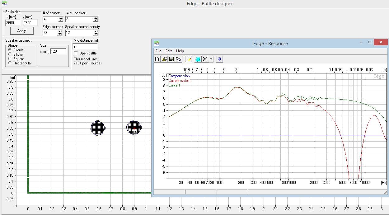

The latest baffle has two mids at like 300mm CTC separation. It means the beaming is rather drastic when xo is around 6kHz.
Here is Edge simulation at 2m distance, mic at other driver's on-axis 15cm/2m (only 3-5¤ off I guess) Crossing at 4kHz would be better, or the tweeter having less steep xo.
We always get compromised, don't we...
