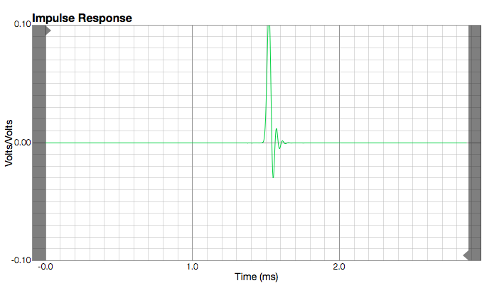

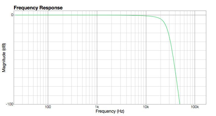

Minimum-phase soft roll-off
To start the thread rolling, this filter is a second attempt at the Ayre Listen filter.
Unlike the MixPhase1 filter posted to the vendor thread it is pure minimum-phase.
I discovered the "trick" to minimising ringing is to stack filters in rePhase. By placing filters at approximately 2kHz intervals it's possible to create curve that replicates the desired behaviour using gentle filter slopes.
The filter impulse response is now very close to the 1 cycle of post ringing described in the Ayre MP white paper.

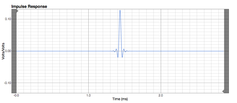

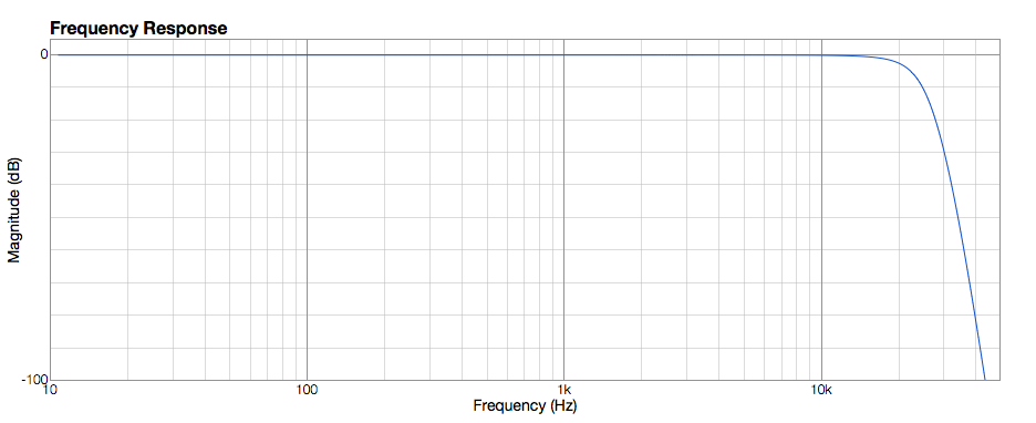

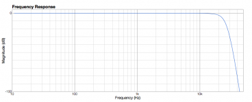

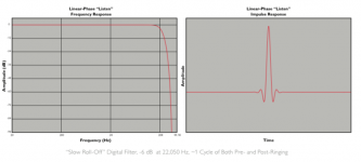

Linear-phase Slow Roll-off
This is a similar filter to the Ayre Linear-Phase "Listen" setting.
As with the minimum phase filter, the main aim was to get as little ringing as possible.
The stacked filter technique seems to help in achieving this goal.
The LPSRO441 above has quite slow rolloff. Its only some 10 dB down at 22 kHz. Is this really enough? Energy that is present above 22,05 (1/2 Fs) will reflect back into the 0-22.05 range.
So the resulting alias from your filter at 29 kHz will turn up as 29-22=7khz. At 29 kHz you are down only -15 dB. This is why "everyone" is aiming for -100 at 22,05 khz.
During listening session yesterday over a pair of JBL Array 1500 and Hypex NC400 one can hear a noise trail around higher notes quite clearly. It creates a very "clear" sound but also it suffer from digitalis and really isn't clean.
Are you sure you mimick the Ayre at 22,05 khz?
Yes. The Ayre filter is -6dB at 22.05khz. -100db at 44.1khz.
However, re-reading the WP this seems to be an older filter design which is superseded by the MP slow roll-off.

The penalty (remember, there is no such thing as a free lunch—only intelligent tradeoffs) is that there is more “leakage” (aliasing) of high frequencies above 22,050 Hz back in to the audio band. Still, this only affects very high frequencies and the levels are low enough not to cause audible problems.
This “slow roll-off” filter reduces the time smear by a factor of ~20x compared to conventional digital filters. The net result is a much more musically natural sound, as the ear-brain is very sensitive to time-related distortions. This filter provides an outstanding compromise between frequency response and transient response, and for ten years was the mainstay of Ayre’s digital audio filters.
The 29 kHz will turn up as 44-29=15kHz (first we are in the lower side band which is mirrored frequency wise).
But still I also feel that the rolloff is too slow.
It would be a strange design concept to combine slow digital filter with a fast analogue one. Ususally the arument is you can do the fast ones more precise digital.Åhå. And this is all their filtering. There are no additional analogue ones?

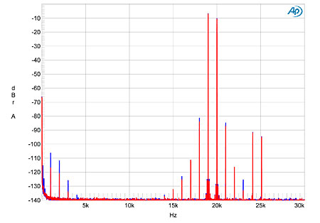

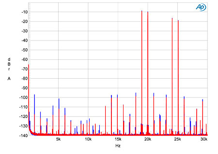

Looking at Ayre
Meaure:
http://www.stereophile.com/images/archivesart/1009ayre.fig12.jpg
Listen:
http://www.stereophile.com/images/archivesart/1009ayre.fig13.jpg
The difference is more alaising product but not at an alarming leve but look at the main IM product at 1khz. Now, today we don't build analogue circuits that produce -55 dB IM so I reckon this is a digital artifact coming out of alaising distorsion via the digital domain.
These things make the sound appear clear but is tiring in the long end.
I can find no description of the Ayre using additional analog filtering. I can't find Charles Hansen discussing anything but digital filtering, but they do use a discrete output stage so there may be something incorporated into that.
I'll let you find evidence that there is additional filtering as you've made the claim that there might be...

When searching for information about filters I stumbled upon Auralic Vega DAC, it has different filters you can select.
Most of the users prefer filter n°4 that is also a minimum phase.
