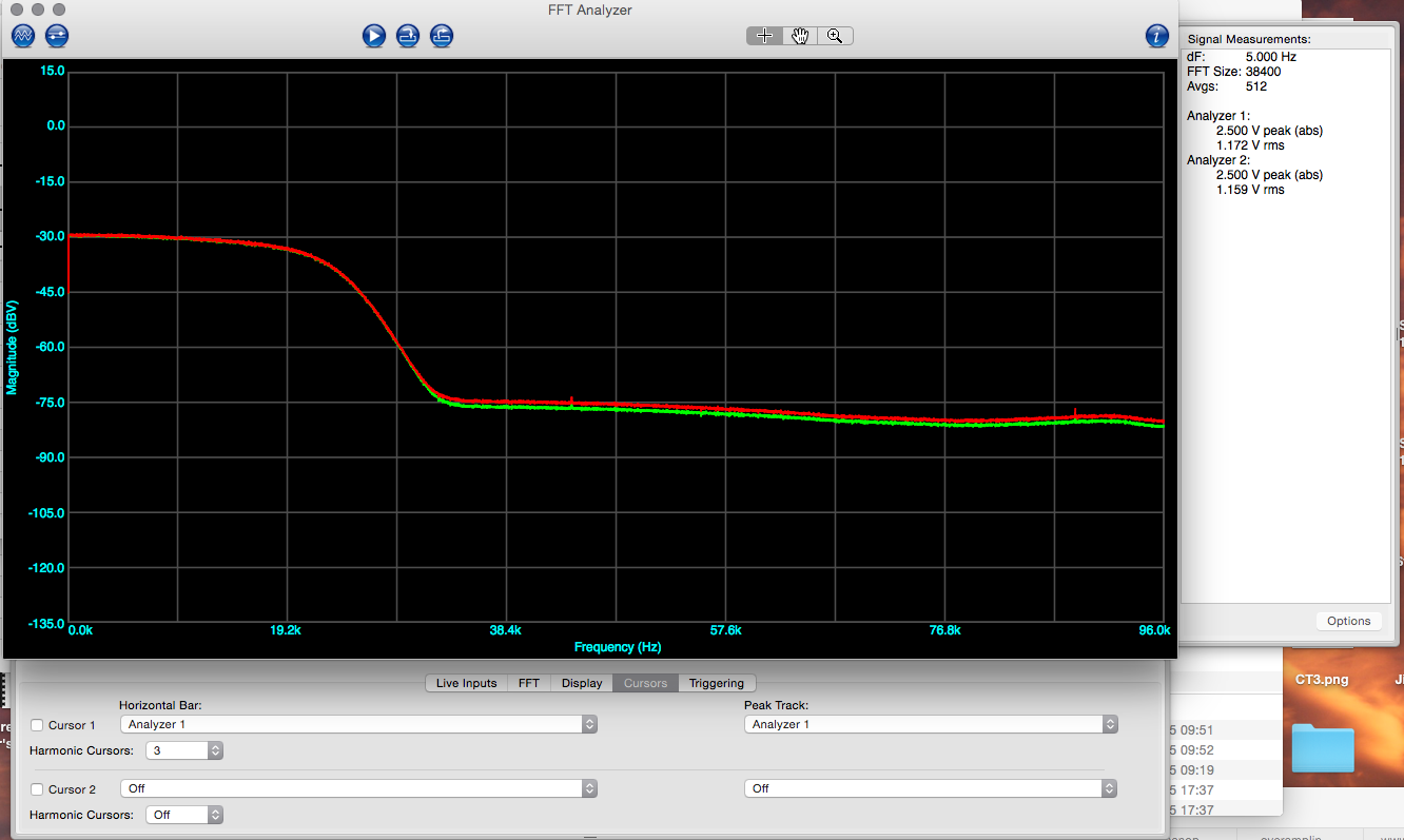

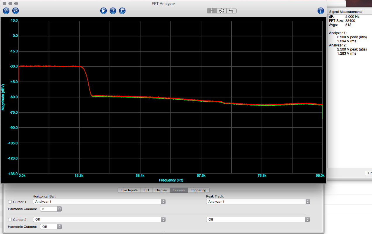

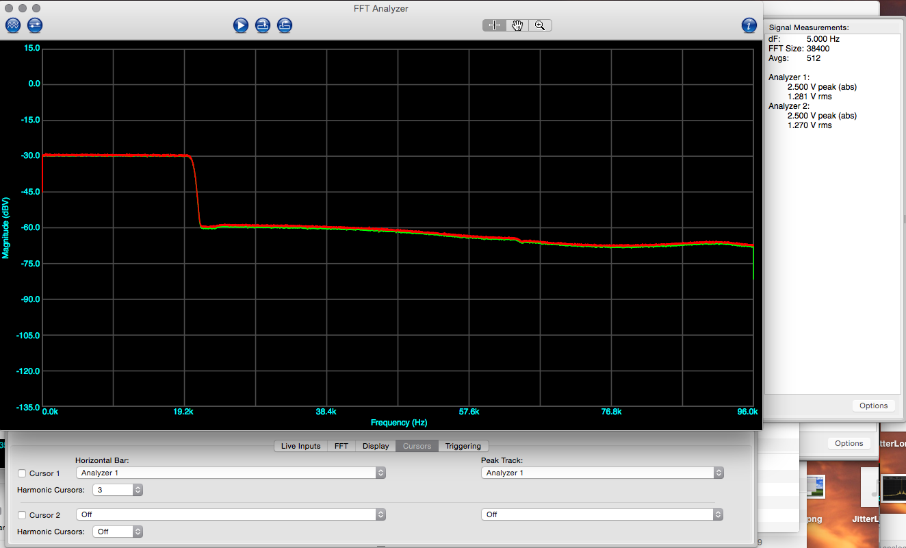

MB1 looks very similar to Søren's factory filter however the roll off is steeper.
The slow roll-off is very slow in comparison.
In order the charts are MB1, Søren Default, MPSRO441v2
The plots are done with white noise, with DAC set to V+00, and audio interface input gain levels at minimum. I've had to attenuate the white noise source to prevent the inputs clipping. The levels were not touched when testing so any variation in level is the result of the filter configuration.
The method is a slackass version of NwAvGuy's testing procedure.
Note: Ignore dB scaling, this is illustrative only.
