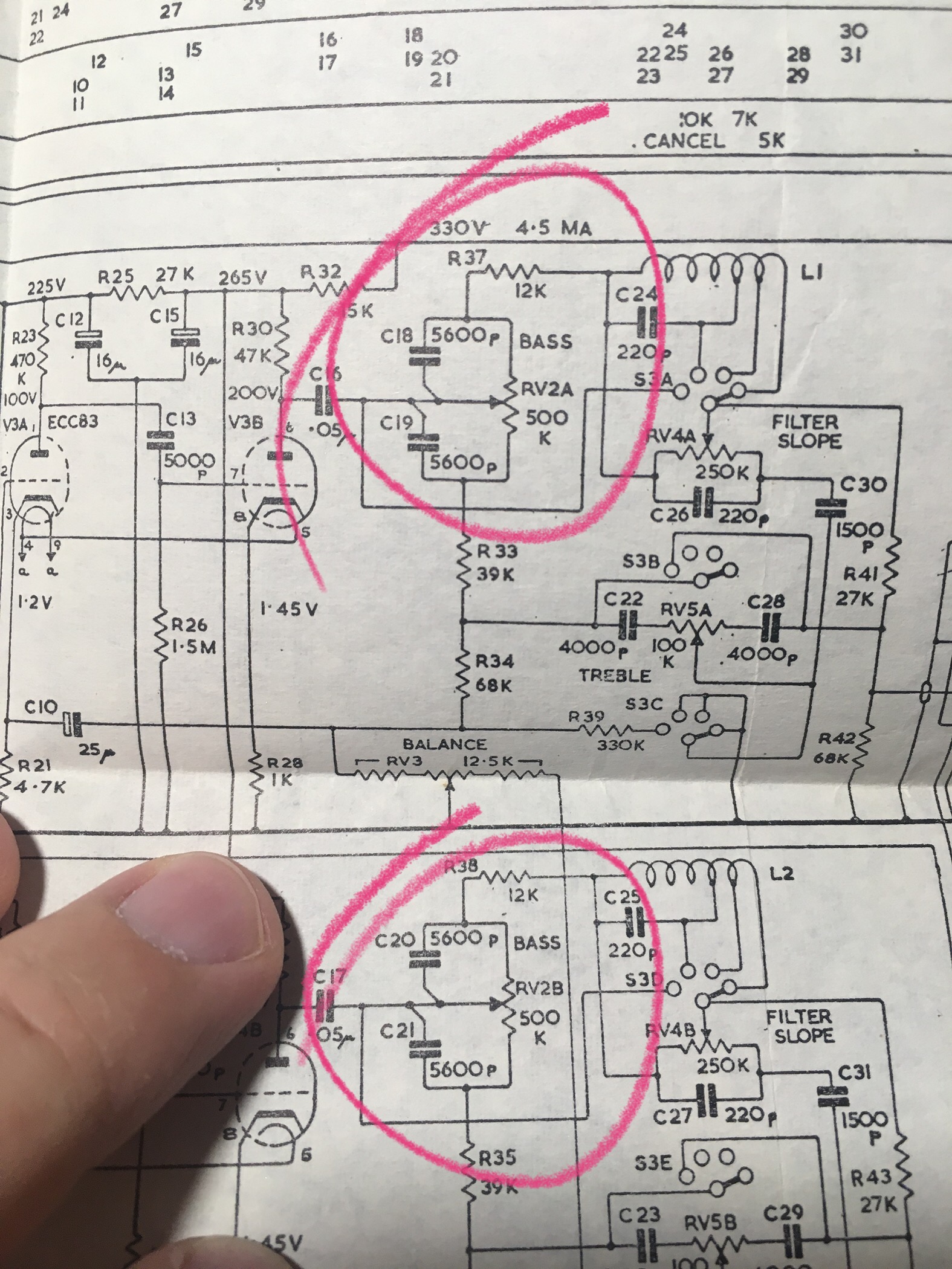

So, I've found these:
(QUAD 22)
for C5 C6 C10 C11 - a Substitute of 25uF 16V
for C34 C35 - Substitute 0.022uF 160V
for C8 C9 - Substitute 0.47uF 250V
for C16 C17 -Substitute 0.1uF 400V
for C3 C4 -Substitute 0.1uF 160V
for C7 C12 C15 -Substitute 16uF 400V
for C18 C19 C20 - Substitute 5000pF 50V
for C22 C23 C28 C29 - Substitute 3900pF 50V
for C30 C31 - Substitute 1500pF 50V or 1500pF 200V
Mainly, I am not sure of the voltage ratings are right; especially for those little Styroflex caps at the tone controls (50VDC is enough?)
for QUAD IIs I ordered NOS Russian PIO's, as it's a recommended by so many forumers; the 0.1uF 400V and 0.1uF 160V the closest value to the original.
What do you think?

Don’t forget about the resistors. Some were out of spec. You probably don’t need to worry about the pink wire-wound ones, but the carbon composition ones need to be checked.
When ordering new resistors, check the voltage ratings. I forgot to do that and had to re-order new ones!
Contrary to what is stated above somewhere, you need a Tape adapter in a 22. Everything goes through it. You can get them on e-bay with a gain control pot, which is rather clever.

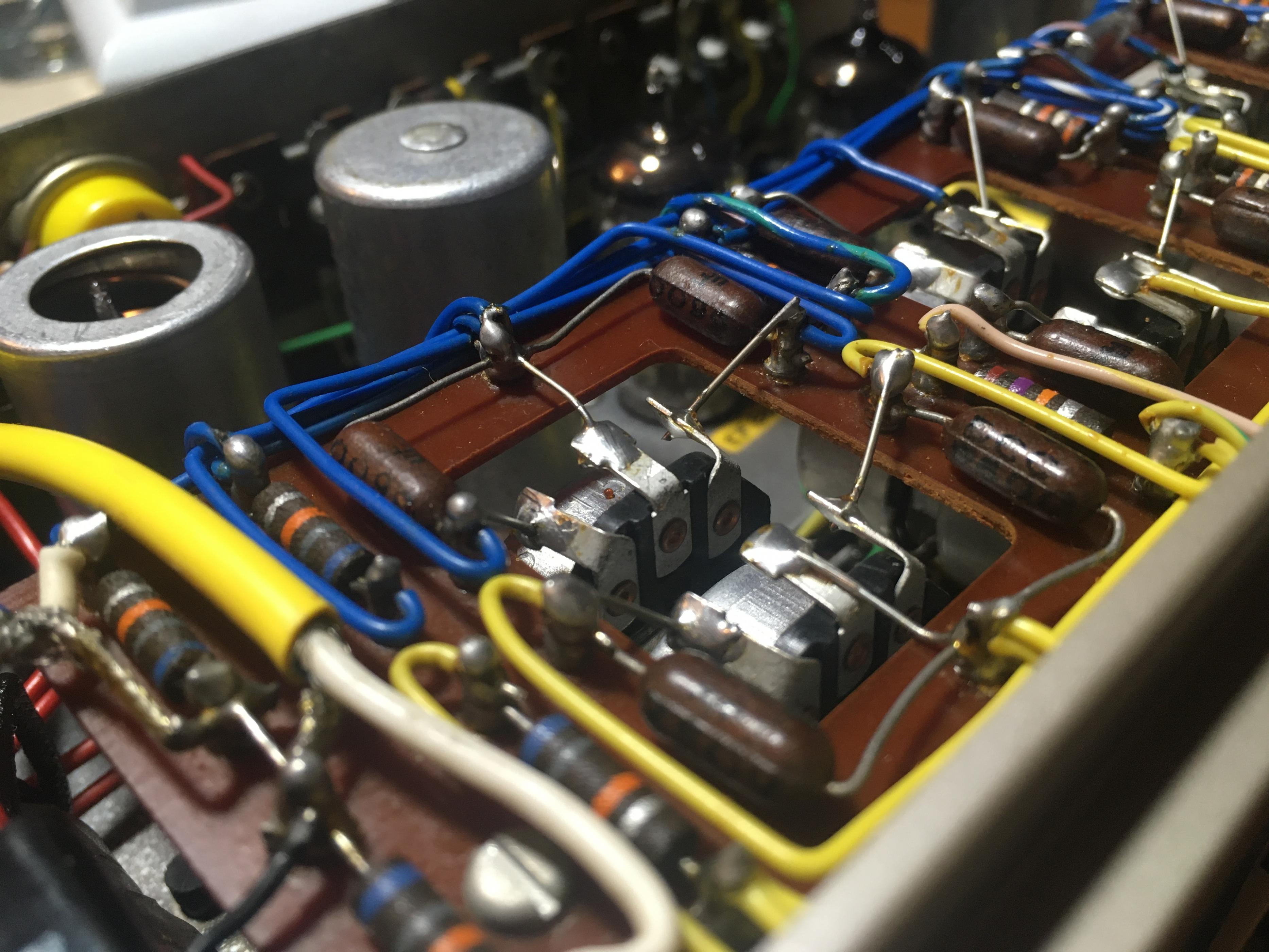

You don't need to strip and replace everything. The main resistors to look at are the ones directly connected to the can capacitor, including a 47K connected by a blue wire. Don't change the long pink ones, they are ageless. Also change the two 1.5M screen resistors over on the right. Change all four electros and all the film caps on that side and the two large ones on the top side, one rather inaccessible. I price renovating the tone controls separately, as a lot of customers don't care about the tone controls, they use Cancel. Think about that. Don't change any polystyrene caps, they are also ageless.

I am sorry for my lack of knowledge in things, but I am not sure, how to check the resistors. Should I remove one leg to measure the values, or these could be checked in situ? Which voltage rating would be fine for these? And can you suggest a manufacturer?

You can check the resistors with your multimeter. Typically they start getting out of tolerance — they should be +/- 10% I believe. So if you have a 1k resistor and it reads anything above 1.1k, change it.
You can usually measure them in-circuit. If you see that your multimeter looks like it’s unstable and the numbers fluctuate, it means there is a capacitor in parallel. Then you can just lift one leg of the resistor to check it.
The voltage ratings are based on how much voltage the resistor could see; exactly like a capacitor. I usually look for >500v ones, though, since overspeccing them doesn’t matter, and it’s much harder to find the voltage rating of a resistor after you have bought it.
Any good manufacturer will do; anyone on mouser would probably be fine.

Don't bother. Just replace them. The ones I mentioned. Voltage rating 300V. 1/2 watt will do everywhere in a 22.I am not sure, how to check the resistors.

The two 1.5MOhm resistors are almost in specs, one is 1.68, the other one is 1.72
I will check the others soon
