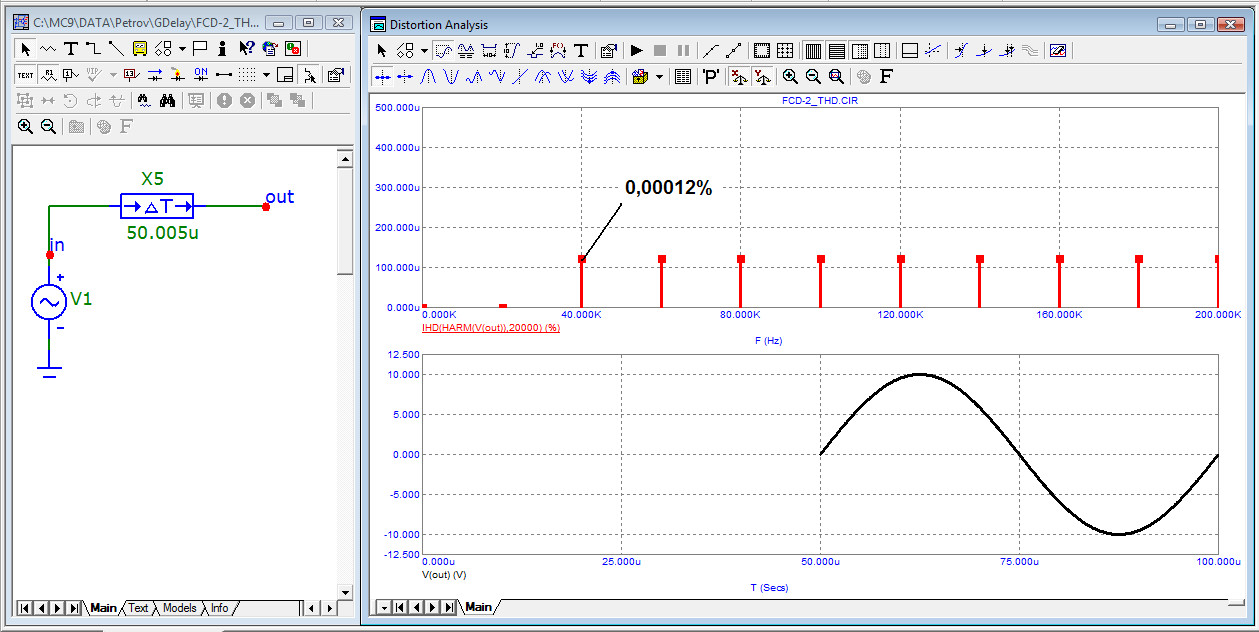

Let's check the statement of Kiryll Hammer about the signal transmission delay of several ns. As you can see, with a signal delay of 5 ns, the distortions of even the first period are already negligible. Graham wrote about this repeatedly and confirmed by some colleagues who noted that faster amplifiers were in a winning position in terms of sound quality.
Again, these are not distortions. These are spectral components that are part of the signal you created. You created a 20kHz signal with a lot of harmonics. Of course you see the harmonics - you yourself put them there by defining an infinitely fast starting sine!
I can't believe that you don't ask yourself: if this is distortion, what is doing the distorting??
A delay causes distortion? How. Your pics show nothing. This has gotten so ridicoulus its not even funny anymore.

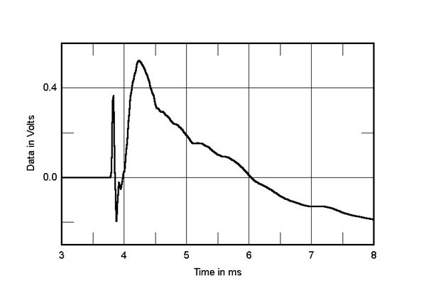

If minimizing “delay distortion” is the holy grail of audio, why don’t we see more reports of subjective superiority of high BW amplifiers? Through the years several high BW audio amps (~1MHz) appeared and quietly disappeared from the scene. Forgotten.
Actually tube amps, preferred by many, are typically quite limited in BW.
And what about transducers? What is the chance for amplifier rise time to make any difference in the speaker impulse response (chart copied from Bowers & Wilkins 705 Signature loudspeaker Measurements | Stereophile.com)?
