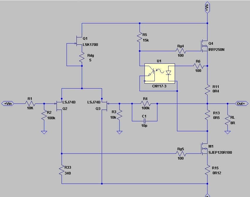

I have the PCB's assembled and was going through a final check of my work, and the CNY17-3 wiring in the circuit has me confused. What is the base of the transistor (pin 6) connected to? The schematic makes it look like pin 6 is connected to the body of the CNY17-3, without any connection to the circuit.

Thank you Zen Mod! When I looked at the datasheets for Vishay, Lite-on and Fairchild, it confused me even more.
VISHAY: Has the base connected to pin 6, yet the schematics shown for testing shows the optodiode connection.
Lite-on: Has no connection between the base and pin 6
Fairchild: Shows the base connected and NOT connected to pin 6 based on part number.

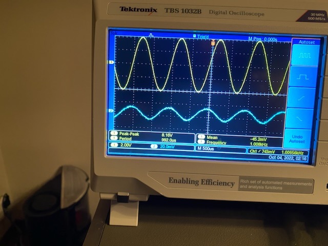

I am hopelessly old fashioned, but I really like the HP334A. All you need is that, a scope, and some sort of signal generator (does not have to be noiseless to do simple residual waveform analysis and adjustments). Of course, it does not provide the whole thd spectrum (FFT), and since they are very old you need to take care when obtaining one, but the 334 or the likes will give you a live analog waveform and I kinda like that 🙂
Attached is an example (yes, posted before). In blue is the residual from the F2J @ 1W into 8R. It has a bit too much zoom compared to the fundamental, but you get the picture: very clean residual, just what we are hoping for from a no feedback single ended amplifier.
Noise along the residual curves I attribute to my own test setup and a signal generator just about to explode (yes, it did explode, or at least a few caps did).
