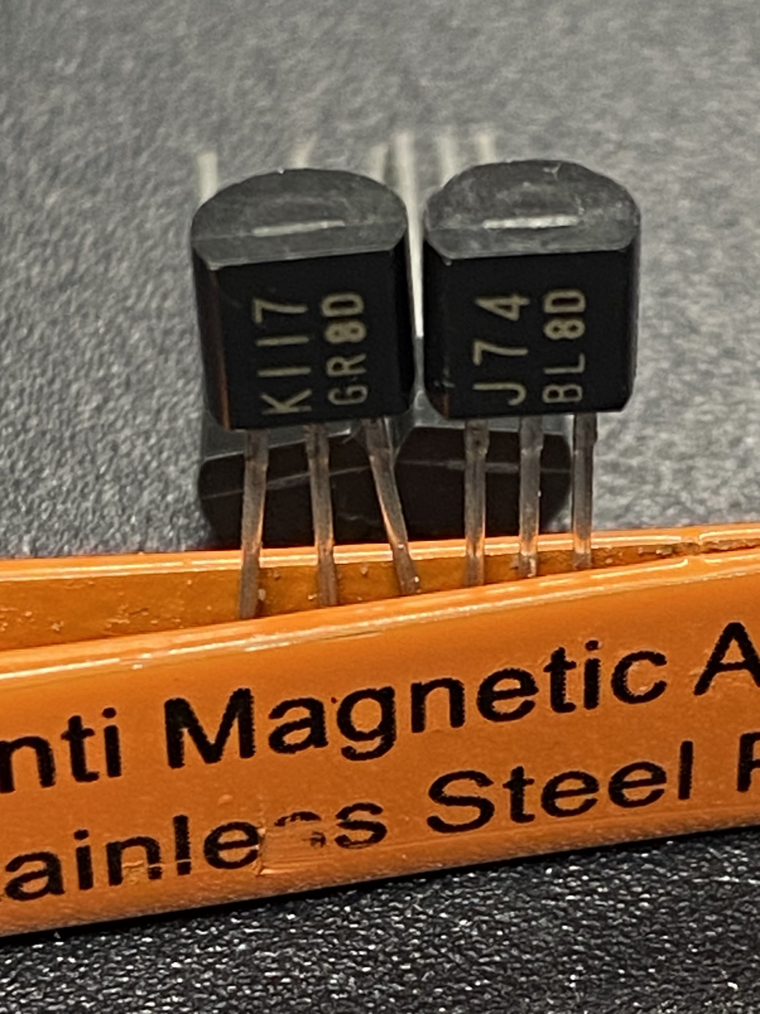

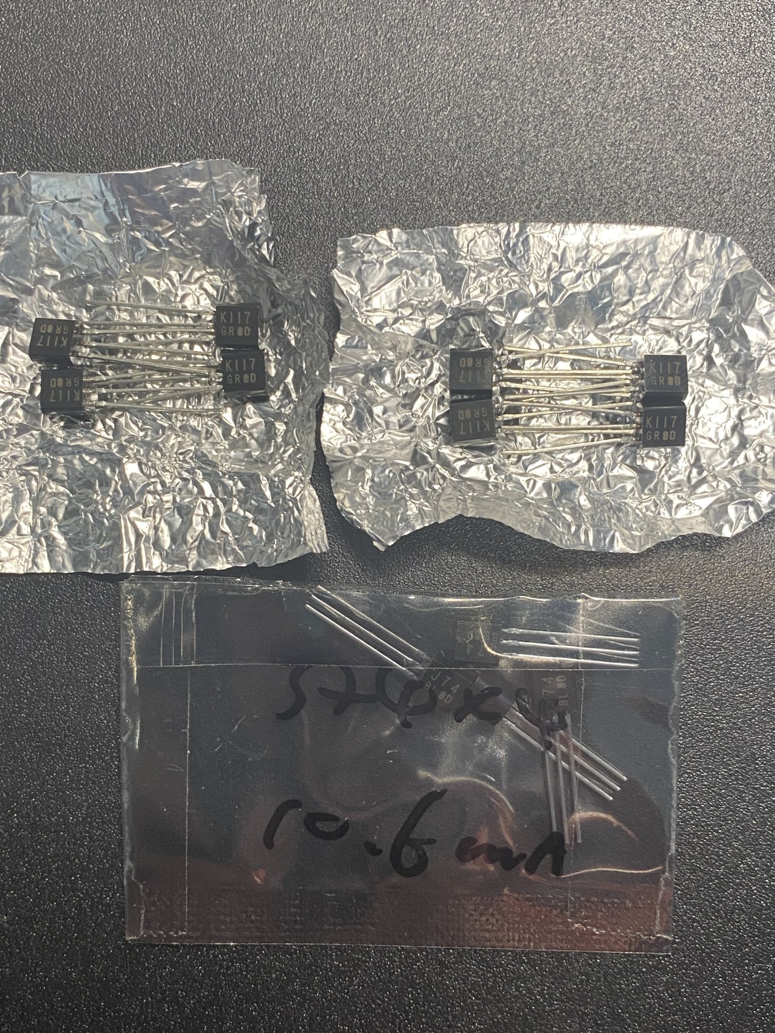

I searched in my parts bin today and found a matched quad at 10.6ma of j74bl. I also found 2 quads of matched k117gr. One is at 4.3ma and the other at 5ma.
Should I go with these or it’s better to order the ones with the required idss?
I see a problem.... the four J74 are BL as in the original, but the k117, may not be good.
Either two 2SK170 or 2SK370 in parallel with an Idss adding to 10mA are requested.
Of course 5mA and 5mA would be the best solution, to share the current equally.
2SJ74 is P-JFET, 2SK117 is N-JFET.
2SK117 is the TO92 version of 2SK209.
