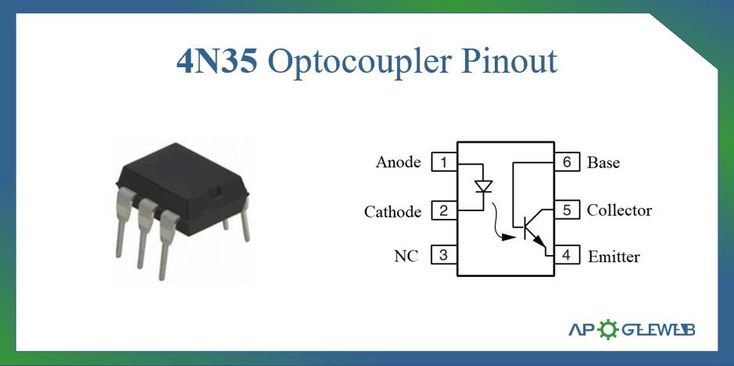

Aleph-J is different from the J2 in the way the current source is modulated.
The J2 (and F8) modulated current source using the optocoupler is a simpler circuit and has less stability issues.
