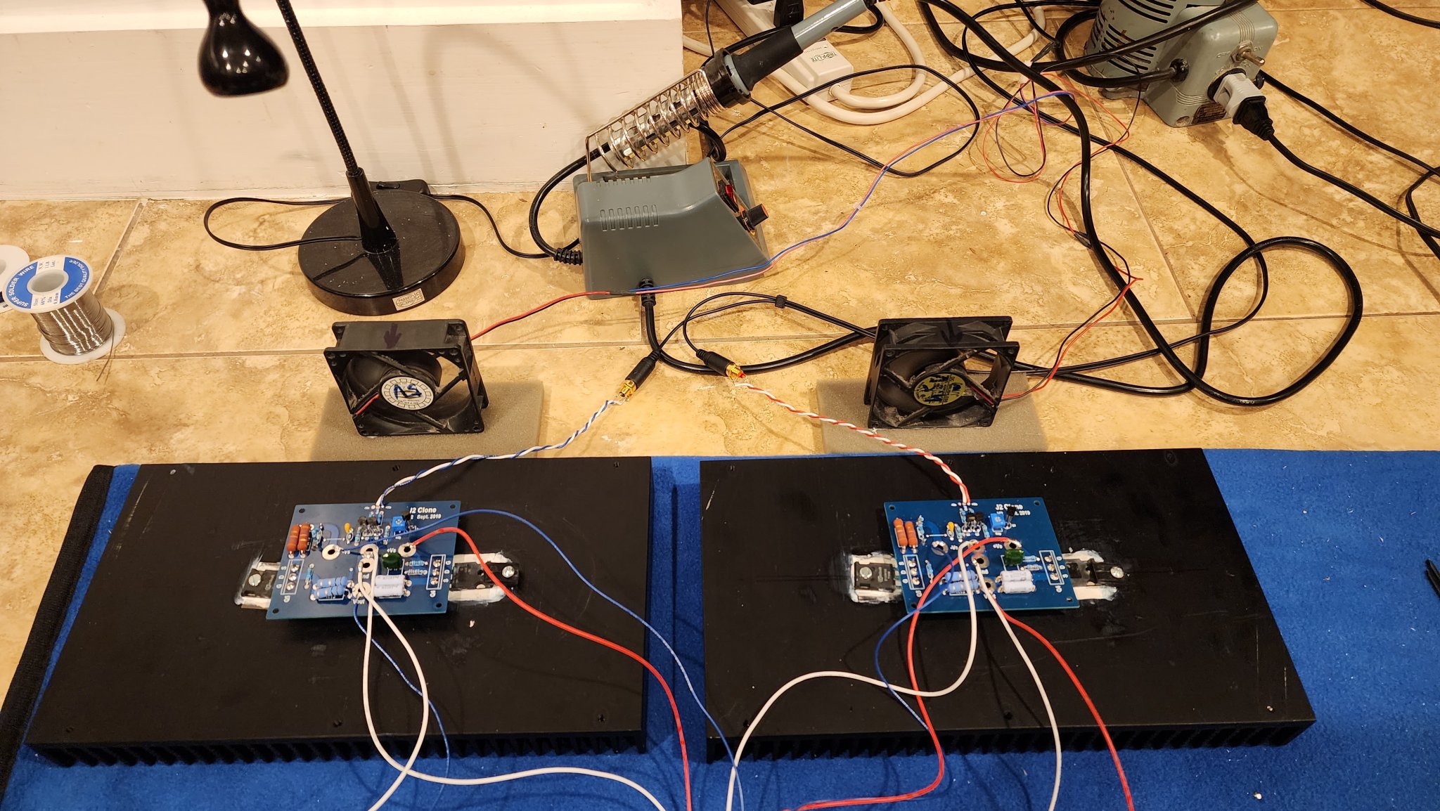

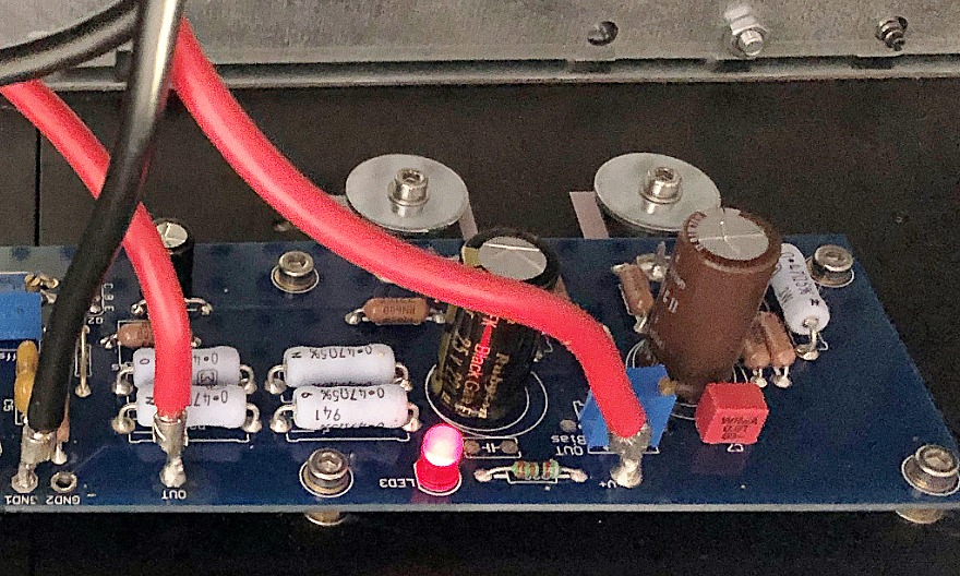

Looks like all is working as expected. Had to increase r33 slightly to have zero dc on output. Right now its just quick and dirty put together using variac, but it produces nice sound. Thanks everyone for parts and boards! This is great community.
Btw, i put that junction wire from underneath, the holes were tiny from top.

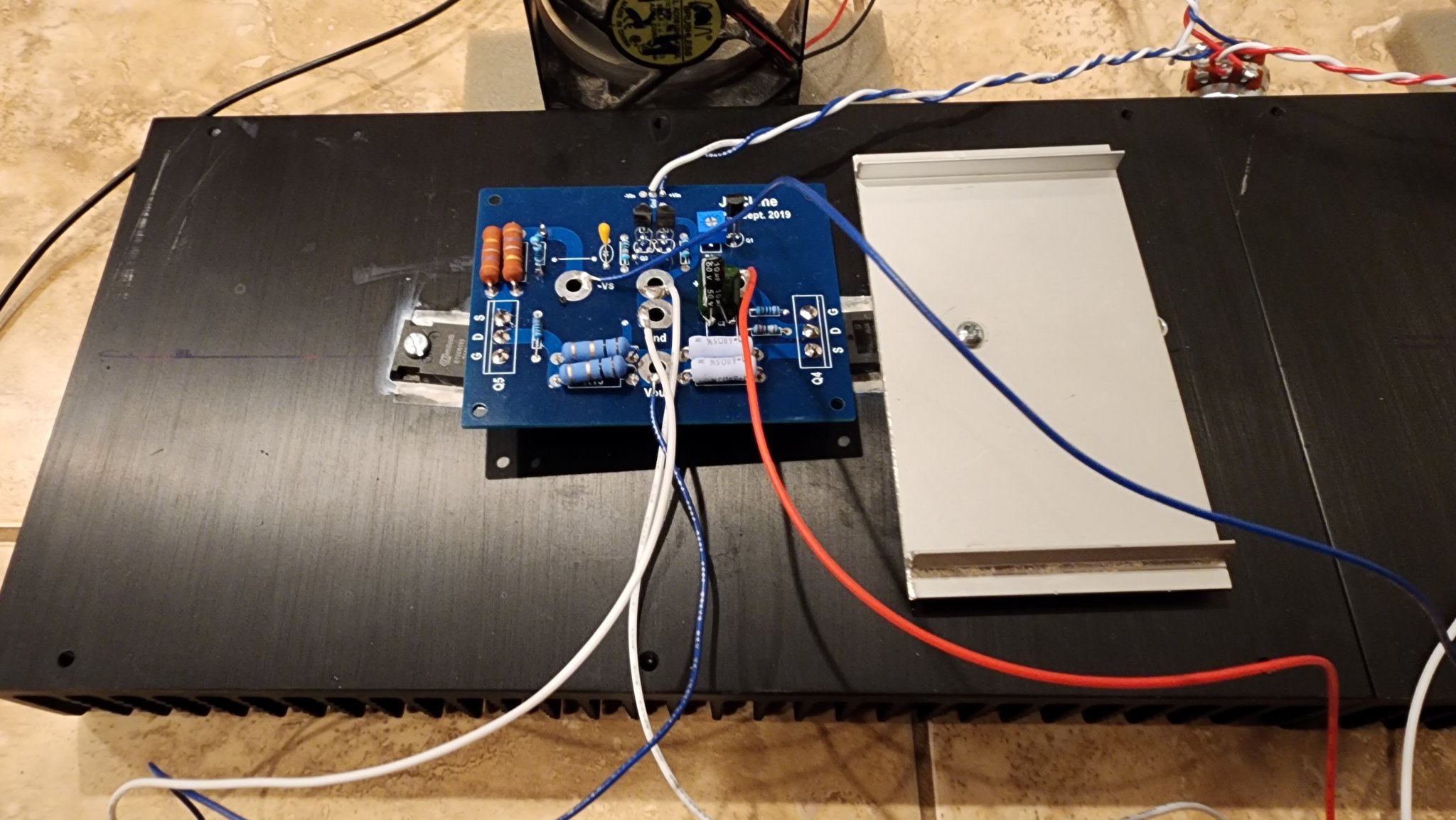

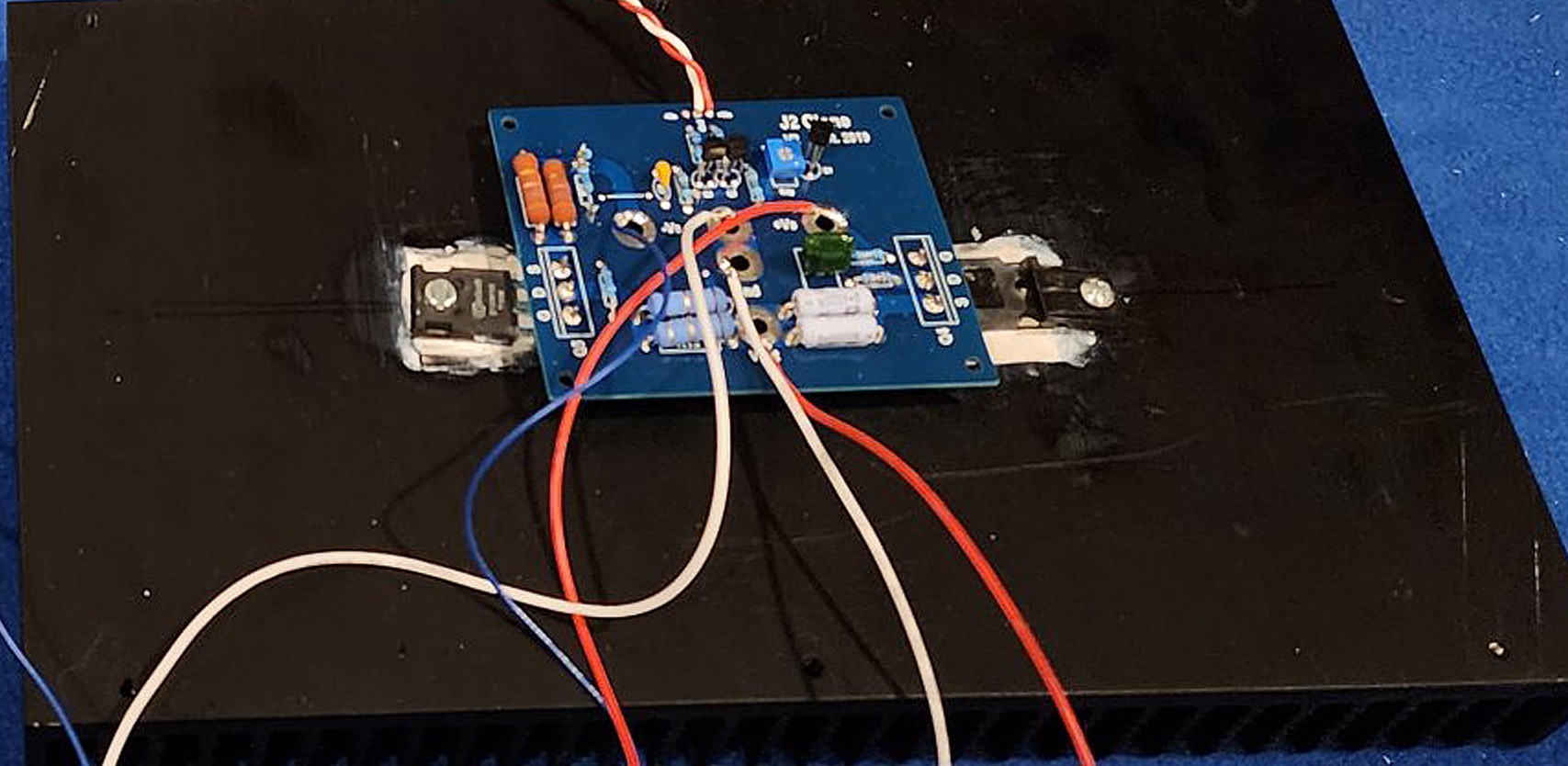

With +/_20 VDC power supply both channels are drawing 3A. I believe 1.5A per channel is fine.
One thing i noticed is that IR mosfets are slightly hotter than bottom SemiSouth Sic. So i measured top side of the outputs with infrared. IRs are ~76degC, SemiSouth are ~56degC.
Heatsinks itself are 32degC.
Is this ok?

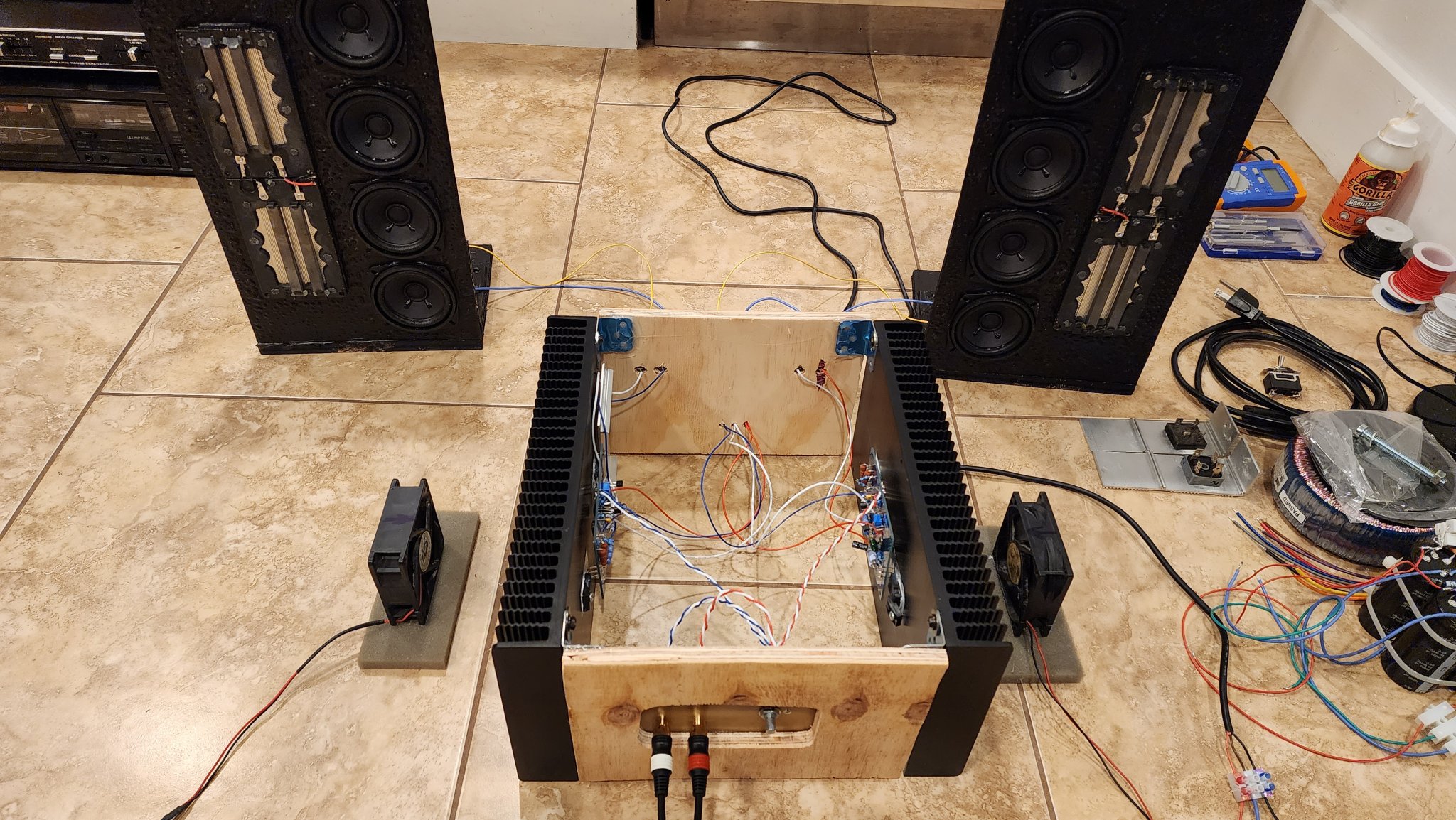

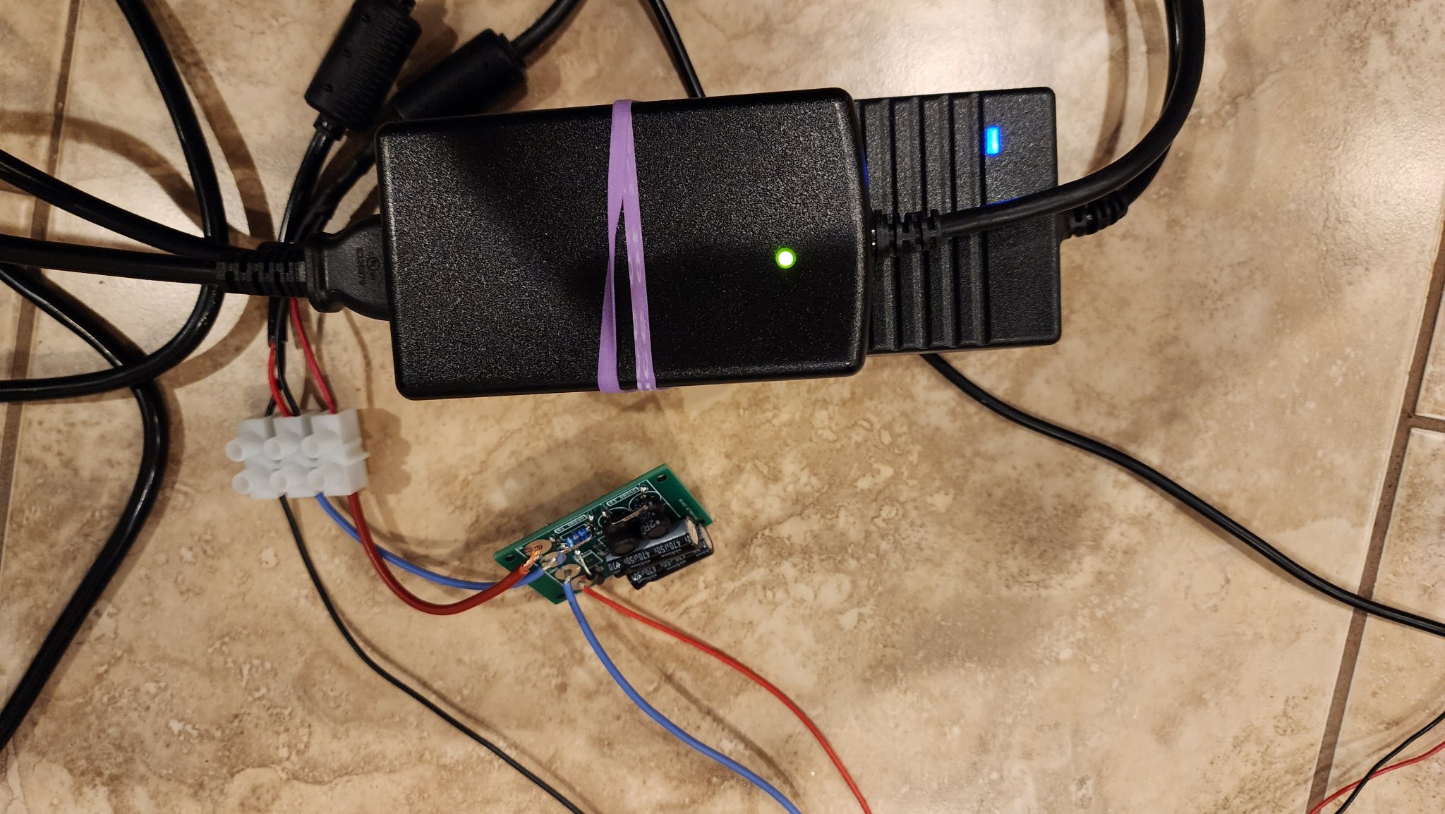

I put two smps together, and even found dedicated filter, just one, but i do not hear any issues. That filter was likely developed by you, Mr. Nelson. Amp is silent and working great. Started working on wooden chassis.
Thanks again all, for boards and outputs.
