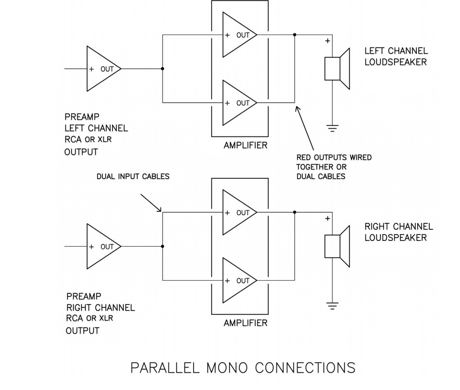

One project would be physically more difficult while the bridge conversion would require knowledge I do not have. I can put together a duplicate power supply without much mental effort. Not that I mind having to think about something but I do not want to destroy the amplifier! I know I am perfectly capable of that.
I would need some kind of phase splitter on the input. From what I read there can be problems with bridging amplifiers with feedback and the J2 does use feedback.
I looked around and saw articles on using a transformer on the input or an active circuit. I would tend to gravitate towards the transformer since that seems easier. I do not pretend to have any business designing circuits. For something like this I am a "color by numbers" DIYer.

you're too humble .... knowing your setup a little .......
what picowakoododo implied is not "regular" bridging (where two halves/channels of amp are working antiphase , and load/speaker is connected to two hots, floating ref. to gnd) but simple paralleling of two channels
please - refresh my memory about your entire setup ( pics are always welcome , being boyz-porn is irresistible) ; as far I remember , you really don't need more "plain" power - meaning you don't need more voltage swing for your bass speakers (which bridging gives ) , but you can possibly benefit from more amps/current ...... which paralleling two channels in one will give
find enclosed (somewhat edited) adequate figure from F4 user/service manual (p9), applicable for possible paralleling of J2
feel free to ask whatever you want .... but more info about your speakers will certainly give us more clue ...... however - if you have buddy with J2 , paralleling test is easy - just cables .....
WELL,
I am the master of turning the simple into the complicated.
I guess I saw those drawings and just did not think it through. I thought I was seeing an arrangement of op-amps instead of symbols for the amplifiers themselves.
But, ZM, do you approve of this arrangement? I am happy with what I am getting from the single J2, but being thoroughly afflicted with this disease I am hoping for something even better, if possible. Which approach would you guess as the better approach - conversion to monos or paralleling for monos?

But, ZM, do you approve of this arrangement? ......
from technical point of view - nothing wrong with paralleling ...... even if there is some one step back , two step forward logic at hand - there will always be some "smearing" of details when paralleling two of same active elements - be it just one transistor or entire amplification stage;
that would be one step back
measure of two steps forward is exactly in correlation with loading burden/demands - if load is easy - no benefit of headroom achieved by paralleling ........ if load is harder - measure of benefit is rising
so , in this case ( as in many others ) only your ears can decide
as I said - certainly least costly way of deciding is if someone near you is having J2 , to bring it for paralleling trial
cheapest one at RenoHiFi is around 2K3 Greenies ..... and I'm too much of a cheapskate to even think of buying one
hey - one day when I win a lottery ( first I need to learn how to , let alone to start buying tickets

I certainly am not experiencing any sound of strain driving the loudspeakers with the single J2 and that possibility of smearing is a concern - as you say, anytime you parallel devices. Maybe if I got lucky and could obtain two amplifiers that were EXACTLY the same ..., which is not possible.

and that possibility of smearing is a concern - as you say, anytime you parallel devices. .
I have wondered the same thing, but then Nelson built his beast of 1000 jfets and he obviously likes it so I am starting to think this smearing concern with paralleling devices maybe a storm in a tea cup.
If you're speakers are better than 93dB I wouldn't bother with paralleling but if you want mono blocks the simplest way would be to buy a second hand J2.
Then once you've purchased them you can try one channel in each amp for conventional dual mono and then compare with dual parallel mono. Then just run it the way you think it sounds best. Just cause you have the two amps doesn't mean you have to do parallel mono you can just run conventional dual mono.
