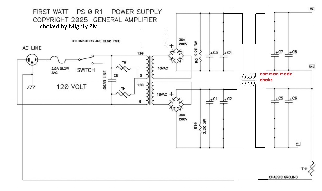

ZM,
I like the idea of the LUNDAHL "common mode" connection but I am not sure how the transformer sees this? Is it parallel or series?
The LL2733 can handle 5 A in parallel.
Could I get away with this on a mono J2?
Your consideration, please.
(I will never put another channel in the box)

generg,
I am not building a J2 - I have a J2 and I am making them mono amps with a box I got on EBAY.
Duplicate PSs will be the only difference - they will be different than what came in the original amp since getting a second PLITRON is prohibitive with their high minimum order I will use ANTEKs and a choke between the caps instead of the resistors. All else will be just as was specified by the great and beloved Ing. Pass.
ZM,

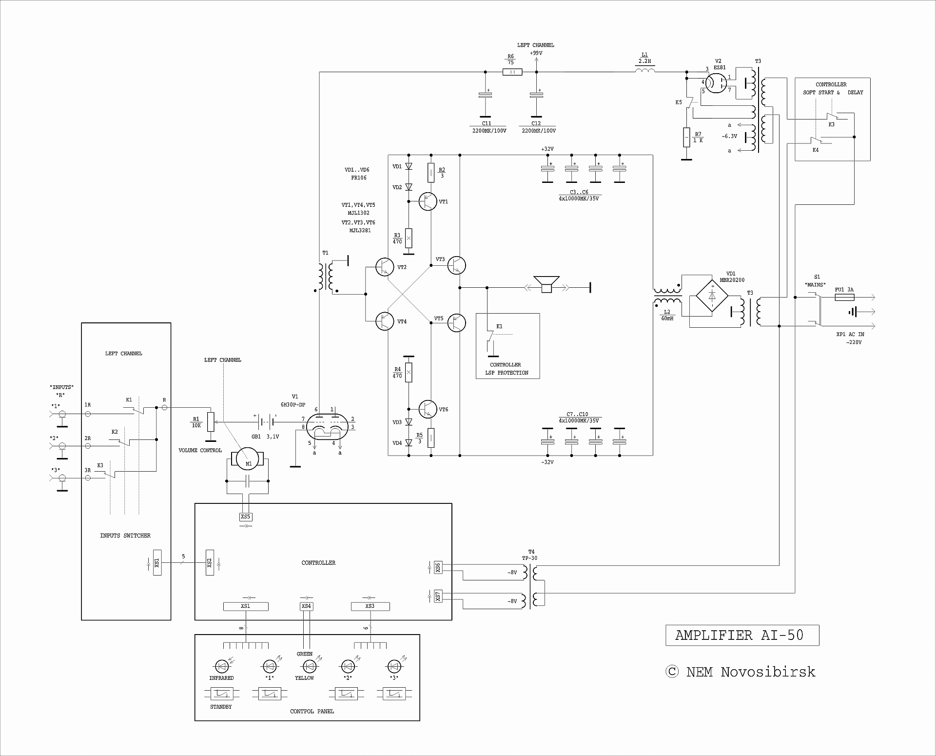

SO, do you think that LUNDAHL choke would work? I have no idea what the current draw of the amplifier is - I see that they are listed at 200 watts power consumption but would that translate into 100 watts each?
I looked at that drawing earlier after you mentioned it. The LUNDAHL spec sheet shows how to use it and the NEMS is just like the LUNDAHL spec sheet.
Seems if one is to use a choke might as well be the best possible implementation. The question is would 5 amps capacity be OK? What do you think?
I am going to use these for the filament supply in the 4P1L linestage I have been collecting parts for two years - if they don't work here I know I can use them with that.
Is it worth a try?

I build J2 clone with separate psu box, a copy to Papa style on Xs amp chassis. its monoblock, using 2 talema toroid. btw my friend had tried antek toroid and its inferior to talema, so i think that antek will also will be far inferior to plitron, price wont lie. I'm using air core inductor 3mH 0.6dcr, its local wound and its just warm with J2 clone. I measure that 0.332V exist on source resistor, it will translate into 1.4A on your inductor will see if making monoblock.
Since you have original one, i suggest not to change anything, Papa have his own secret to make them sound incredible

ZM,
SO, ......
will make a sketch for you tomorrow , now sleepysleepyyyyyyyy

something like this
