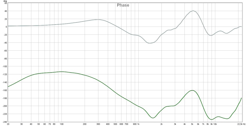

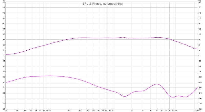

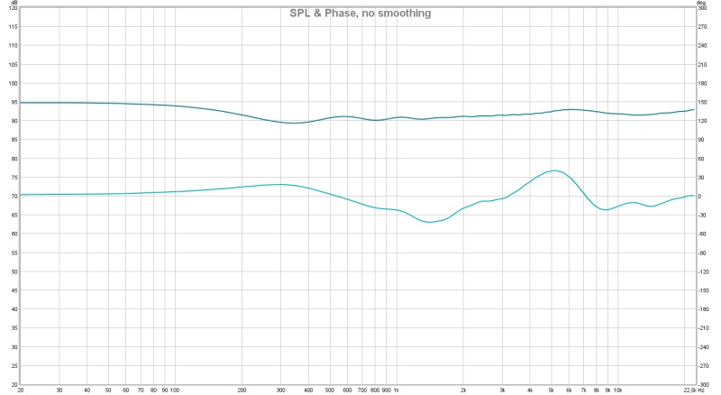

Let's try and bring this back on subject a bit. I stumbled over a couple of older files from Professor Edgar Choueiri, known for his BACCH 3D sound implementation.
These are older files, when he was still on the Ambiophonic route.
What was interesting in these files is the phase swings:
Direct sound IR
Cross talk IR (this one is inverted)
I haven't figured out why these phase swings are used in this case yet. As the right IR's look exactly the same as the left, but he swapped both IR pulses.
Here's the phase of both in one plot:
Professor Choueiri abandoned the Ambiophonic route shortly after and continued to pursue a more complicated algorithm but the targets he had in his early work are quite identical to "our shuffler".
A link to his later work is here: https://www.princeton.edu/3D3A/Publications/BACCHPaperV4d.pdf
