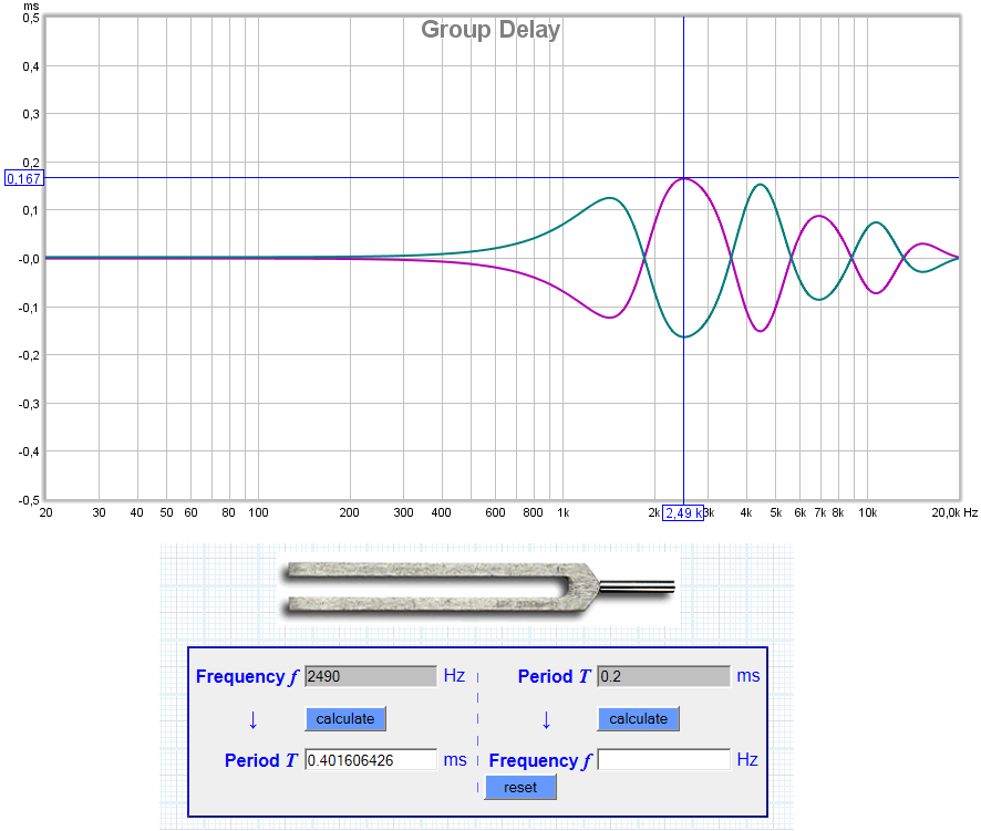

I think you are missing how the shuffler works. The original shuffler as proposed in the paper linked at the top of the thread uses short echoes that alternate in phase. That results in phase flips above about 900 Hz which prevent the comb filtering caused by the ears and head. If the signals are not in phase, they won't cancel when mixed.The basic shuffler, if I understand correctly, puts in a single (phase) delay, but that delay causes cancellations that we don't want. So what if we introduce a second delay that causes cancellations at different frequencies, and thereby fills in the cancellations of the first delay?
The second type of shuffler, as made in the rePhase software, shuffles phase only, there are no impulse echoes. The points at which the phase angles spread are chosen to correspond to the frequencies that comb and cancel in a typical stereo set up. The main frequency being about 1900 Hz. If the signals coming from the 2 speakers are not in phase at that frequency, they can not comb and cancel. This does not change the frequency response, summed or or separate. It simply prevents the comb filtering and corresponding dips and bumps in frequency response that comb filtering causes.

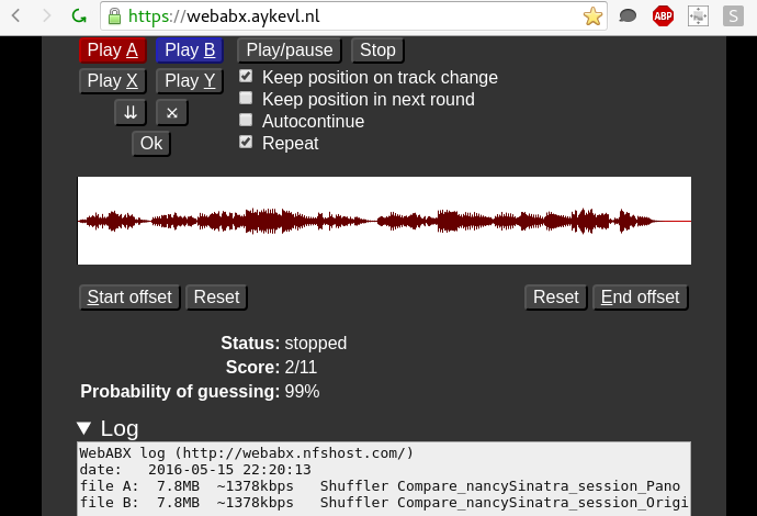

Just did a double blind test on https://webabx.aykevl.nl/ with the Nancy Sinatra vocal track (right channel only). Rephase-2 vs Original. I apparently could not tell them apart at all... 99% probability of guessing. Listening on a single Vifa TC9FD.
