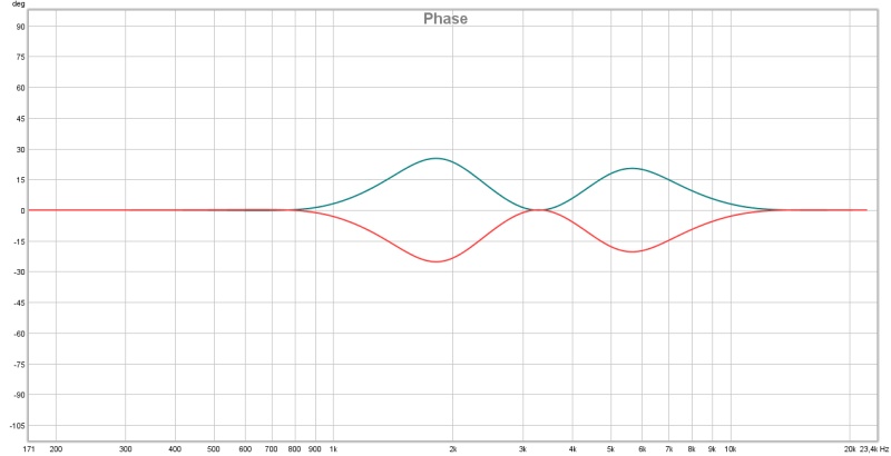

Like some others I may not understand in full detail what a shuffler does. Apparently it shifts phase at certain frequencies only (?), such that center image cancellations due to our 2 binaural ears, no longer cancel at those frequencies (?). So one channel is shifted by maybe +45 degrees, and the other is shifted by -45 degrees (?). Is the shift static, or does it ever periodically change, so the brain can't lock in on it's presence?
If you wanted to minimize the comb filter effect of L only and R only signals (when using a shuffler), the L-XR matrix working against the L+R function might give one the opportunity of affecting the center images significantly more than the outer L and R only images. You somewhat extract L+R away from everything else, process it with the shuffler, and then mix it back in with L-XR and R-XL, to get back to two channels. This method may have significant crosstalk issues, but may still be an improvement (?).

The phase is altered like in the picture I just edited in in the post above you (static phase change).
This phase change shifts one ear's comb null up in frequency and the other ear down.

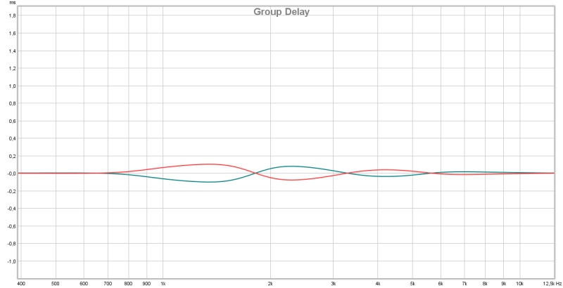

The real time change is minimal:
0,101 ms time change...
The left channel solo does not have a combing problem, nor does the right one (by itself) have it. The combing occurs because of the same material coming from both speakers. Yes, there is still crosstalk (to the right ear) with only a left channel playing. But we are not trying to solve that problem. No combing though. That only happens for the sounds that play simultaneously in both channels. The crosstalk signal of the left speaker (arriving at the right ear ~0.27 ms late) combs with the right direct sound and vice versa.
This shuffler is not fixing or altering anything panned hard left or hard right. No need for a separation of the treatment, unless your hearing picks up on a 0.1 ms timing difference. Calculate the distance of that to figure out how far we have "moved" the sound compared to the original by introducing this phase shuffle. It's minimal, 3.4643 cm according to an online calculator.
