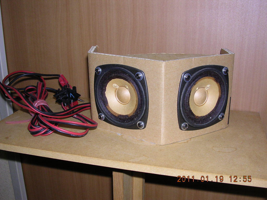

I do not think so. 3-ch array stereo (by array stereo I mean at least two playback sources spanning a distance) has the same issues as 2-ch, say loss of sync causing destructive interference, just starting one octave higher, as source-to-source distance has halved.
The barrier idea is an emulation of headphones playback.
The similarity between the barrier and headphone is lack of comb filtering. Everything else is different.
I read this approach before. Beam stereo speaker setup was popular at a time in 70' or 80' in Japan, but it quickly disappeared. Interesting idea, though.I have come to the conclusion that 2-ch stereo is a fine thing, if done rite. Rite means co-incident on both recording and playback, see my blog for details. This needs a new kind of loudspeaker, I call it the beam stereo loudspeaker, just one box for stereo reproduction.

Do you want to listen to music with a cushion or panel rite up your nose? While dancing, socializing, xxx? Even if you do, you do not get good stereophonics that way.
With a proper beam stereo loudspeaker, you have a) mono compatibility with a clean response of first wavefront anywhere within the room, and b) decent stereo effect anywhere within the room but most balanced and strong, when the listener is centered between side walls and backed off a good deal from the loudspeaker. The stereo effect, what you call "image", does not collapse when moving around. Just the contrary, sonic impression is more stable.
Those Japanese beam stereo loudspeakers are most imperfect. My prototype is better yet far from perfect.
hahaha, have you tried the barrier by yourself? I love it.
Anyway, those Japanese invention are probably not what you call Beam, they are Reverse-Olson. I like to hear more detailed explanation about your Beam idea.
