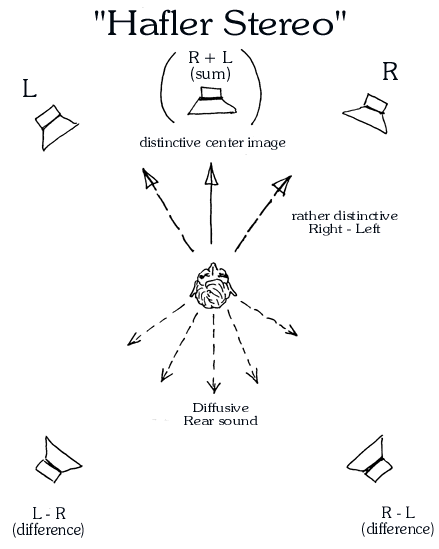

If back speaker can be used, there is another way to cancel out comb filter effect connecting rear speakers like this:
Amp L+ out to Back Speaker L+
AMP R- to Back Speaker R-
Back Speaker L+ to Back Speaker R+
Back Speaker L plays L-R, which should cancel out the Front R signal at the left ear, vice versa, at least theoretically. I read a report saying this method worked very well, so it could be a good solution as well. Please someone try it. Note: This type of connection could be harmful to the amplifier of certain output circuit.

That's the old surround trick, popular in the 70's was it? Don't do it with just any amp though, you might fry it. Even though I do use a similar signal (L+R) and (L-R) in my ambient setup, that alone does nothing for the phantom centre or cross talk cancelation. It's just a variation on Hafler Stereo.
You can do miles better than that by using a band passed, attenuated and properly delayed (L-R) and (R-L) signal. My specific interest went out to mixing in some centre, as a passive diffusion panel would reflect centre information too.

Another interesting read on that Hafler wiring: http://www.diymobileaudio.com/forum/system-design-help-me-choose-equipment-my-car/9806-rear-fill-do-you-use.html
