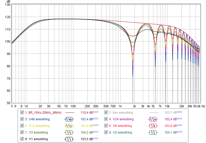

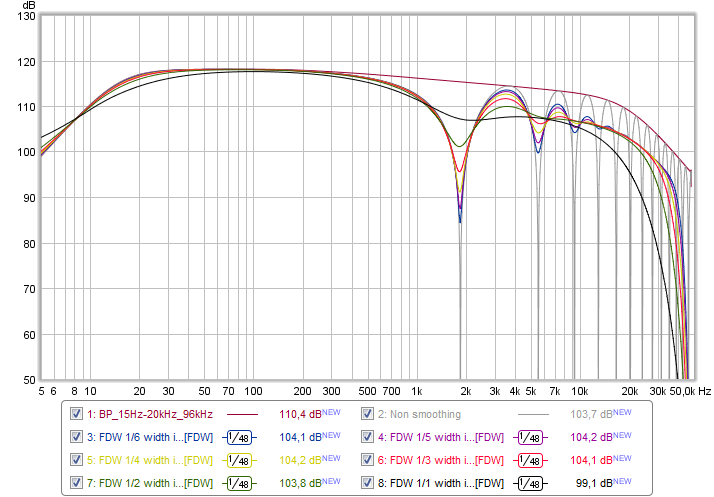

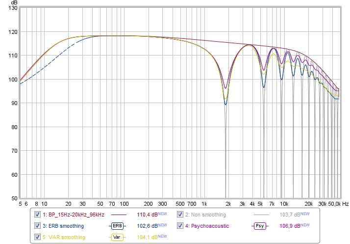

But the issue, to me, is not if its audible, of course it is. My point is that it is easily correctable in the original mix by the engineers. Do they all do this correction, I'm sure they don't. Do good ones make this correction, I'm equally sure that they do.
It's critical to understand this effect, Toole talked about it so we should all understand it. The question is "Who should 'correct' this problem?" To me it belongs in the recording studio, not in my playback setup.
I'm not fixing the effect it has on the phantom centre. In fact my EQ is close to a B&K curve or the Toole/Olive proposals. I'm only fixing the slight tonal imbalance I do notice in the side panned content compared to that centre.
Am I fixing the recording or fixing the positional differences in my room compared to what was heard in the studio?
All I know is side panned content sounds more real (more body to panned background vocals) and more consistent with the phantom voices. It doesn't take much. And it works for the majority of recordings I have tried as a sample set, consisting of a lot of different genres.
Introducing a diffuse, lateral arriving late return (15 to 20 ms after the initial impulse), lower in SPL and band passed, (Haas Kicker) makes it sound more 3D or holographic like and immersive*.
Not using the Haas kicker but instead the cross talk cancelation did get me the same 3D like imaging, but only in a small sweet spot and made me cramp up. Giving me head aches over a longer course.
