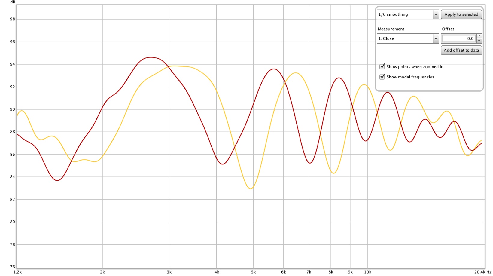

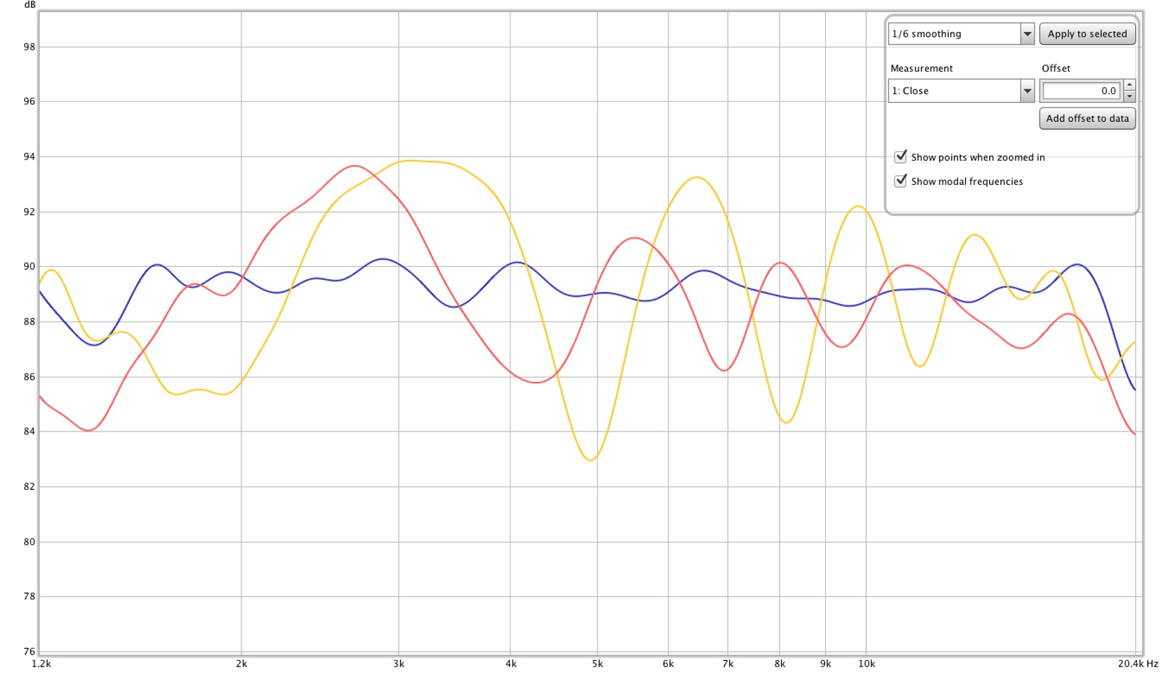

OK, I did casual measurement today. The result clearly shows this phenomenon.
Measured at listening position (Left ear)
Blue - Play Left Only
Yellow - Play Both side (stereo)
Red - Play both side with a small barrier (seat cushion) next to the mic.
Second chart is showing different mic position in dark red, both side playing. (5cm closer to the speaker).
I also measured with much larger barrier, and it is very close to the LEFT only chart (blue line) as expected, of course. My current conclusion is still the same as what I have been insisting;

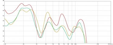

Perhaps I don't know what you are measuring or exactly how but your curves - even with an overly smoothed 1/6 - seem very odd to me.
So below is a chart made under crude circumstances showing L, R, and dual-mono, configured to resemble your post. I don't think there's any need for me to label the curves.
As you can see, the dual-mono curve remains neatly above the L and R for the most part. Except at one or two points: if a mic is a few inches closer to one side than the other or if the crossover is a tiny bit off, you'd get that interference but that is quite evanescent, changes inch by inch and note by note, depends on the room and proximity to walls, and has no meaning for stereo listening. And the L and R curves are surprisingly parallel, esp considering this is just my inexpensive vacation cottage loudspeakers somewhat haphazardly placed for spousal approval.

I see. 12dB curve is attached. The reason why I presented 1/6 is, just because it is clearly show this symptom, which looks close to the simulation on the computer.
I think your measurement is showing some other comb filter caused by the other reasons. WESAYSO and my speaker/room is rather flat when only one speaker is played at a time. I don't do any room correction, so not as good as WESAYSO, though.

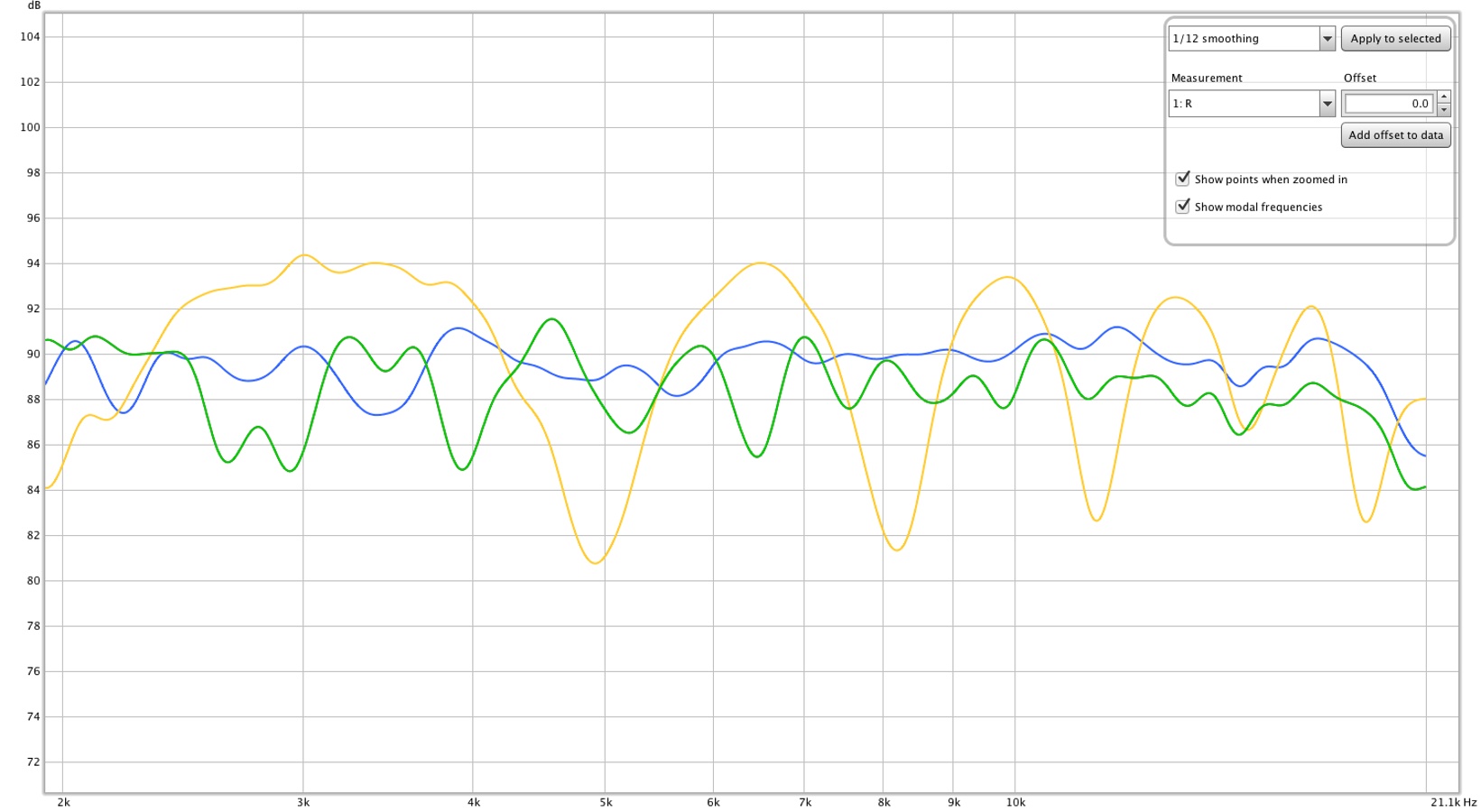

WESAYSO is offering M/S EQ and additional diffused signal, and it would be another solution, but I honestly do not understand his idea yet. I wish he would provide us measured result of his solution.
These dips we see in your measurements are real. I doubt Ben did his best to measure at an ear position like you obviously did so ignore those.
However, in a Stereo recording the vocal material is usually adjusted to account for these dips. At least for the most part. In one of the first pages there's another paper linked which tells you about the S-curve EQ. I suggest to read that and look at the provided info before I try and explain it all. My final mid/side EQ is nowhere near as strong as what they suggest, as mixing and mastering engineers aren't deaf (I hope) and will account for stuff like this in their mix.
But I did notice the effect Pano described in the first few posts. So I started with that S-curve and adjusted it in listening sessions.
The ambient mix I use is described in my thread: http://www.diyaudio.com/forums/full-range/242171-making-two-towers-25-driver-full-range-line-array-143.html#post4459831
This started as a simple Haas Kicker, but later on (due to some of the things we discussed here) transformed into a part of my working solution.
If you look at this post from jim1961: http://www.diyaudio.com/forums/multi-way/277519-fixing-stereo-phantom-center-61.html#post4746283
You can see where I got the idea for that. I have a virtual kicker, measurements of that in my thread, but added the ambience (reverb) later.
That's starting here: http://www.diyaudio.com/forums/full-range/242171-making-two-towers-25-driver-full-range-line-array-199.html#post4631144
This has gotten another sequel, as I now have the centre part of my ambient signal separated from the regular ambient material. My thread will be filled with these tests and theories, much more elaborate than anything I wrote here.

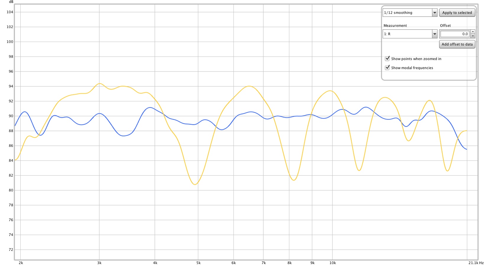

What Ben showed looks like this at my listening spot:
![midsidecenterSPL.jpg](https://www.rsr-concepts.com/diyma/midsidecenterSPL.jpg)
Oh wow, in the exact sweet spot both signals do sum together. Not a smoothed graph, just a 6 cycle frequency dependent window. I like to see what hit's my ears, not the room stuff, to determine what happens in those critical first milliseconds. Which is why I used the 6 cycle frequency dependent window.
To show that same measurement at 1/12 smoothing for left and right signal without any gating at all:
![1-12smoothingleftandright.jpg](https://www.rsr-concepts.com/diyma/1-12smoothingleftandright.jpg)
Posting this one just to show I'm not trying to hide or overly smooth my results. Absorbing the big reflections and EQ based on the ~6 cycle FDW makes the resulting graphs that much closer to that early wave front.

Thanks for that. It clearly shows combing, tho a little different from what we should see with a head in the way. Your barrier lessens the dip, as we would expect, but also shifts them.Blue - Play Left Only
Yep, I guess it is because the mic is not exactly positioned. It was a casual test and I placed the mic about 10cm left from the center of the room. The small barrier is causing diffraction, maybe. The Large barrier curve (1mx1m foam) looks much more perfect, but I erased the data by mistake...
