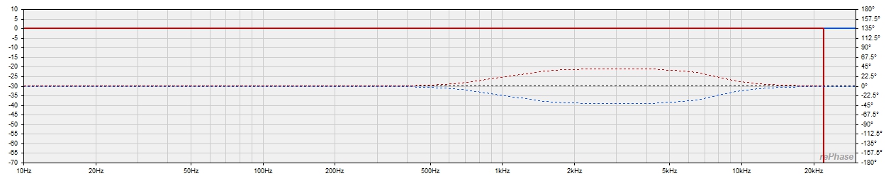

Another thing I've been listening to is the attached phase curve. It is a 45 deg delta between L and R from 1 kHz to about 6 kHz. I was trying to recreate what I'd heard in the earlier 'phasey' correction. Unlike the phase shuffler in Rephase, this keeps the phase delta flat through the 1-6 kHz region. I am finding that this has a positive influence on imaging. Wondering if someone else can try it and report back. You can make that in Rephase and then convolve that with the regular FIR correction (if you use one) using the sox fir command.

Just a reminder, the idea behind the phase shuffler or M/S EQ isn't to make a more stable phantom image, but to make a phantom center that has the same tonal balance as a single speaker playing alone.
If that results in a more stable phantom center, then it's a happy side effect.
