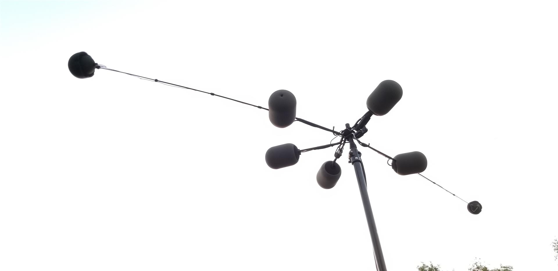

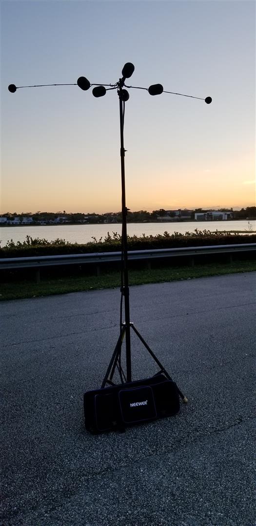

For the curious, my current recording array consists of 8 microphone channels, which can be thought of as consisting of the following logical pairs (it is a single array, exclusive of spot or close mics) :
● A wide-spaced omni pair
● A forward-facing center coincident Mid/Side pair
● A forward-facing near-spaced directional L/R pair (forming an L/C/R triplet with center Mid microphone)
● A rear-facing near-spaced directional Ls/Rs ambient/audience/room pair
In the images below the omnis are mounted in small spherical baffles at the end of the telescopic arms, the larger windscreens contain the directional microphones, the center of which contains two microphones (the Mid/Side pair). [edit- forward axis of the array in the photos below is toward the upper left)
I'm posting this simply to clarify where I'm coming from in the post above, not intending to derail into a discussion of recording, or this array in particular!
