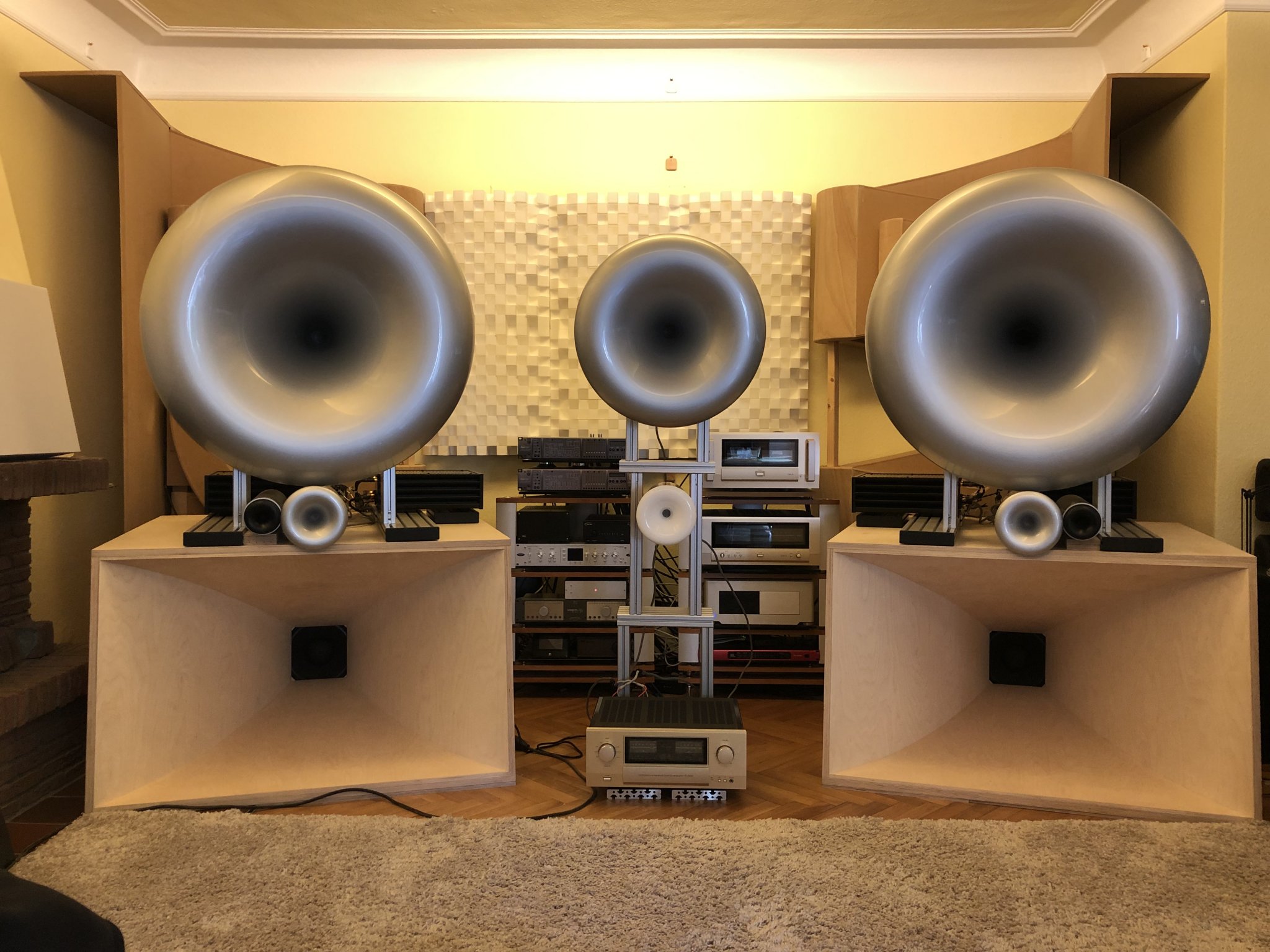

P.S.: Here is a picture of the impressive horn system. The quality seems to be very high with excellent measurements.
https://abload.de/image.php?img=img_2969tneog.jpg
Thanks for the photo, it looks like a very nice system. This leaves me rather puzzled, as just looking at the photo of the system I can't see why it should not present a strong and stable phantom image. FWIW, I have never, ever needed training on any system to hear a phantom image. If it's there, I hear it immediately.

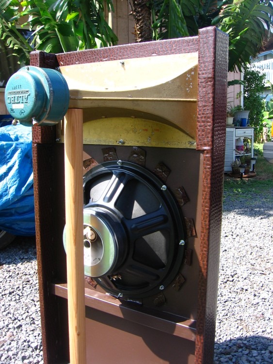

Years ago I had a pair of Altec Valencias, with a 31" Sanyo tube TV centered between. I had arranged the TV sound to come through the stereo. Some talking head was on and my friend remarked "Sounds like his voice is coming right off the picture". Those Altec horns would do that.I'm someone for whom the phantom center easily clicks
Yes they do! I think the Valencias had the 811 horns, right?

You`re completely correct. This system has excellent imaging as well in depth as in width even in stereo mode only and Lou Reed is IMHO perfectly localized. With the trinaural setup the imaging in all dimensions gets even better. We have tried different angles (factors) for the relation of output level of the outer stereo speakers/inner "trinaural" speakers and got very interesting results. All the measurements were taken with the software "Acourate" of Dr. Ulrich Brüggemann. I am the owner of the system.Maybe because the person in question was a visitor and therefore his hearing not trained to the system as much as the owner's hearing the whole situation might change after some time.

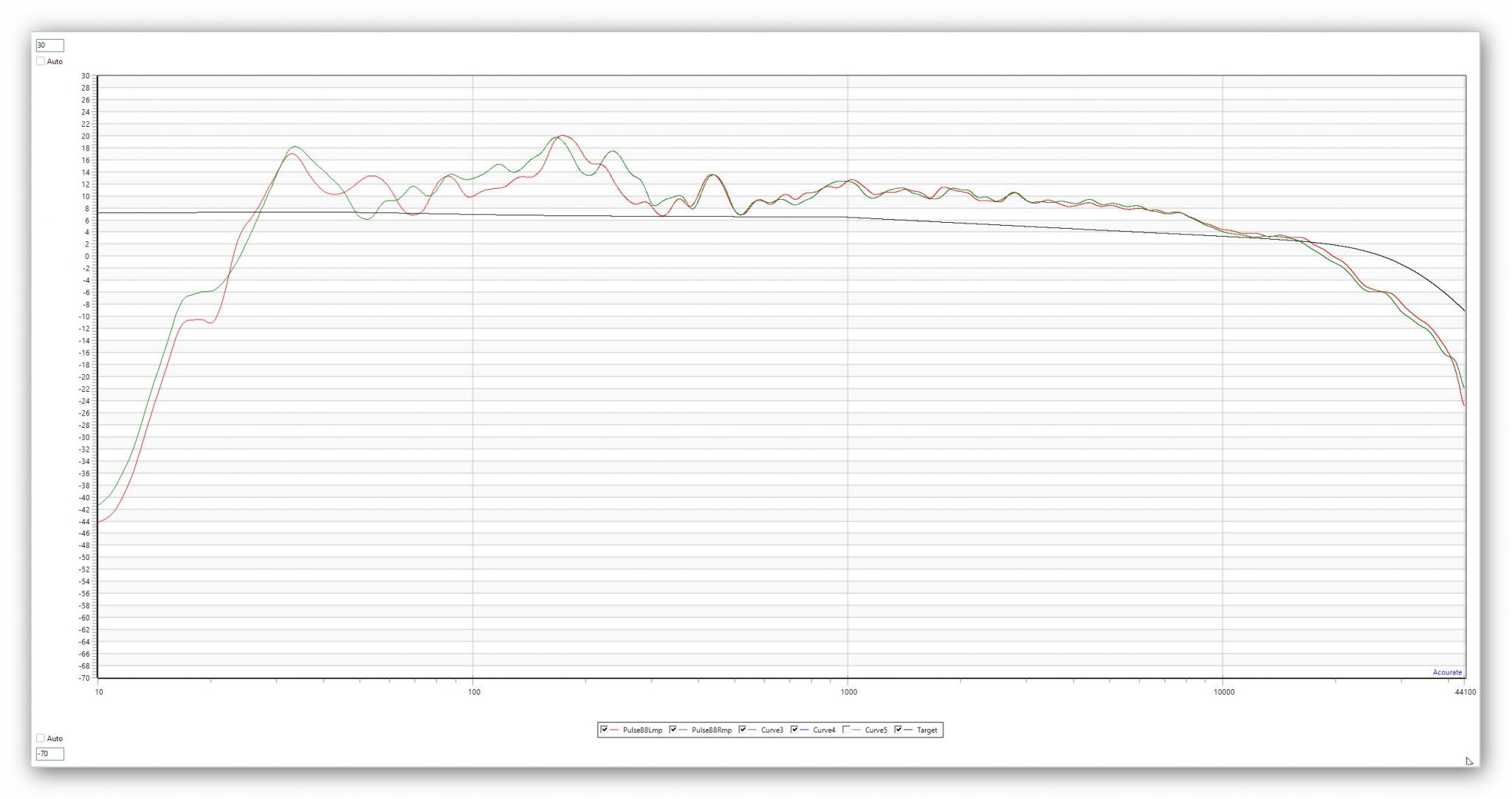

Uncorrected (pure) frequency response and target curve of 6-way-hornsystem 15 - 44100 Hz with ...jpg201.9 KB · Views: 124

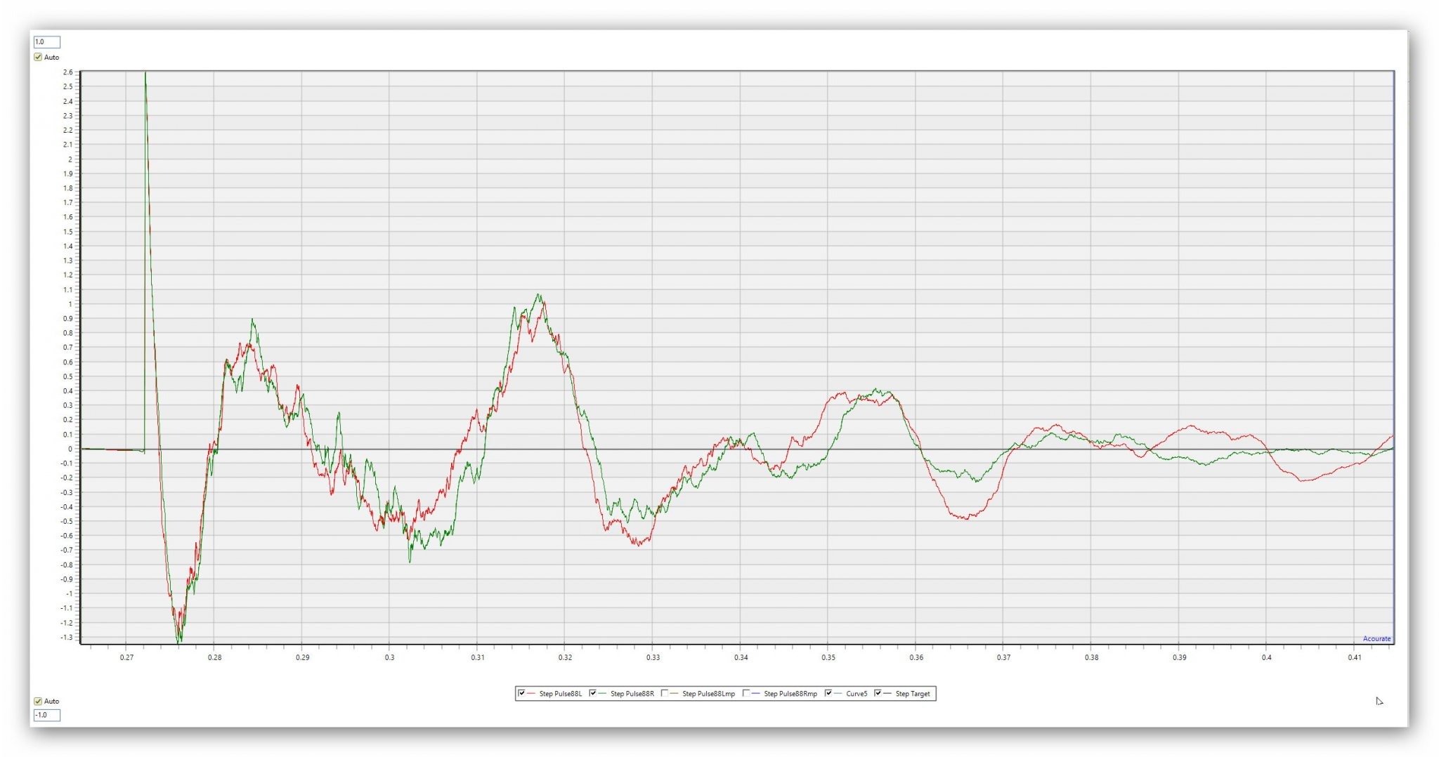

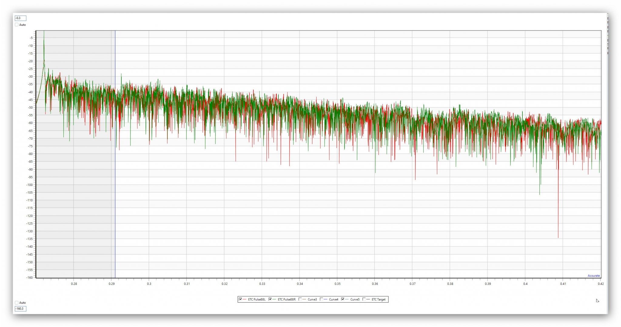

ETC first 150 ms (marked first 20,99 ms) 6-way-hornsystem with supplementing trinaural 2-way-h...jpg272 KB · Views: 119

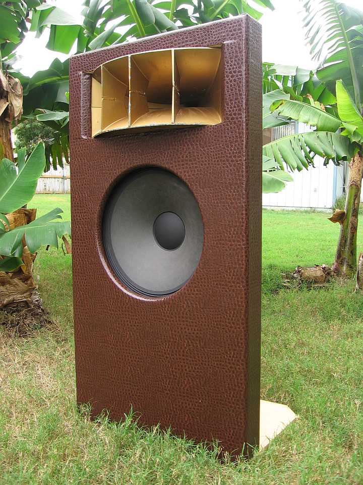

@mefistofelez That was a really nice Selenium 15" driver that isn't made any more. 🙁 It was the least expensive 15 from Selenium at the time, but was such a good OB woofer. Fairly low FS, Qts near 0.7 and it worked so well, sounded so good. Of course I don't remember the model number. Maybe 15W500
The 15W700 PRV woofer seems close to the same, but I have not seen it in person. One of my Seleniums got crushed when we were moving house, it was a sad day.
