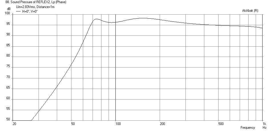

I then decided on convenient sizes to make it out of foam core with three Vifa TC9FD's. I settled on a 15 in tall x 15 in wide x 5 in deep box which turned out to be 12.3 liters. I designed a bass reflex port to give about 70 Hz extension. The port ended up being 4.5 in wide x 1.5 in tall x 5 in long. Here is the predicted response modeled with three drivers in parallel. In reality they are not parallel so efficiency will not be as high but response should be similar in shape.

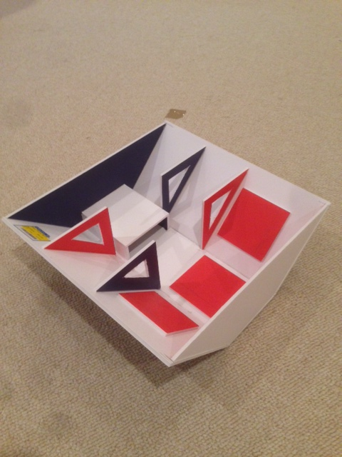

Here is the inside of the box built with orange and blue faced FC.

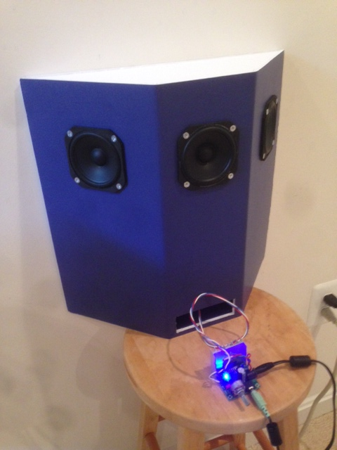

Here is the finished box driven by a TDA7297 chip amp. Note that a class D amp cannot be used in a matrix tied load.
It sounds really good and I am enjoying the sound and this is a simple enough project once you figure out the matrix wiring. I recommend it - a lot of fun and can be used in spaces where you can't have two speakers. There is clear stereo imaging as the sound reflects off the side walls and forms a phantom image. The 70 Hz tuning did the trick to give it just enough bass to sound good with many types of music.

I'm still playing with the values but using 5ohm and 4uF right now. The higher the cap value the less highs reach the front so that the sides do more of the imaging. I think I may need larger value. From Elias' website it was not clear how to size the caps and resistor.
I just switched to a bigger 45 w/ch class AB amp (Yamaha RX360) and it sounds much better. The small TDA7297 was clipping at high freq transients when wired in matrix mode. Not sure what was causing that but the bigger amp fixed the problem. Might be a problem with insufficient power supply rail cap. This setup seems to tax the amp because the chip amp was running pretty hot even at lower volumes.
