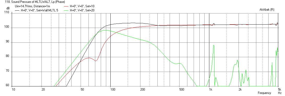

MA A7.3 Wall Mount "Pizza Box" speakers for HT
Here is a good candidate for foam core from another thread.
Can work with a CHR-70 also.
http://www.diyaudio.com/forums/full-range/260758-full-range-wall-home-theater.html#post4028642
Fullrange general listening use 4.0 in long vent (45 Hz extension):
HT use 1.0 in long vent and 120Hz -12dB/oct HPF for max SPL (80 Hz and 101dB):

![433781d1408377042-full-range-wall-home-theater-mltlwal7-plan-v1.png](https://www.diyaudio.com/forums/attachments/full-range/433781d1408377042-full-range-wall-home-theater-mltlwal7-plan-v1.png)
![433788d1408377613-full-range-wall-home-theater-mltlwal7-a7.3-freq-1m-fullrange.png](https://www.diyaudio.com/forums/attachments/full-range/433788d1408377613-full-range-wall-home-theater-mltlwal7-a7.3-freq-1m-fullrange.png)
![433782d1408377042-full-range-wall-home-theater-mltlwal7-a7.3-freq-1m.png](https://www.diyaudio.com/forums/attachments/full-range/433782d1408377042-full-range-wall-home-theater-mltlwal7-a7.3-freq-1m.png)

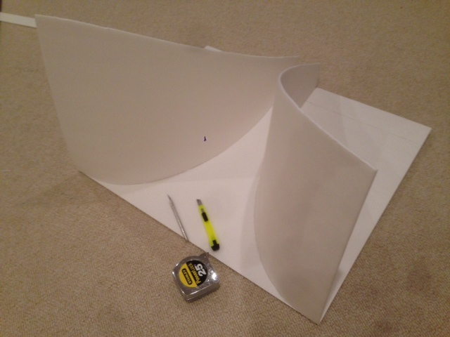

Tractrix for 5MR450NDY begins
http://www.diyaudio.com/forums/full-range/259293-prv-5mr450-ndy-fast-applications-10.html#post4033969
![434552d1408780712-prv-5mr450-ndy-fast-applications-tractrix-build-1.png](https://www.diyaudio.com/forums/attachments/full-range/434552d1408780712-prv-5mr450-ndy-fast-applications-tractrix-build-1.png)
![434553d1408780712-prv-5mr450-ndy-fast-applications-tractrix-build-2.png](https://www.diyaudio.com/forums/attachments/full-range/434553d1408780712-prv-5mr450-ndy-fast-applications-tractrix-build-2.png)
![434554d1408780712-prv-5mr450-ndy-fast-applications-tractrix-build-3.png](https://www.diyaudio.com/forums/attachments/full-range/434554d1408780712-prv-5mr450-ndy-fast-applications-tractrix-build-3.png)

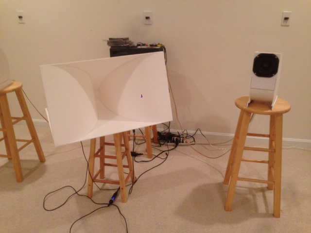

Finished the tractrix horn. It's a true 175Hz to 15kHz design with decent polars. More info here: http://www.diyaudio.com/forums/full-range/259293-prv-5mr450-ndy-fast-applications-10.html#post4034668
![434660d1408828567-prv-5mr450-ndy-fast-applications-tractrix-build-15.jpg](https://www.diyaudio.com/forums/attachments/full-range/434660d1408828567-prv-5mr450-ndy-fast-applications-tractrix-build-15.jpg)
What is needed to reach 20kHz? A different driver as this one is inherently limited to 15kHz open faced. It is a tradeoff with low end and high end. If you want 20kHz, not even a 2in dia CD will get there - you are in 1in CD territory. This is what Danley does in the Synergy. I am trying to do it with a fullrange driver so that the critical 500Hz to 5kHz is covered with a single driver. I am getting it well above 5kHz so I am happy with that.

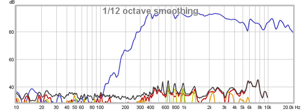

0.70x scale Tractrix with TC9FD
Latest tractrix horn build here: http://www.diyaudio.com/forums/full-range/259293-prv-5mr450-ndy-fast-applications-19.html#post4042589
Much more manageable 20in wide x 12in tall x 16in deep. Total cost $20 (driver, 4 sheets foam, binding post, caulking, glue sticks).
Don't forget to listen to the sound clips.
![435936d1409454689-prv-5mr450-ndy-fast-applications-0.7x-tractrix-1.jpg](https://www.diyaudio.com/forums/attachments/full-range/435936d1409454689-prv-5mr450-ndy-fast-applications-0.7x-tractrix-1.jpg)
![435940d1409454737-prv-5mr450-ndy-fast-applications-0.7x-tractrix-tc9fd-cld-325hz-hpf.png](https://www.diyaudio.com/forums/attachments/full-range/435940d1409454737-prv-5mr450-ndy-fast-applications-0.7x-tractrix-tc9fd-cld-325hz-hpf.png)
