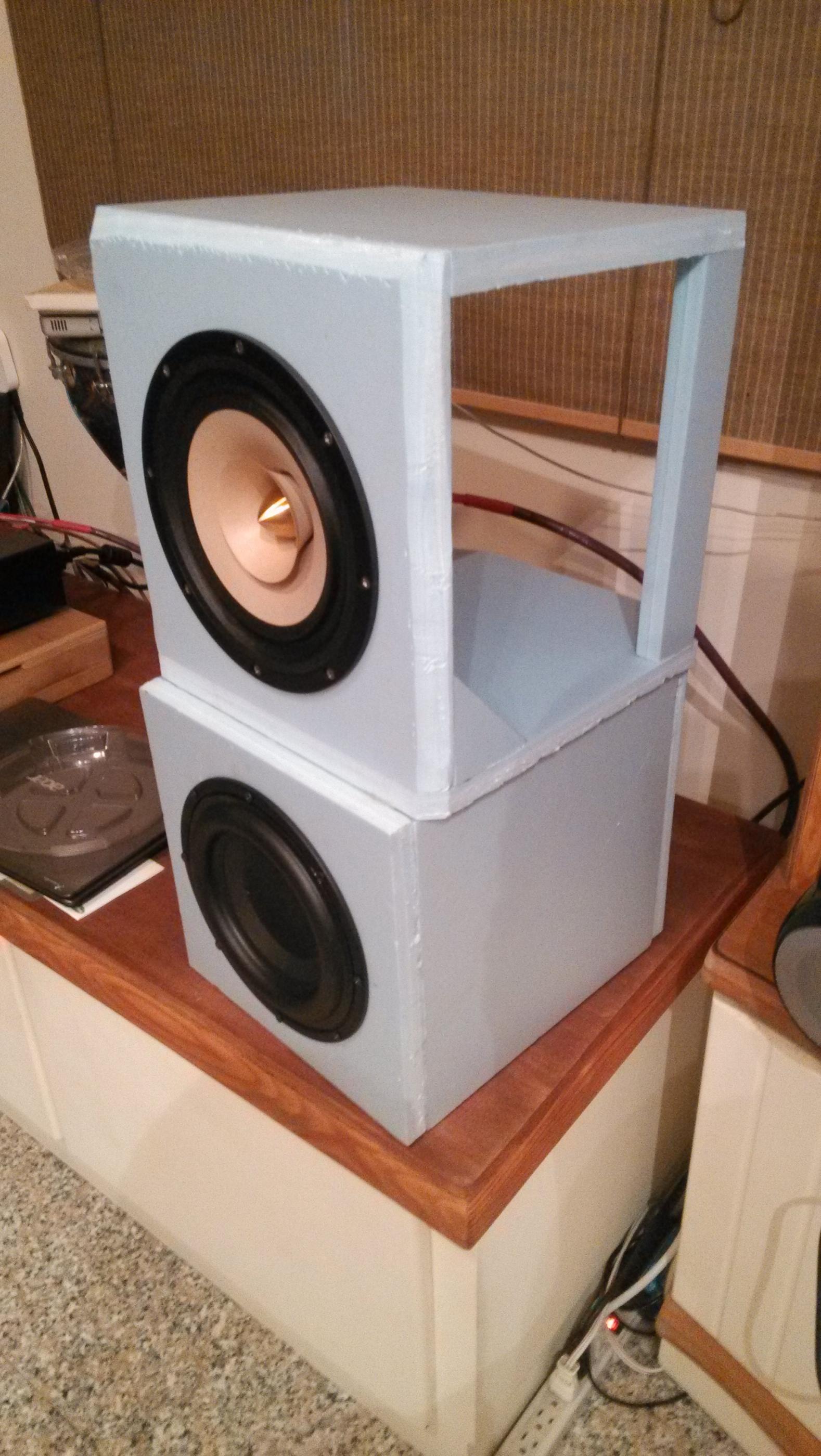

Long time no hear my friend. Good to have you back. I'm all for 3D printing too and use it extensively now in my speakers. Check this one out.
http://www.diyaudio.com/forums/multi-way/285030-bookshelf-multi-way-point-source-horn.html

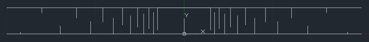

I've done a bit of searching and couldn't find much about a folded (stepped) circular horn. Has anyone ever done or heard of this? The simple implementation would have parallel front and rear baffles with circular, perpendicular internal dividers of specific height on each baffle that determine the horn cross section area and length. It might be easiest to visualize a spawn horn design, but not as large and with different dimensions, rotated around 360 degrees.
From a construction standpoint, the front and back halves could be built independently (making it easier to do with wood or foam core board) and then mechanically coupled together using dowels or other sections of material at various places in the horn path.
This design would make the cylindrical mouth area of the horn pi*d*h, where d is the outer circumference of the enclosure and h is the height between the inside of the front and rear baffle surface. For a 0.15m (5.9 in) depth folded circular horn with a diameter of 1m, the total mouth area is 0.47m, which corresponds to a cutoff frequency of 141.4Hz (according to MJK's horn physics documents) if you only consider the height between the front and rear baffles. However, if you place the enclosure flat against a wall it effectively extends the horn mouth and lowers the cutoff frequency.

The Dixielander design is rear firing but the concept appears to be similar. A CAD sketch of a potential cross section of what I mentioned is attached. The horn's mouth is side firing like the Cornu, and the mouth area is the entire diameter, but there are no internal spirals. The horn path has many 180 degree bends, which should help reduce any higher frequencies from getting out of the horn and make it easier to build. The only bad part about the design is that the driver is positioned dead center on a circular baffle which is the worst possible baffle shape and mounting position. That could possibly be cured by extending the compression chamber outward and mounting the driver away from the top baffle. You could then use a supra baffle of a better size/shape.
You could even include the cone at the back of the compression chamber like in the Dixieland design.
