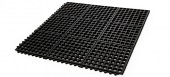

To sidestep any worry about solvents, one could use chunks of floormat / nonslip tiling, rather than something bitumin based.

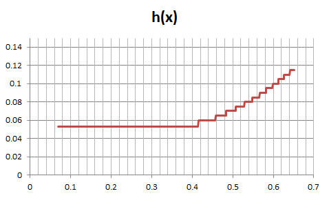

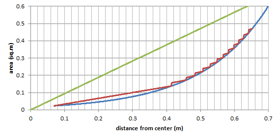

The attached excel chart shows the following as a function of distance from the center: cylindrical area between the baffles (green), ideal exponential area (blue), layered area (red). The other chart shows the stepped height (assuming 5mm layers) of the layers as a function of distance from the center.
You can see that the horn profile will fit well inside the entire cylindrical area, meaning it could be layered up from foam or sculpted out of solid foam. A layered construction also means there would be plenty of area above the throat and behind the front baffle to expand the coupling chamber if a larger volume is needed. OR a larger cylindrical volume could be used to bring the driver off of the circular baffle and reduce the diffraction. Still toying with that idea as well.

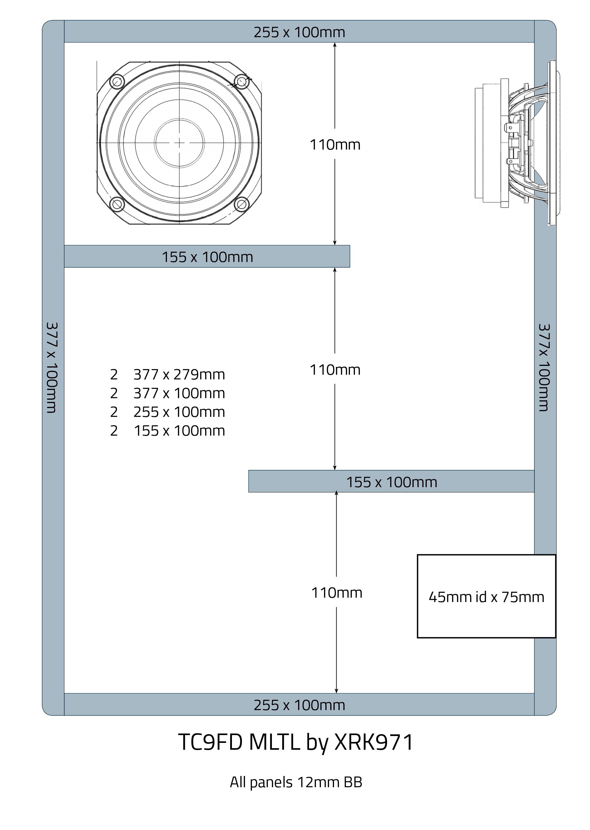

Hi XRK,
looking for a bookshelf enclosure for 1x TC9FD, I came across one of your designs. Being in Europe, I adapted dimensions to full millimeters. Would you be kind enough to take a look at it?
Poly felt is omitted on purpuse in the sketch, but will be applied according to your original drawing.
When having the speaker on the small side, will I need BSC?
Thanks in advance
Gerald
