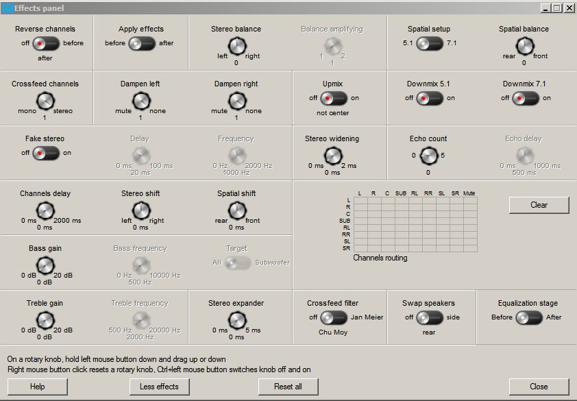

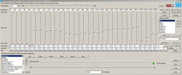

I agree with XRK and would suggest that since you will be using a PC to setup the miniDSP, why not go all the way and use the free APO Equalizer with the free "Peace" interface. I have a small windows laptop and a tablet that I use to run this easy to use graphic and parametric EQ with low and high shelf's, 31 bands that you can adjust or change the frequency's Q, 7 channels, each with there own equalization, many filters: The list is endless. Did I mention that is free and in 15 minutes you can start using it.
Or you could build even more amps.I play with passive XO's now because I like to build amps and single amps need passive XO's.
EQ APO can handle all of that, including running filters exported from REW & Rephase. For anyone with enough channels of reasonable-quality output, free software's an excellent to get your feet wet.Those are great features to have but first thing is to get the speaker frequency response flat and phase flat and step response a triangle. Then all the other stuff can begin.
