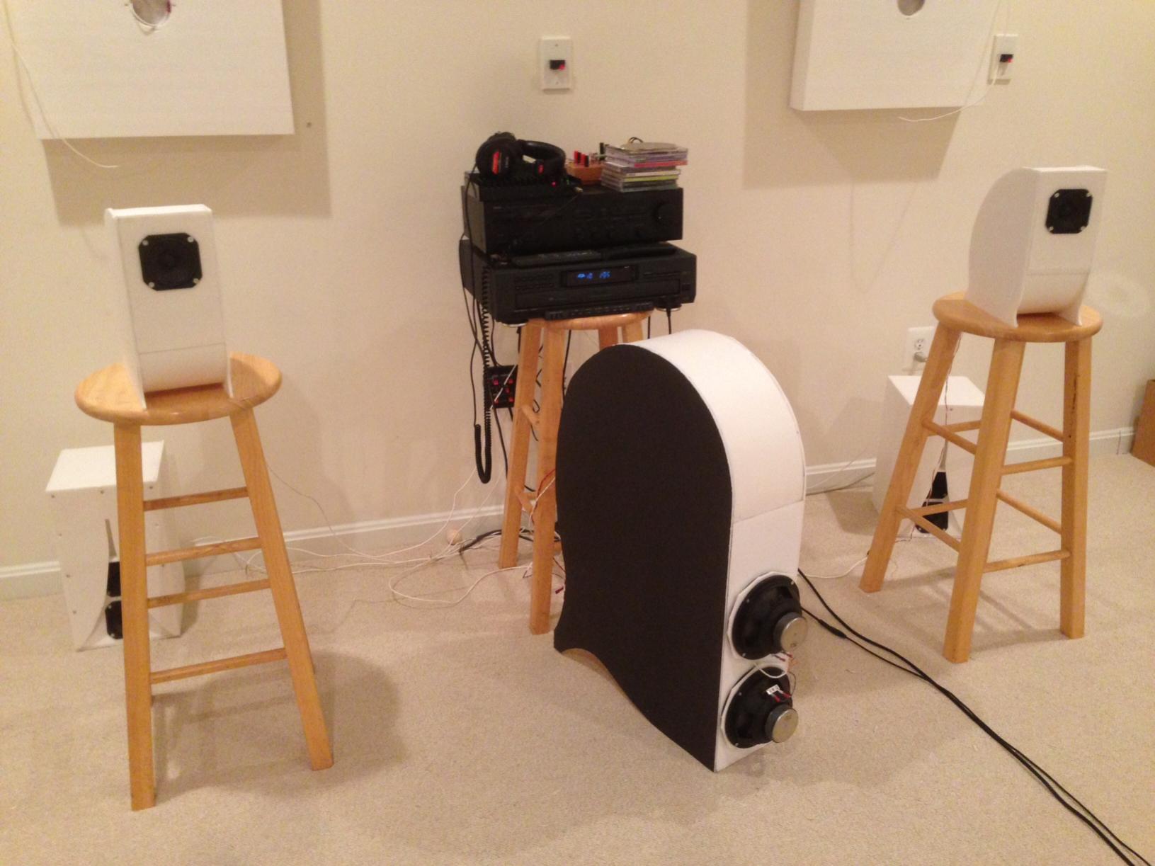

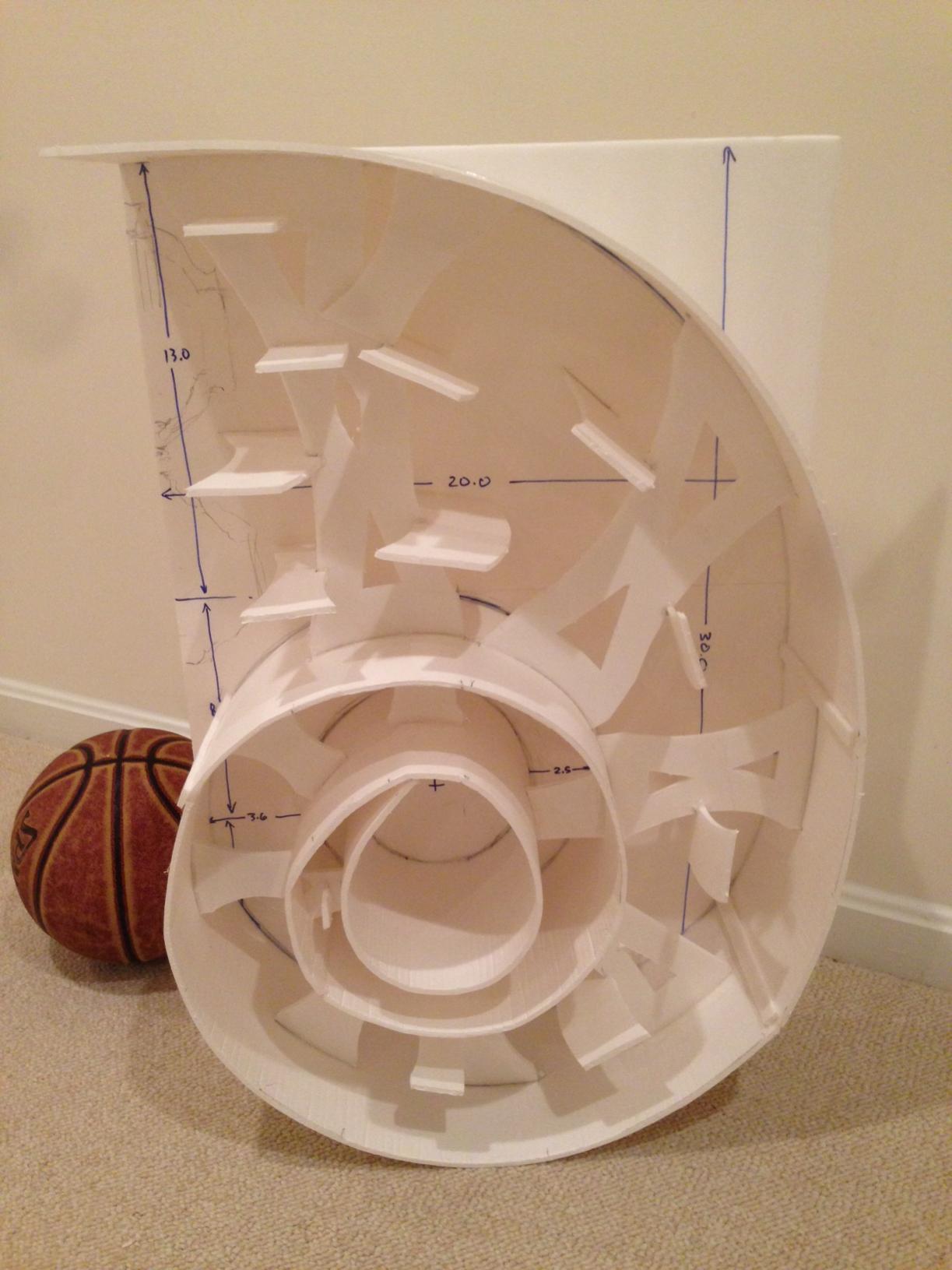

You can make it big. Here is a Nautiloss subwoofer with quad 6.5in drivers in isobaric mode.
Entire 20x30 sheet per side panel. Lots of bracing.

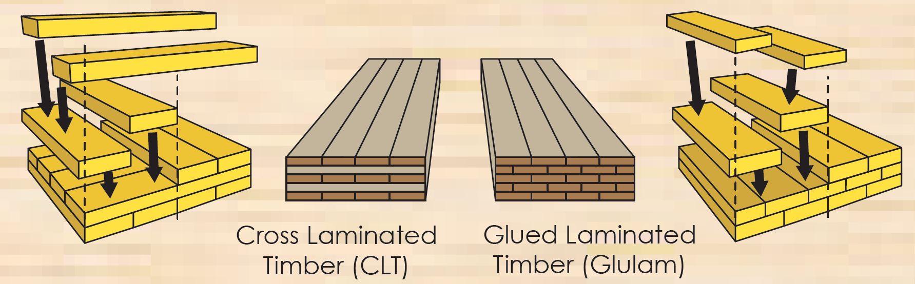

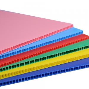

I've been kicking around ideas for making internal panels and bracing, that are formed of honeycombs or lattices. That is: strong-but-open structures. The openness of the structure would allow you to use lots and lots of bracing, without the bracing using up all the speaker's internal volume.
So... for larger foamcore cabs, maybe you could use corflute as bracing?
1) start with two big sheets of 5mm thick corflute
2) slice them into 50mm strips
3) laminate 10 strips together to get 50x50mm 'beams'.
Because each 'beam' would be mostly made of air, you build a dense matrix of braces with them, without greatly reducing the internal volume of the box.
If your cuts (step 2) were in different orientations, the corflute 'ribs' would be at 90 degrees to each other (cross laminated), for extra stability.

There's a foam core alternative, about the same thickness but made of plastic with a similar internal cell structure. I had some lying around so I built a cabinet out of it. It was not nearly as good as foam core.
For internal bracing it should work fine. But if I read your post right and you are thinking the openings would take up less space and let sound pass, that may be but in the case of my material, it needs to be oriented cross-wise for strength. So you'd need to "cross-laminate" as you suggest but then half of the opening is removed (at least with my material), substantially reducing the effectiveness.
I'd be interested to hear back if anyone uses that material.

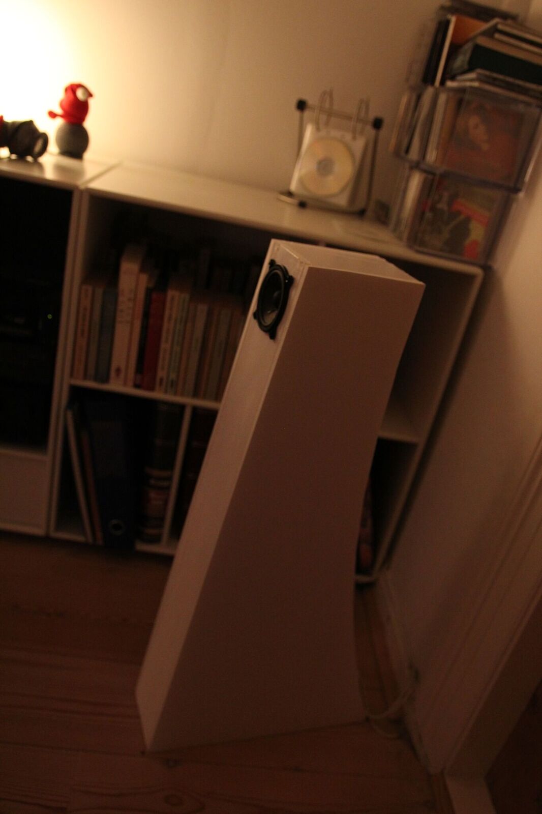

Here is a photo:
They are currently living at my parents house, but i spent some time with them recently, listening from a cheap class D amp (sure TDA3116-based) and they sounded great in the small room they now live in. They get a bit shouty when played very loud, but thats ok, i usually don't need excessive volume for my average listening.
With corflute, you could be a bit wasteful with material, and cut the 'beams' so that the ribs are at 45 degrees to the length of the 'beam'. You'd get the strength of perpendicular ribs, and no openings (volume) would be lost.
Silasmellor,
Is that a full size FH3 in XPS foam or a scaled down one with a 3FE23?
