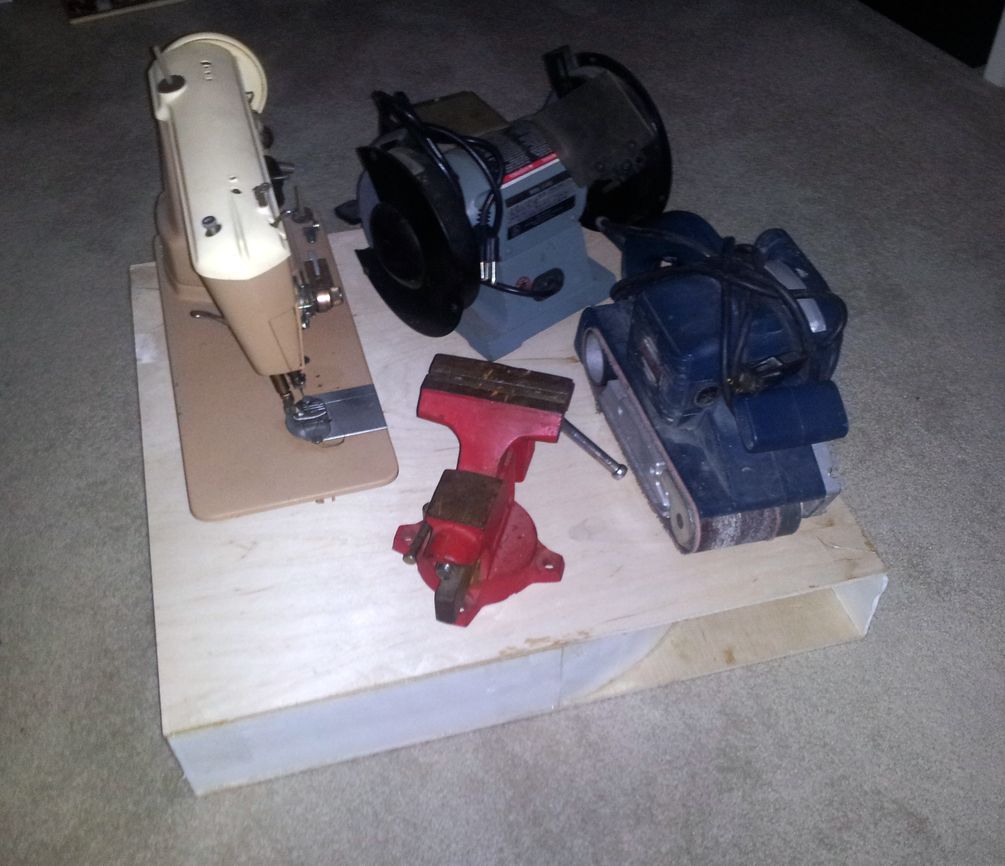

Hey Cal, the rig is definitely more than is necessary. I like it for a few reasons.
1. I loosened up several paper strips when using the table leg. This allows for no cross-friction.
2. Keeping the bottom edge of the strips flush to the board insures straight and better aligned vertical segments in the curve.
3. I like the flexibility of using various radius tubes. Almost like working with clay on a form.
My fourth concept dealt with insuring uniformity with a mark, but I prefer the ideas in the last few post much better. That's the magic of the forum - useful ideas start sprouting up all over the place.
The pic is "tools of the trade" literally. 🙄
Trying Gorilla on this one.

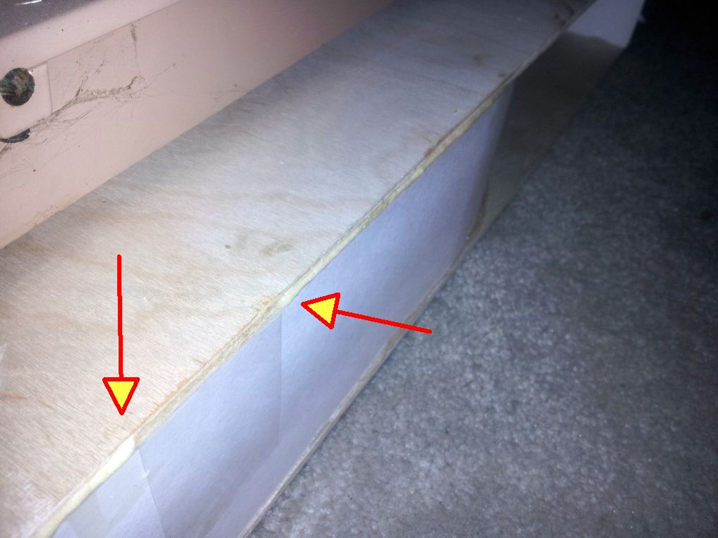

LoL 😀 a Sewing machine on top of the horn as a weight. Pretty funny. Great progress Bob. You are so close to making first sound. Let us know how the Gorilla glue works for the face.

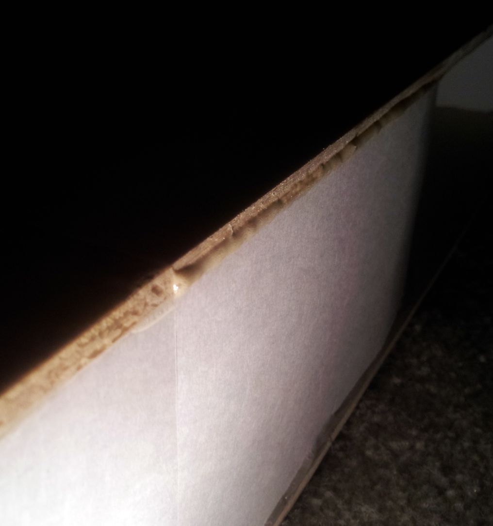

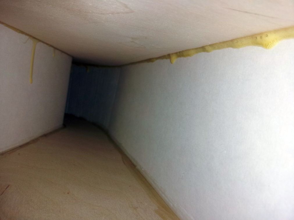

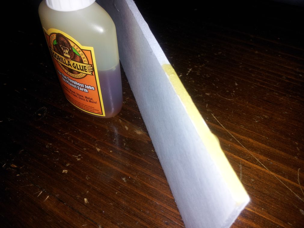

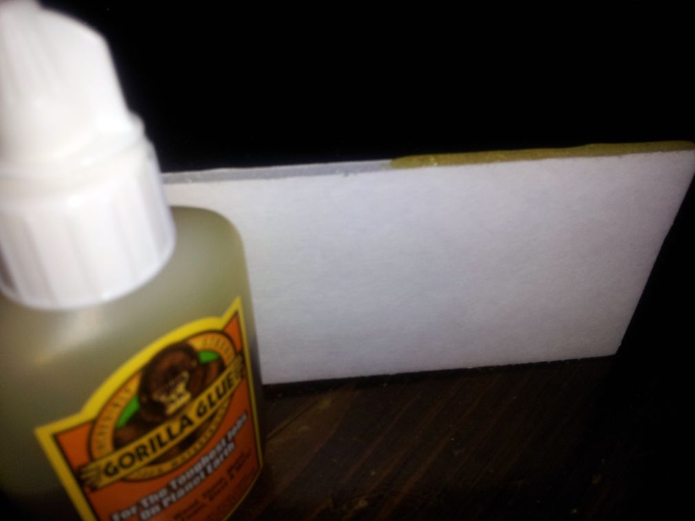

Here are some photos of the Gorilla glue action. It is actually a tad thinner than wood glue but holds it's form well. Some running can be seen, but that happened only after adding the weights.
The foaming shown is after about an hour. It might be a good idea to flip the build placing the glue on the bottom. That same packaging tape can be used to hold the cover in place while flipping. Looks like it will do a great job of "fill and seal". Will require some trimming on the outsides.

Bob,
Cochleus says the G glue dries in 20 minutes. You should be ok in a couple hours I would guess? 😉

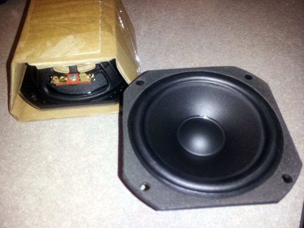

That's sweet that you have drivers in hand. Those things come in the cheapest packaging possible, you would not imagine something that sounds this good comes in such a skimpy piece of cardboard. Not even a full box. We are all waiting with great anticipation for your first sound. 🙂
