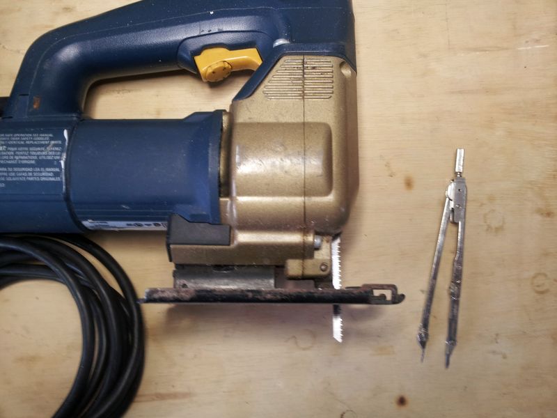

I actually preferred and used a thin saber-saw blade (scrolling size) and a compass on such a small hole. Just drill a hole the size of the blade then cut inside or directly on the line (slowly) and adjust fit with sandpaper or round file.

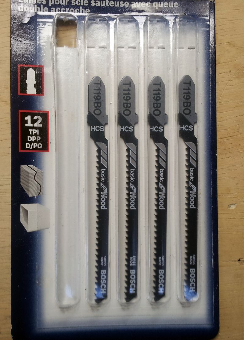

Jigsaw is how I plan to do it with plywood - got the blades the other day. There is much less of a chance for tool to take a wild path. But then moving up from using nothing more than a razor blade to make my enclosures up to this point is a big deal.
